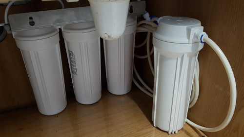

I am currently using Fiber Membrane POE system (pic attached) and it is time to replace the membrane that cost rm400. If I use FD, is it still necessary to have this POE?
FD is designed to work without any outdoor filter, so you will no need this membrane. First stage of FD is washable pleated polyester, so if you water is bad, just take it out and wash first stage. 2nd stage is also washable, just in case.

Yesterday's installation, granite countertop drilled. Good water pressure at condo. Many thanks to the customer who allowed to take photos, you have a lovely neat condo.
Notice long tubing, it's done on purpose, so that maintenance can be done without disconnecting the system. Just shut the water, release the pressure by opening faucet, take the system out, put it near the sink and wash/replace cartridges. No mess, no water spills. Will film a video after to address all concerns that "changing cartridges is difficult".
This post has been edited by hestati: May 31 2018, 07:22 PM

senscents
post Apr 7 2020, 06:05 PM
418 posts
Joined: May 2014
QUOTE(senscents @ Apr 6 2020, 02:59 PM)
WoW.. All it takes was just a word "Fake" and hell break loose. 🤣😃😂
Yeah, that was the first time washing the filter cartridges since new. Quite disappointed with the labelling. Luckily it was on the outside. 😂
Yes, the water filter is genuine with the relevant certification provided.
Any sifu can advise ?
How to achieve a better and or a longer lasting flow rate with out using an electric pump?
After washing the filter cartridges the flow are back to normal ~1,650L/min compare to before washing ~1,470L/min, but i can't be washing the filter every 6 weeks.
Of course i can prolong the washing to 3-4 months, by that time i presume the flow will drop quite significantly and it will be a longer waiting time to fill up the water for rinsing/soaking fruits and vege.
Thanks
QUOTE(hestati @ Apr 6 2020, 11:13 PM)
I measured mine for you now, but my cartridges (stage 1-2) will be 2 years old in May, stage 2 will be 1 year in May. Also I have 2in1 faucet which has lower diameter.
Tap - 6.3L/min
Filter - 3.3L/min
This is with old cartridges and I really turned down the inlet valve , otherwise water is splashed all over the place (very low sink). I am suspecting that your issue is not a flow, as far as I know your flow is super high, over 9L/min. Your issue is the pressure. You need some pressure to push water through cartridges faster, there is no way around it . Any reason why you do not want a pump? In your case, it would be perfect. Just even if you do get a pump, do not push over 6L/min through these cartridges
I do not have any power point near the sink, hence can't be using a water pump.
You have only 2 stages filtering?
Your filtering flow rate are very high (2× of mine) even thou the output from your tap are lower than mine(~8L/min).
What's your pressure like?
Maybe i need to buy a pressure gauge to check.
Does more nos. of filtering stages impeded the flow?
Is it possible that maybe the old inlet valve are not instal properly last time. The connection are using the same type as the drinking water faucet connection that uses a smaller plastic collar insert to the tubing.
What are the recommended flow for a standard 0.5micron carbon block?
TShestati
post Apr 7 2020, 07:08 PM
1,256 posts
Joined: Dec 2016
QUOTE(senscents @ Apr 7 2020, 06:05 PM)
Mine is actually 4 stages, since I have 1 filter in test, so it is carbon+Disruptor.
Can you do a very simple test? Disconnect the tube right after the inlet valve and measure the flow there, so meaning after the valve, but before any filters. Your tube is 3/8", so it should be relatively high. You will see that maybe inlet valve is broken, who knows.
My pressure here is roughly 52psi, at night it is higher at 55. But I have seen over 2L/min with pressure around 35-40 as well. When it drops below 30, then there are some troubles, but with 30psi you usually can't even take a shower
senscents
post Apr 7 2020, 10:46 PM
418 posts
Joined: May 2014
QUOTE(hestati @ Apr 7 2020, 07:08 PM)
Just test the flow, after the valve and before the 1st filter as you instructed.
The flow rate are the same as the sink tap ~8L/min. The pressure are quite high looking at the water shooting out from the hose when it was first turn on.
So, no problem with the inlet valve.
1) Does more nos. of filtering stages impeded the flow?
2) What are the recommended flow for a standard 0.5micron carbon block?
3) How to achieve a better and or a longer lasting flow rate with out using an electric pump?
Tried to upload the video of the flow but can't , stated server problems.
TShestati
post Apr 8 2020, 05:58 AM
1,256 posts
Joined: Dec 2016
QUOTE(senscents @ Apr 7 2020, 10:46 PM)
1) Yes, but not significantly
2) 3-4L per minute. It is capable of higher flows as well, but then chlorine reduction drops from 95%+ to lower values in 80s.
3) This is really strange. I thought you have low pressure, but from what you describe, your water is shooting out so pressure is not as low. At lest with brand new cartridges you were supposed to see 4L/min or higher, but you have low flow with 2nd system (so it is most probably not system related either), and not like slightly low but significantly lower than it is supposed to be. You need to troubleshoot and for this you need to upload the video, maybe to youtube and share link here. Film your whole system and then show the flow from the main faucet and from the valve. Try to block the flow with your finger (can estimate pressure this way). Then I will film mine in comparison.
You see what I mean? If you were initially getting 4L+ and then few weeks later 1.5L we could also say it is something in your water, but you get very low flow out of the gate, so we gotta troubleshoot it

senscents
post May 29 2020, 10:40 PM
418 posts
Joined: May 2014
QUOTE(hestati @ Apr 28 2020, 09:07 PM)
We are working this MCO period. We can also do installations IF your condo management allows
It's has been app 8 weeks after the 1st cleaning of the prefilter and the flow are getting slower ~1,200L/min compare when it's new ~1,650L/min. It's about 25% lower flow rate for ~14weeks usage.
After cleaning the both prefilter (5m & 1m) and the disruptor, the flow are weaker (~1.33L/min) compare to the first cleaning.
I foresee that in the following 3 or 4 months the flow will be going down again.
Please advise on improving the flow.Thanks
TShestati
post May 30 2020, 02:18 AM
1,256 posts
Joined: Dec 2016
QUOTE(senscents @ May 29 2020, 10:40 PM)
Hi, we have already discussed it couple of times. Issue is not with a filter, since you had exact same issue with Aquasana. Your water tap flow is superb at 8L/min, yet your flow with brand new cartridges is extremely low of less than 2L/min. There is either absolutely no pressure in your system (flow does not equal pressure), or there is some issue with components like inlet valve, tubes or other leftovers of previous system You can either try to troubleshoot yourself by checking which component causes it or we can send a technician (he will charge for the visit though, since you did DIY installation). However, if the issue is with complete lack of pressure, then only solution is the pump. However, it is highly unlikely that your pressure is so low. Disruptor is able to easily give 2L+ in places with 30psi. Below 30psi it is difficult to even take a shower.
Also, please note you are trying to measure ml, that can vary from day, time etc. The magnitude of the problem is not that it went from 1.6 to 1.3, this is arbitrary. The real issue is that it should not be less than 2L/min in the first place.

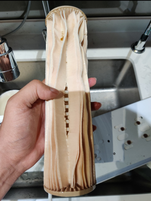

TShestati
post May 30 2020, 05:42 AM
1,256 posts
Joined: Dec 2016
QUOTE(senscents @ May 30 2020, 04:22 AM)
Thanks for your advise.
Good to know that even with an 14months old Disruptor still be able to have ~1.70L/min even with a slower flow of 5L/min.
Yes, i've thought about the flow/pressure might vary form different time/day.
Maybe i've a lower pressure but now let just put the thought behind.
First let me be specific on the matter.
I'm not asking for a super flow of 3, 4 or any higher rate of flow.
I'm quite happy with the flow of ~1.70L/min, of course if it can be better the merrier.
What i would like to achieve is that the flow rate will still be acceptable tolerance of 10 -15% at the end of life. By your opinion, can it be possible?
Even with frequent washing ~7weeks once, the flow are getting lower.
Hope you can help/advise on how to achieve a constant flow with lesser washing at the end of life.
Oh, I see what you mean. Your water seems to be quite dirty. Not the worst I've seen, but there is definitely lots of iron, therefore rust on the cartridges. Any cartridges get less flow as they get dirty, that is normal. However, there are 2 factors here:
1) When you have a flow of say 4L/min and drop to 3.5L/min it is hardly noticeable. Of course when you have 1.7 and then drop to say 1.2, this is more significant. In other words, you are already on a low flow and now it is getting lower, it's frustrating, even though the drop is the same in terms of ml/min
2) Unfortunately the drop in flow is not linear. I know you think of it in terms of %, saying if 4L dropped to 3.6L, it is 10% loss, so 1.7 should also drop 10% to 1.53. It should be like that in theory, but in real life it is not. Losses at lower flow/pressure are much higher.
What is the regular tap flow nowadays, still 8L/min? I would suggest to try and troubleshoot it once again. The simplest way I can think of is to remove ALL the cartridges and checking the flow. If the issue is low pressure in your system, then without cartridges you see significantly better flow. If, however, there is only slight improvement, then the problem is with some connectors somewhere. I am wondering if there could be some teflon tape partially blocking some fitting... Must be something very simple that we can't see. I understand that you are happy with 1.7 flow and want to keep it this way. But, if I could come up with analogy, it is like if we have a hole in the petrol tank, but trying to keep fuel consumption low by tuning the engine. Hope we can find a solution together!
senscents
post May 30 2020, 03:44 PM
418 posts
Joined: May 2014
QUOTE(hestati @ May 30 2020, 05:42 AM)
As i'm in a old housing area(>15years) the piping are mostly clogged with a poor water flow and dirty water, so can't expect much of a high pressure/flow.
The flow rate might fluctuate from ~6.5- 8L/min, definitely not more than 8L/min.
Will try to test the flow with out all the cartridges just to measure the flow rate. That will be another weeks as i've just clean it last week.
1) Can you supply a better 1m pre-filter with more  surface media? As more surface media will prolong the clogging and in return a better flow rate in a longer time.
2) Can a parallel pre-filter helps with the clogging and prolong the flow rate?
If this two methods help, it will definitely slow down the degradation of flow by ~50%.
TShestati
post May 31 2020, 06:59 PM
1,256 posts
Joined: Dec 2016
QUOTE(senscents @ May 30 2020, 03:44 PM)
1) Harmsco makes one of the best pleated polyester filter out there. If you need more surface area you will have to go 10"BB, but you will experience more pressure drop with it most probably. And that will not be cheap. Other option is not to use 1 micron, but rather choose 5-10 micron.
2) It will help, but it will not reduce degradation by 50%, maybe 20-30, hard to tell.
But with 6-8L/min of tap flow, you should still have ~2L/min flow from the filter. Let's see what the test without cartridges shows.
Yes, no doubt that Harmsco and others US manufacturer has a good pleated filter. Do you intend to bring in a better/more media surface for 2.5 X 10 X 1M?
As per my test, the pre-filter flow drop ~10%.
If by using a better/more surface media, it will by most drop another ~5 - 10%. In return it will has an extra ~ 50% filtration capacity in which will help to slow down the degradation of flow.
Couple with parallel pre-filter consist of 2nos 1micron(more surface media), i think it would help to improve my water flow rate. Even a 10% - 20% would be a big help.
That's my logic. Workable or not need your expert opinion.

QUOTE(senscents @ Jun 11 2020, 03:49 PM)
Problem is there is no better ones. There is not 1 with better flow.
Just today I was able to do the measurements. Time to fill 1L of water, 2in1 faucet, cartridges over 1 year old. Please ignore my last measurements, they were faulty, since I partially closed the inlet valve (carbon in old, I wanted slower flow through them) and I forgot about it.
Tap water: 12s/L
Disruptor: 18s/L
Disruptor without cartridges:16s/L
Which translates to:
Tap water: 5L/min
Disruptor: 3.3L/min
Disruptor without cartridges: 3.75L/min
As you can see, cartridges, even when old, contribute to minor drop in flow, 10%
There must be something wrong with your setup. Maybe the faucet is not installed properly, or something else. Unfortunately, since our installer did not do the installation, I can't really say what it is from distance. There must be something obvious, since drop is huge. Tube bent somewhere?
At this point the easiest would be probably to get our technician to take a look at it and isolate the problem or at least come up with a solution. Since he is also our assembler, he will inspect Disruptor itself. If the issue is with the filter itself and not the connection (let's say assembled wrongly, even though every system is tested once assembled), the visit will be free of charge. Would that work for you?
This post has been edited by hestati: Jun 11 2020, 05:42 PM

QUOTE(hestati @ Jun 11 2020, 05:29 PM)
Tap water: 12s/L
Disruptor: 18s/L
Tap water: 5L/min
Disruptor: 3.3L/min
Thank you for your kind offer of inspecting the filter system. Appreciate your offer and outstanding customer service.
Will take a rain check on this, as time are not right.
Our housing area are still enforcing no visitor regulation on this RMCO period.
Anyway, I've just Re-clean again the pre-filter and disruptor last evening.
This time i jet spray with my thumb against the tap outlet pipe instead of running the water like your video.
Now, viola,, it ~1.68L/min. Yeah,,  i know it's still not as high as expected but still it's manageable.
Hope i do not damage the cartridges. 😂
This will last me for another 6 - 8 weeks and the cycle repeat again.

QUOTE(senscents @ Jun 12 2020, 10:42 PM)
Thanks for your kind words. You did not damage the cartridges, but if you open it every 6 weeks, I can't say what will happen with o-rings, but should be ok probably.
Anyway, I recommend you continue to troubleshoot it. Next time when you open it, please send me a photo of the head from the inside. Also, try to connect faucet to water inlet directly, bypassing the disruptor. How confident are you that faucet is not an issue (just a question, not trying to say you did not connect it well).

QUOTE(hestati @ Jun 12 2020, 10:51 PM)
Do i need to apply any lube to the o-ring and treads since i need to service it regularly.
Good advise, will check on the faucet on the next available time. Even thou the connection/installation of the faucet seems simple, need to rule out every possible problems.
What do you mean by "bypassing the disruptor"?
1) Do i need to disassemble the 3nos of housing ? For this method, i do not have the individual connections to install back individually.
2) Just take out the Disruptor and Carbon's cartridges from the housing to check on the flow on the faucet.
As i've re-cleaned the filter couple of times, i'll not need the label. Simple as ABC. Anyway, thanks for the offer.

post Aug 18 2020, 08:16 PM
418 posts
Joined: May 2014
Great & Excellent customer service.
Now our flow rate are good. From the previous of <1.95L/min to ~2.7L/min.
That's a whopping ~40% increase of flow rate.
Thank to Ervin for the meticulous checking of the filter system which takes a few hard working hours for him to increase the ~40% of the flow rate.
The increment of 40% might not seems much for some one but for us it's sure a big factor.
Once again would like to give a thumb up 👍 to Hestati & his humble & polite technical Ervin for their assistance in this. Kudos.

WhitE LighteR
post Apr 8 2021, 11:40 PM
WhitE LighteR Is Black~
10,340 posts
QUOTE(hestati @ Apr 8 2021, 11:07 PM)
Yep, still 300 for LYN members. We are getting new batch of cartridges, would you be able to wait about 2 weeks or so? We now have an option for stage 1 iron removal. Can you send a photo of your stage 1 please?
P.S. possible to get 300RM price from Shopee through "make an offer"
Tear in my stage 1 media. The media has become like a mush of wet paper.
My stage 2 have no damage. Stage 3 is time for a replacement.
I also did a clean up on my PoE. Seems to be ok. No damage in the filter yet.
Since I believe stage 1 is a pre filter that the PoE already handle anyway, 2 weeks should be ok for me.
Will u be selling 20" PoE replacement filter that can handle iron too?
TShestati
post Apr 10 2021, 01:48 AM
1,256 posts
Joined: Dec 2016
QUOTE(WhitE LighteR @ Apr 8 2021, 11:40 PM)
I would say change all 3. 3 years you are really pushing it, it is disintegrating already. But your stage 1 looks really clean! I will PM you as soon as we get the cartridges. I hope end of next week, fingers crossed
