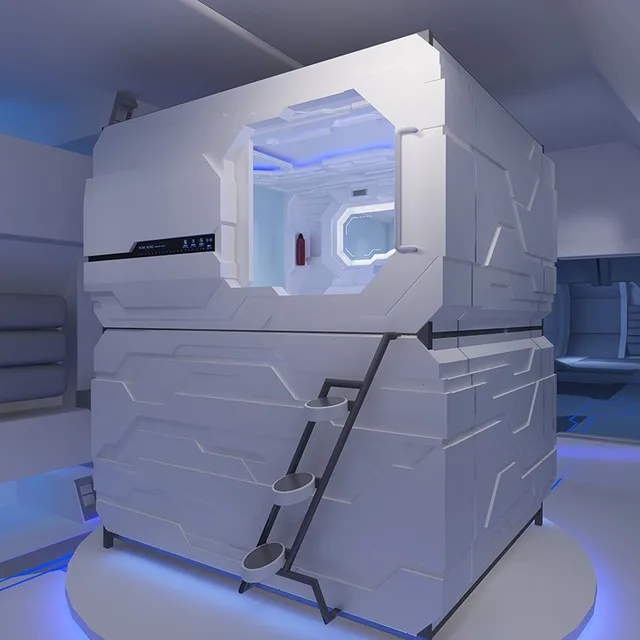

Instead of soundproof whole room...che@per solution is to create DIY soundproof pods for sleep or work....
Need at least 20cm thick fully sealed enclosure with suitable plywood
Or fibreglass capsule soundproof capsule

QUOTE(Mikethebodo @ Jul 14 2017, 09:05 AM)
sounds like good idea. But I think people will charge a bomb for this one.
Fiberglass one is made in China....below usd10k each with everything installed such as LED, air vents, safety lock
Plywood version can really DIY. Just need to pick the correct type of wood
