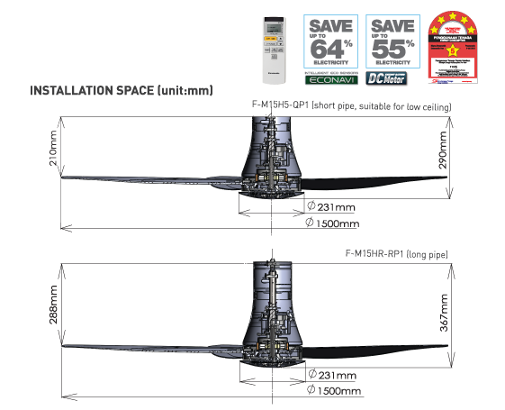

It is. They are also called baby fans for having short blade and short necks made specifically to suit low ceilings. Other brands may carry the same type.

get these, there's a few types from panasonic/kdk thats suitable for low ceiling
[URL= http://www.panasonic.com/my/consumer/home-...an/f-m15h5.html]F-M15H[/URL]
F-M15E
F-M14E

Baby fans like the Panasonic are 25cm from ceiling to pcb board cover.

Anyway, 9 - 9.5 ft ceiling can still install ceiling fan. If you're still worried, then go for the short pipe version.

u can try kdk baby fans series
there is one without hook, it is about 250mm height
