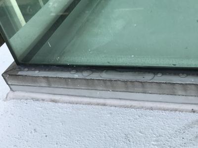

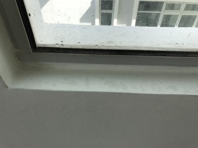

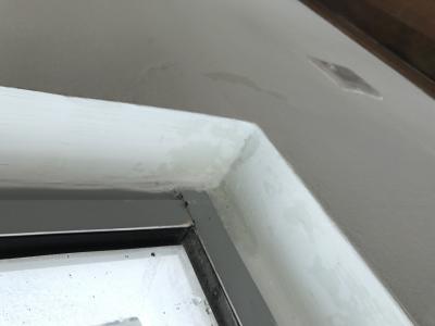

TSechoesian
post Jun 26 2017, 10:09 AM
3,294 posts
Joined: Dec 2005
QUOTE(weikee @ Jun 26 2017, 10:01 AM)
How is externally look like? Have to see outside. Sometime water slip in from the aluminium, rubber and also from the base like "halcyon27" mentioned the base not angle properly.
This is a top angle from one of the window
Bottom side

weikee
post Jun 26 2017, 03:22 PM
10k Club
12,019 posts
QUOTE(echoesian @ Jun 26 2017, 10:09 AM)
Bottom side
If the wall-aluminium frame already properly seal, next possible is the rubber seal or the aluminum L join, and to proper apply silicon sealer have to remove the old sealer before apply. Is better to have one single piece rubber.
