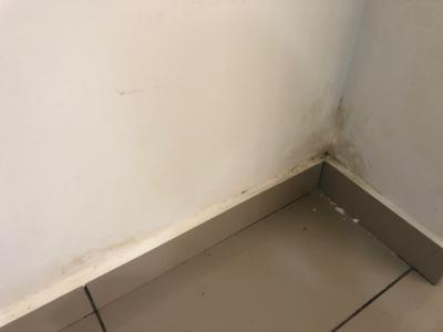

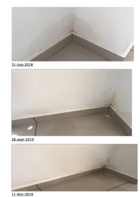

1.Living Hall Column @ Corner
Internal Water Leak since july 2019 & Wet Mold
(Bad Workmanship : Drainage damage pipe and/or no Bathroom Waterproofing
31-July.2018
28.sept-2019
11.Nov-2019

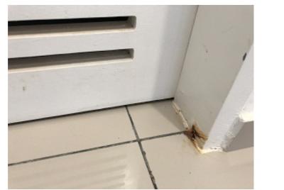

2.Main Entrance Door @ Frame (bottom)
‘Damaged’ Defective Material Door Frame & Rust / Corrosion Formation since day of VP. multiple request to replace a new ‘galvanized’ door but refused / ignored.
Attached Image Attached Image

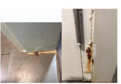

3.Store Room Door @ Frame (bottom)
(Defective Door Frame ..low quality material since vp already started to rusting after sub-contractor patching touch up with paint now gets worse every day with liquid flowing out to tiles !! )
Almost all the door frame *except the sliding door* is rusty !! ''CHEAPER MATERIAL for CORRUPTION ??'' (between Supplier and Sub/Main Con /Purchaser?)
4.Bathroom door (in small bedroom) – 2 units + add 1`pc kitchen door toilet too
(Defective Door Frame ..low quality material sold me a damaged door ! since vp already started to rusting) * Dato Khor..as you quote in youtube ‘setia customer who buy properties will have peace of mind’ but how can I have peace of mind if every morning wake up see rust stains for a new house worth 1mil++ .?!)

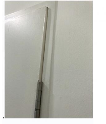

5.Bedroom Entrance Door – Out of aliment
Poor unexperience workmanship ! SP Setia Bhd over 30 years don’t know how to install a door correctly and/or QC check ? ‘Shame’

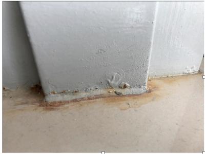

6.Master bathroom door - Rust formation at frame at bottom
(Is your sub-contractor trying to cut cost & save some money by give me a lowest quality fault defective door by not galvanizing it ? felt cheated & very emotional painful for a rm1.million hse ! )

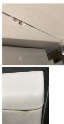

7..Bathroom Sink / Tap Faucet
‘Bad Poor Workmanship’ with tap Screw stick out wall / Cracks on toilet / missing holder for bidet / Sink bottom falling down..& 1 toilet flashing problem.. defective brand. This is new house less than 1 year cost 1 million+ and you give me this crap..??

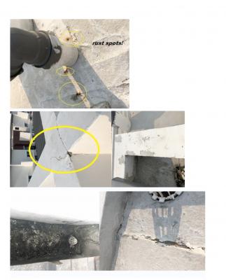

8. Master room *3rd Floor
Overhead beam at both corners major crack just located under the roof ’Gutter’.
‘Wall Line Cracks’ on all sides wall incl. top door edge
(* I suspect no ‘waterproofing coating on all (see no.9) ‘my flat cement roof as required by law under building code therefore water may enter through wall from roof / brick moist and rebar will corrode/rust. Matter time the cracks/ structure failure may get larger day by day.
Is safe to stay in this room?)

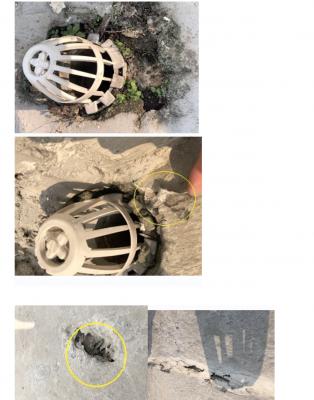

9.Cement Gutter Damage Peeling Off & Entire Flat Roof top layer peeling off (paper type layer) can see some rust spots /marks coming out of cement. Don’t see any waterproofing layer or paint. What type of paint and waterproof coating?
Please sent me proof details and specs material used for roof .
"BLISTERING" DAMAGE ROOF !! <less than 1 year
Why Roof & Gutter facing inwards (bad design) roof /water flow into std cement type gutter instead pvc pipe drainage material. Almost all paint peeling off. Very bad paint quality not for outdoor. Again cut cost at every corners ‘save the penny lose the pound’
'By-law Building code' is a requirement to waterproofing coating for flat RC slab roof !!! There may be a 'breach of building codes' under MPSA agreement.
SKIPPING MATERIAL /SAVING COST. Cheaper material /Cutting material for corruption practices...

iphonegizmo
post Nov 25 2019, 12:16 PM
321 posts
Joined: Oct 2007
Now i found out more info on who is the subcontractor for
Spsetia (decora) after the group of workers complaining about unpaid salaries die 4-5months by BGMC corporation sdn bhd . https://www.bgmc.asia/bod/
No wonder 1st group disappeared and now these workers no mood to work as salary is hold by an indian Malaysian who work in bgmc. So how fix my defects??
And also bgmc installed all the new 6-7door frame damanged defect with rust from the beginning.. big contractor knows how to cheat every corner and make more profits. Low quality material cut cost and unpaid workers. ..bad attitude and untrusted. Very shameful this industry. Still alot corruption going on. As ministers all also sleeping .
