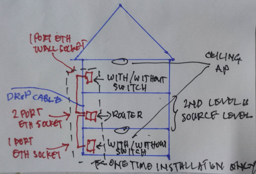

Setup LAN cabling to each of the floors and then setup router on each of the floor. Wifi signal does not penetrate thick walls.
You may consider setting up a switch on the ground floor your house. The switch will connect with your ISP modem or router. From switch,the LAN cables will go to the each of the router on each of the floor.

QUOTE(GOPI56 @ Jan 11 2017, 08:50 AM)
this is the best solution...

I met a dude claim he is from ITD TM & he draw this & say u can do whatever with the eth wall socket each floor.

QUOTE(msrazi @ Jan 22 2025, 05:49 PM)
This is what I want to do b4.
We can put ethernet port each floor (typical 3 storey home), then direct connect to AP router.
Can follow electrical route or TV antenna route (which obviously directly will go to top floor ceiling), just pull LAN cable. No need to hack, just follow existing conduit.
But lastly forgo the idea.
I dont see real benefits although it will boost my Tplink Deco speed a little.
Sekarang pun tgk 4k TV xda lag, CCTV also function like normal, average speed around the house 200Mbps+. If I boost it up, to get 1Gbps, I also get basically same thing (bukan nampak gambar lagi clear pun).
Maybe in future la if there is 8k TVs & PS6 8k games, then I will reconsider this idea.
This post has been edited by khusyairi: Jan 24 2025, 09:29 AM
hsbb
post Jan 24 2025, 08:21 PM
448 posts
Joined: Aug 2009
The drawing is a simplified sketch for basic home networking & fundamental to build a full speed multi storey building network.
For your situation, the benefits are:
1) Your can put RG router at suitable storey depends on your choice.
2) Only need 2 APs, each one locate at non RG router level.
3) Your internet speed is 500Mbps for 3 or more storey because the wall socket extend your router full speed LAN port either 1Gbe or 2.5G to AP. In easy word is the cable carry & connect your 500Mbps internet speed direct to your AP. No one tell you right?
