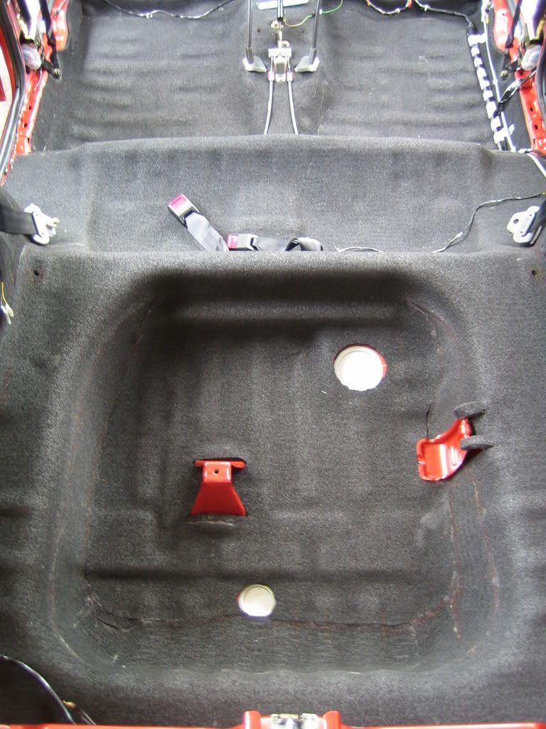

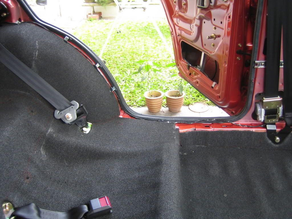

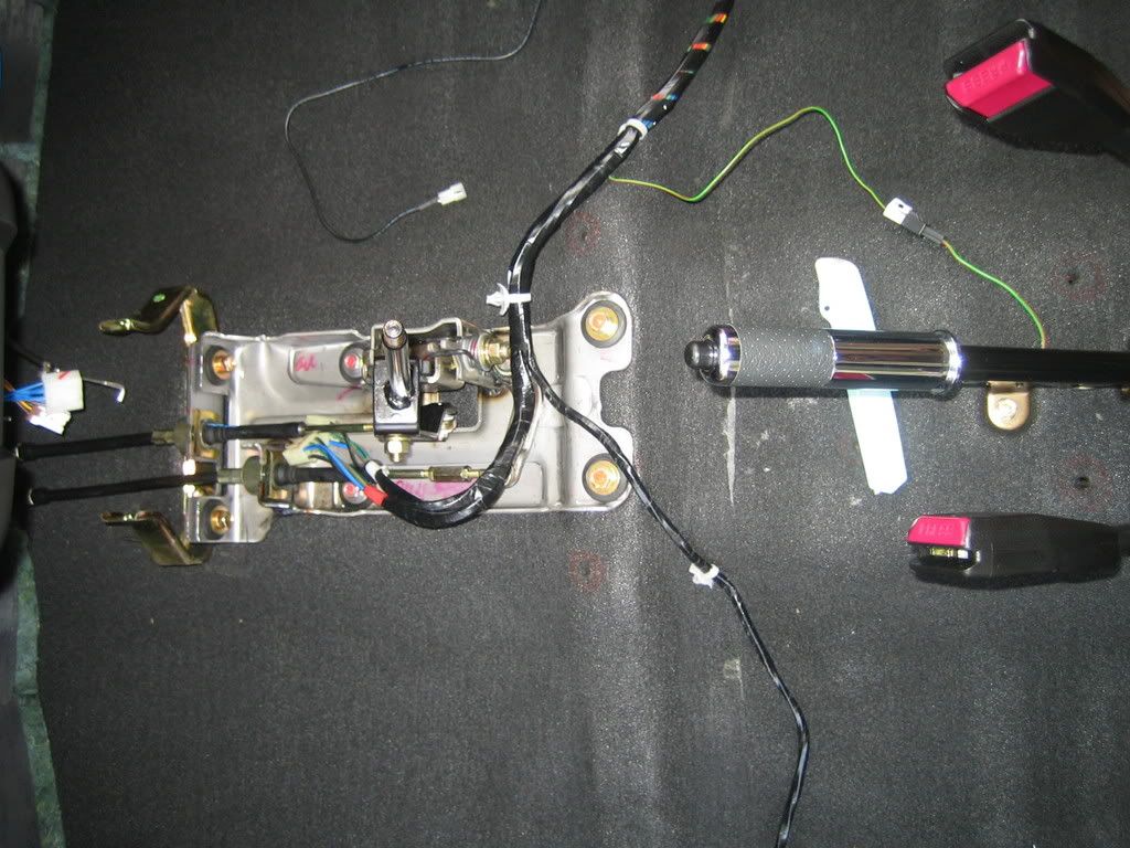

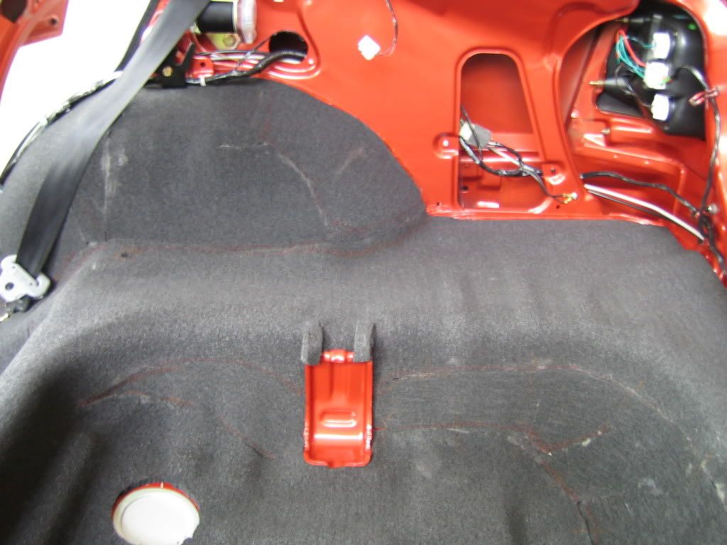

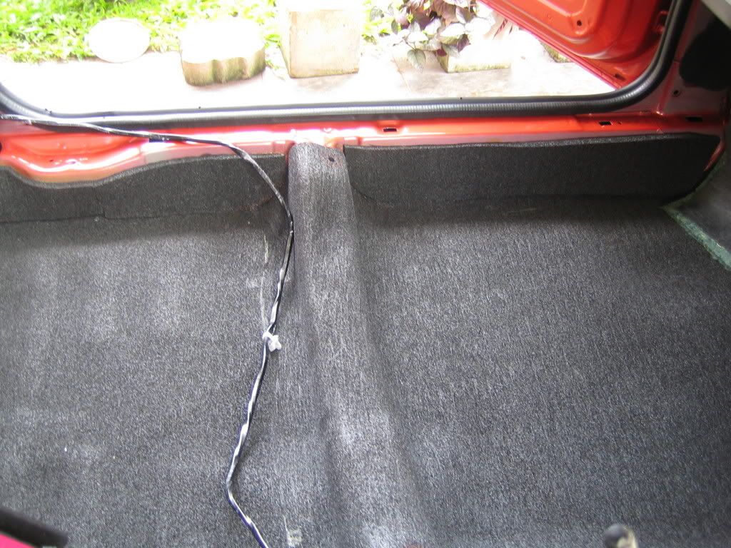

if do urself very cheap

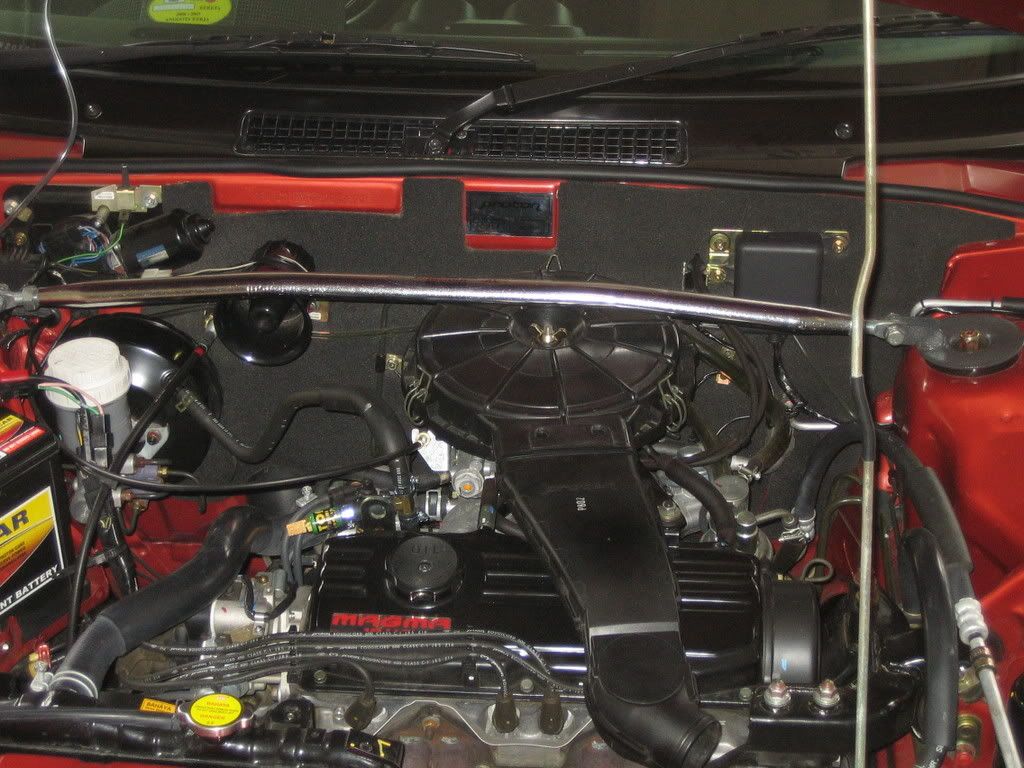

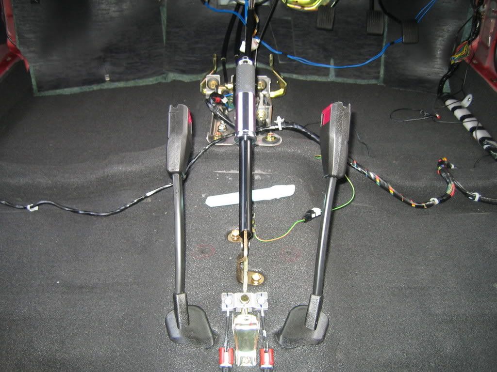

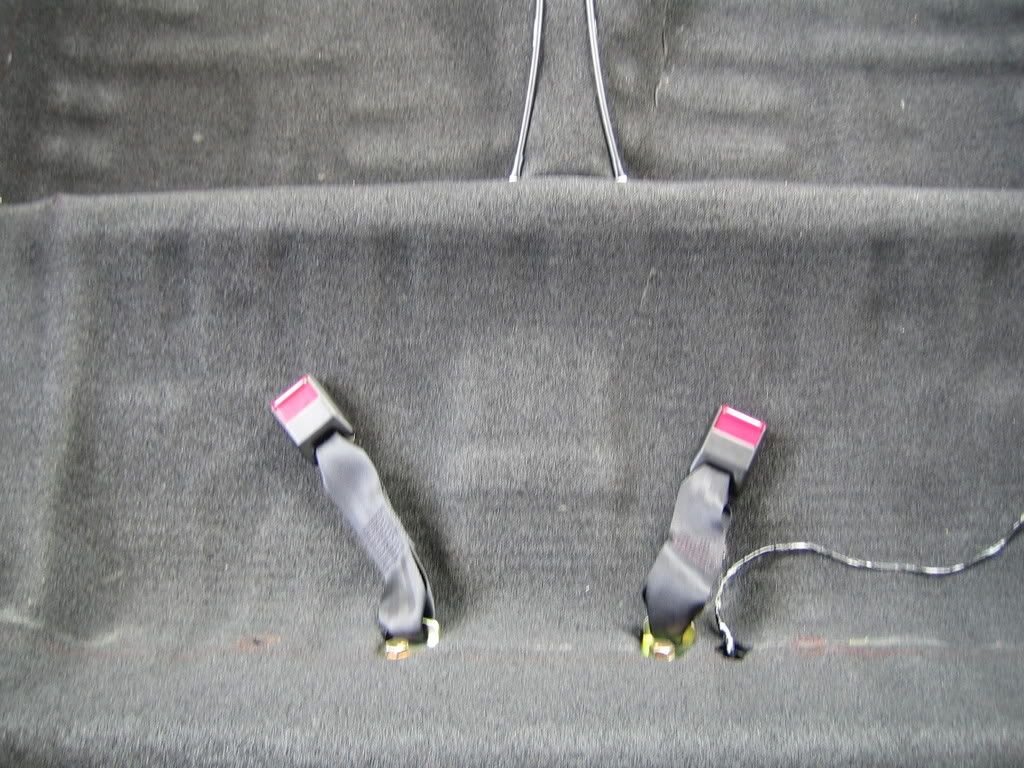

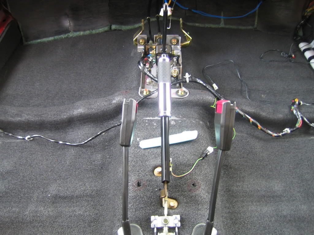

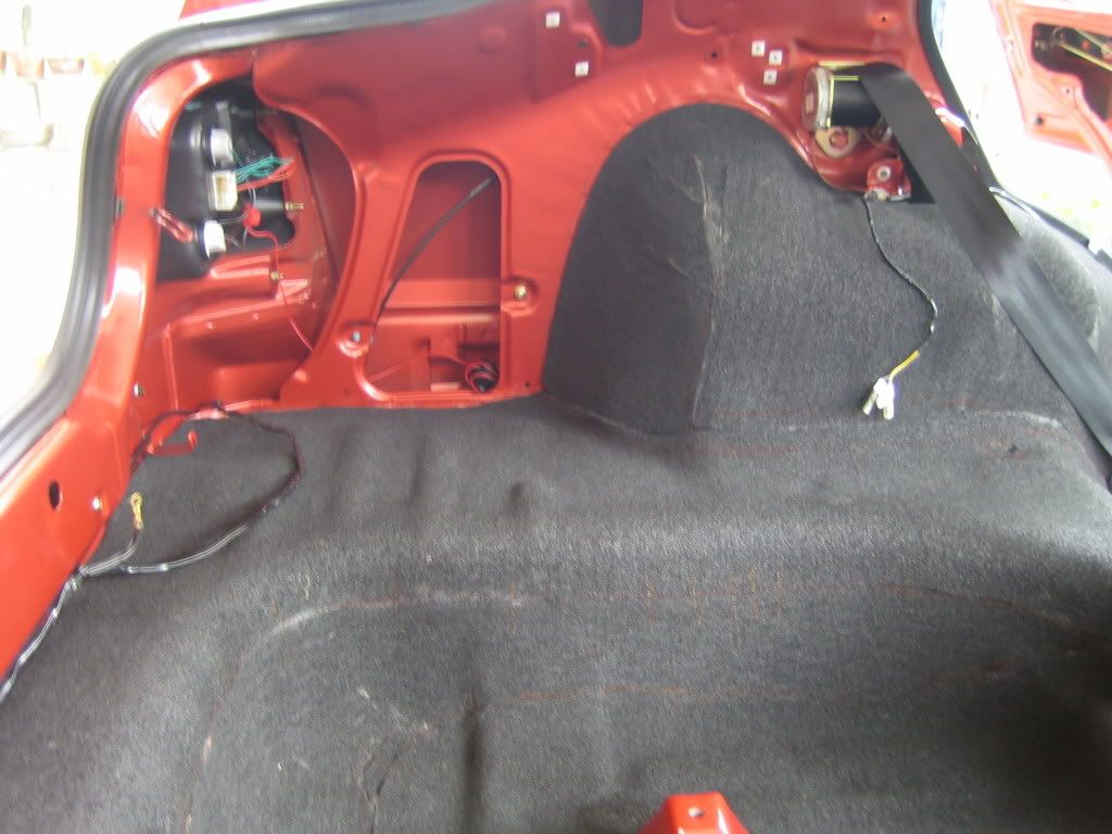

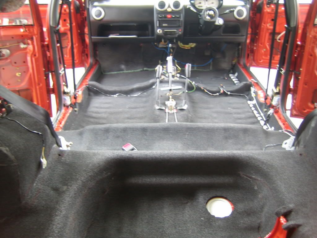

whole car less than 300 for bonnet, firewall, roof, entire floor, booth, and also including tar strips for the door panels
i used 3/8inch for everything except my roof...which was 1/4
the 3/8 comes in a roll...4feet by how long u want
the 1/4 comes in sheets....4x5feet
here r some pics of wat i did
i forgot to take pics of the roof
by the time remembered i had fixed back the cover d
didnt want to open it up just for the sake of taking a photo...hahaha
and bonnet n firewall forgot to take too
will take it soon n upload since its all still visible

i just shot the pics for the firewall n bonnet this evening
hvnt copied from the cam yet
hopefully later tonite can get em up

Added on October 7, 2007, 1:35 amhere they are as promised biggrin.gif
the engine bay firewall is the toughest to do
have to trace slowly slowly with newspaper
easiest is to take off all stuff bolted on to it
then masking tape a heck of alot of newspapers together until its big enough to cover the whole firewall
then use magnets to stick it to the top line
n a few more here n there to keep the paper in place
the slowly use a marker pen n trace the outline
n dun forget to mark where all the holes are too
even inside the car u must remember where all the holes are
if not later u wont be able to find them
n for the holes u will have to burn them out with a hot nail or metal bar depending on their size
coz if you dont n u try to just forcefully screw them in, the insuflex will get caught n start to twist with the screw
and it will then jam your screw and worst case is it will damage the threads of the built in nut which u cant change (i.e. you are screwed)

for floor, the best place to do is the center console area, wheel arch area and the boot area.....
if you do the whole car, i.e. whole interior, roof, booth, firewall n bonnet,...bitumen strips will be wayyy more expensive
insuflex is way cheaper
can get it in pj by the roll
dont get the self adhesive for the bonnet
tried that for my dad's car
the glue gives way after a while n we had to used dunlop CA after that
n its lasted
my dad's car is 9 years n counting
its doing just fine in the engine bay (bonnet n firewall)
to diy inside the car u cant use SA
u need the dunlop glue to be wet so you can slide n stretch the insuflex during installation so it will fit nicely
if its SA it will stick on contact n u wont get it contoured nicely
the smell will be there for a few days if you use dunlop
but it goes away pretty fast
after you've done it and reassembled everything, just park your car in the hot sun with the windows down a crack for a few days
n every few hours just come n open the doors n booth for a few mins
it becomes barely noticeable after about 2 or 3 days....and is practically gone after a week
as for the floor, i'd advice to do the whole thing
the floor is one huge sounding board
once you take out the carpet n tap it u'll know wat i mean
same goes for the roof
memang milo tin man that wan
hahaha
a whole car will take about 4 of those big round tins of dunlop CA
they arent that expensive...bout 10 bucks each je...so dont be stingy!!!!!!!
use it liberally or it will dry before you have time to apply the insuflex n get it into place
n the insulation all in all is about 200+
