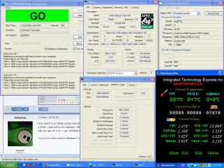

Hi folks, i am going on a mission critical task for the next 5 days. i oc-ed the first comp in my signature to 295HTT, but it passed super PI32M and failed sp2004 orthos beta sweat.gif rclxub.gif seems to have no glitches when i use it for surfing and some audio editing juz now.
in the next 5 days the comp is going to run wavelab 5.0 and doing audio recording and format conversion etc. i can't afford it to crash/reboot in the midst of recording because i can't re-record the stuff. once its gone its gone.
Temperatures:

now... should i leave this alone or clock it a bit lower?? the speed difference if i clock it lower is quite significant i.e. slower. thanks notworthy.gif
pix attached:
user posted imageuser posted imageuser posted imageuser posted image

must pass orthos... if not, there is no guarantee that it will do audio/video conversion without failure.

hmm... i changed my divider to 7/10 and HTT to 305, vCore to 1.45+110%.
now i am getting stable orthos. by the time i finish test 1 at 3mins 30 secs, my PWM IC hits 57C and proc about 46C . i read that pwm ic can take more than 70C(stable) and 108C(rated) and proc max is 69C. can anyone verify my data?? rclxub.gif
http://www.xtremesystems.org/forums/showth...rrerid=&t=60200
http://www.heatsink-guide.com/content.php?...t=maxtemp.shtml
edit: stopped orthos when pwm ic hits 59 and proc hits 49.
