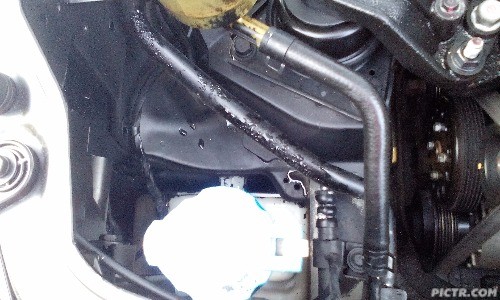

QUOTE(WinterAngeLs @ Jul 28 2016, 12:09 PM)
Hi guys, just got myself a 2nd hand forte 1.6sx 6speed.
I have gone thru a few threads but stil have a few questions...cannot finish reading all threads lol. Hope owners could shed some light on it.
1. Aircond hose in engine bay with water droplets. Is this normal?
2. Gear lever lock button can be press and shift when in Park and brake pedal is not depress. Is this normal?
3. Is it ok to shift with pedal shifter when foot is depressing the accelerator?
4. Gear lever cannot engage minus(shift down) in manual mode but shift up is fine. Can this be rectify? Thx all
1. Yes. Thats the cooling hose
