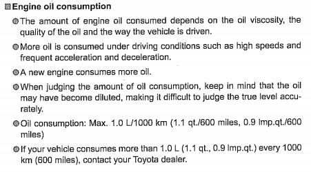

So got a hold of an English version of a full user+maintenance manual for a Japanese Toyota, engine 2ZR-FAE, smaller version of the 3ZR-FAE in the full spec Altis, not the outdated 2ZR-FE.
It states there, check engine oil regularly, oil loss of 1 litre per 1000km travelled is normal. Anything more, contact your dealer. AFAIK, I've never used an engine that makan oil on a NORMAL basis, but this one mmng stated plain jane. The NORM is kalau engine oil hilang 500ml after 5000km pun orang sudah busy do overhaul here and there.
What say you? Updated with screen.

You sure it's not a typo mistake ?... 1ml / 1000km and not 1L = 1000ml.

Yeah, was looking for that response, but 1litre per 1000km. 10 days sudah 1000km. Need to check my engine oil xd ler...

QUOTE(unitron @ Nov 11 2014, 10:19 AM)
printed 1.1 qt/600 miles also, so definitely not mistake already.
1 quart = 946.35 ml
Quazacolt
post Nov 11 2014, 01:37 PM
Riding couple
5,369 posts
From: KL Malaysia
modern synthetic engine oil evaporation is very unlikely even in turbo applications.
most likely it is leaking (through piston ring/seals, then burnt off through the exhaust) due to bad seals (or in turbo case some could be evaporated while lubing the hot turbine) and/or higher clearance especially under full load/high power applications.
remember, flash points for modern full synthetics is >200 Celsius
you have bigger issues to worry about if your engine is constantly subjected to that sort of temperatures.
