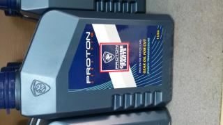

CVT Transmission Service Instruction
https://forum.lowyat.net/index.php?act=Atta...post&id=3808088
credits to: Maxwell6635
CVT Transmission Service ESTIMATED price at Proton Edar Service Center
CVT Fluid [1Liter x 4bottles] = RM40x4 = RM160
CVT filter = RM 235.25
CVT labour charge = RM 60.00
Total: RM 455.25
Optional:
Transmission Gasket = RM 122.72
Total including optional: 577.97
*Part and labour price subject to change by Proton without prior notice
*As rough reference only. Not necessarily reflect 100% actual price charged by SC

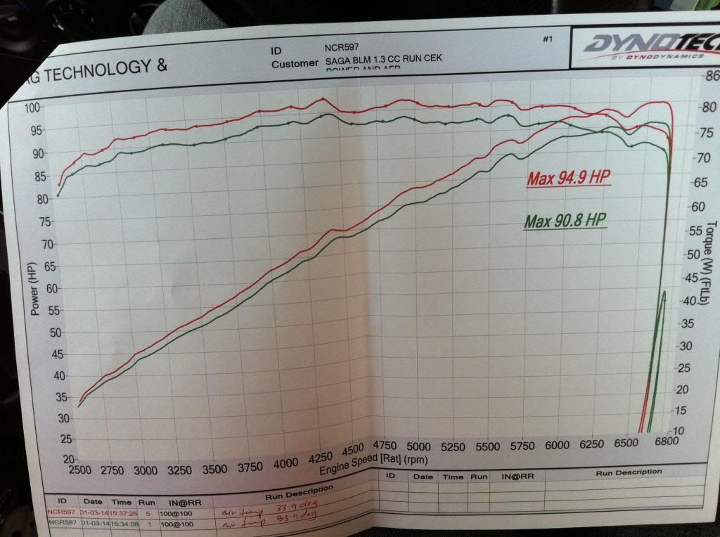

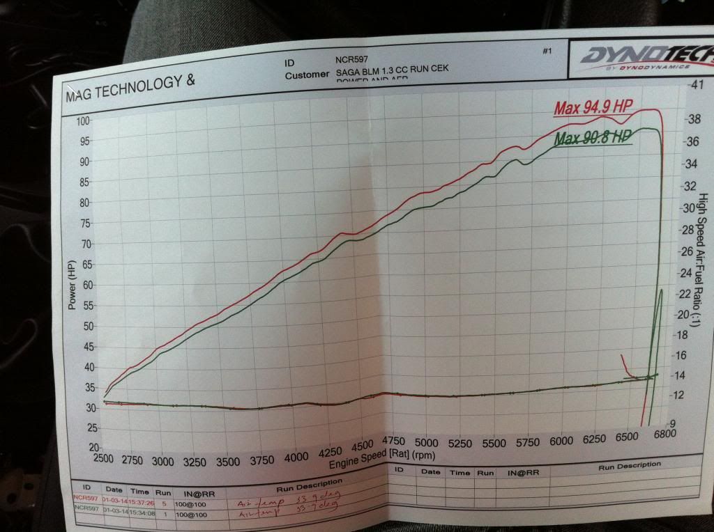

Hi guys. So fast new thread already. Very hot weather in Bangkok and good thing is my job already settle earlier than I expected so I will be coming back to Malaysia this evening. So much to share with you guys on my virgin trip to Bangkok. I didn't go to a lot of places due to my customer advice me quite some area is not safe since the riot is on the move now, heard the news they changed the place just 2 streets away from my hotel.
I will also share with you guys my dyno run result which yield very good results which exceeded my expectation of my estimated wheel Hp.
fuiyo damn fast, but glad to hear ur safe...
fast fast i wana to hear ur storey...

QUOTE(V12Kompressor @ Mar 4 2014, 01:27 PM)
Fast car kambing
Now we know why Vios got smoked.

BTW, here's the Dyno run result....Actually I didn't expect that have 90+ on the wheel....since my car was stock and only light mods so my expectation was if I can get 85+ something than happy already as I need to minus off the lost from the gearbox and friction....I notice that my car is running lean at high rpm..low and to mid end the guy said my AF is very good and stable. Seeing the chart and knowing I'm only 5whp short from getting the 100 mark...I really have the urge to try it out....but getting another 5 from NA is not going to be easy....but if I can do that, it will be very cool...and I will be able to have a 1L to 100hp engine....Hahahaha....really dreaming of that....like what Honda have for their type R engine...2L outputting 200+ hp...
After print out...
Graph 1 (whp and AF Ratio)
Graph 2 (whp and torque)

from the chart during high rev slightly below 14 AF. still consider lean ?

QUOTE(MylesAuto @ Mar 5 2014, 01:52 PM)
That's what he told me...maybe is the rev close to the rev limit that section...just maybe....but how I see the chart also the AF i ok for the entire range....maybe he meant rich....I think the car can produce more power if it run leaner but my FLX is returnless fuel rail so cannot use AFR also....
QUOTE(r3apers @ Mar 5 2014, 01:59 PM)
Normal la....another guy's FL also manage this figures la...

Iska, dyno run or test is to see or check whether the mods you did to your car really improve or not. Like how mighty car mod guys did.
2ndly, dyno run is also useful to check your engine health and AF ratio over the entire rpm range in actual driving condition. One also can use a dyno machine to tune a car that is installed with aftermarket piggyback, standalone ECU or adjust the AF ratio on the fuel regulator...etc

I don't think my torque is nice....still room for improvement
QUOTE(r3apers @ Mar 5 2014, 02:57 PM)
Me not sifu la.....like iska said David's explanation is better but I also want to see how david explain it.
iska, also a dyno chart is useful for the driver to know how the engine outputs power and the torque curve so you can use that information to change your driving style so that your engine can performance better....for example, at what rpm, my torque is how much then what gear to use..etc...etc...this is useful for track driving but also can be used on daily driving one..I'm still learning to interpret the chart and use that info.

QUOTE(MylesAuto @ Mar 5 2014, 03:09 PM)
alot ppl will bang wall after hearing your torque is not nice.
i believe further improvement will require quite some $$ with the state of the ride.
need to touch internal parts ?
Really?? why? I find my torque curve quite normal...
further mod will be more expensive already and not going to do any soon also...if want more power will need to increase the CR, stroke up the capacity, currently, my internal mods are all DIY home made stuff....no bench flow test, certified and just learn from overseas forum....but now I focus on upgrading the brakes, and more tuning on the suspension. Power wise, is enough for now and more important is how to put all those horses to good use and how to improve on the braking.

QUOTE(TitanRev @ Mar 5 2014, 04:23 PM)
can try see what's the max can go with just bolt on parts and some DIY mod....
maybe is just me, the torque is stable entire rpm range which is very good.
from your chart i am seeing ~ 10% from max torque entire rpm range.
if i am not wrong, for our engine the different from max torque during 3k rpm or above 5k rpm should be way more than that which would make it a steep torque climb from 3k onward & downward after 5k rpm. hence the reason i say ppl will bang wall.
by stroke up to 1.6 u would be able to increase the CR at the same time.
do correct me if i have mistaken the info.

QUOTE(MylesAuto @ Mar 5 2014, 03:59 PM)
Oh...now I understand what you mean...is my torque curve very flat....I never saw other BLM torque before....would be nice if can see it so I know what's the difference. I got suggestion to use 1.6 rod and maintain 1.3 piston...

QUOTE(TitanRev @ Mar 5 2014, 03:03 PM)
Dyno is for peepur drib a car up a huge dynamo, use petrol to power the engine, plonk 3rd gear full toto to run the car on the dynamo to generate electricity whistling.gif

QUOTE(TitanRev @ Mar 5 2014, 04:04 PM)
Bcum kompression too high, easy knock, need higher rating octane fuel. Not reliable

QUOTE(davidke20 @ Mar 5 2014, 07:38 PM)
biggrin.gif biggrin.gif Like this also can.....mine was on 4th.

QUOTE(davidke20 @ Mar 5 2014, 07:41 PM)
If I use thicker metal gasket to lower down the CR can also right?

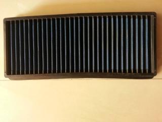

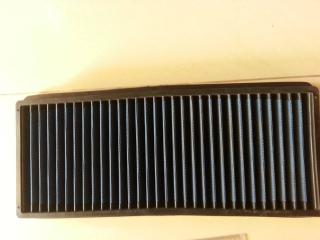

Simota Drop In

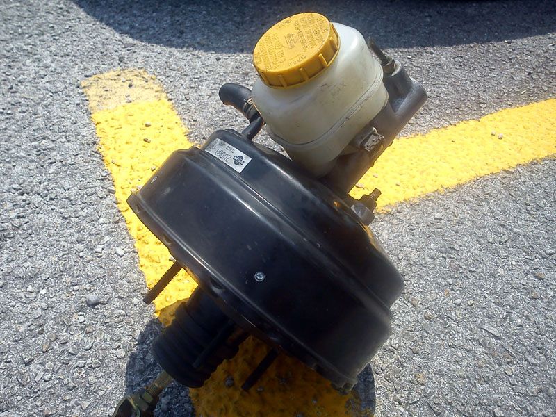

davidke20
post Mar 5 2014, 11:22 PM
3 posts
Joined: Mar 2012

QUOTE(davidke20 @ Mar 5 2014, 11:22 PM)
Fuh RCS RCS RCS
same lol, damn curious since there are talks/plans for RCS on my ride too laugh.gif

QUOTE(blau-saga @ Mar 8 2014, 01:45 PM)
just done my 50k service. Ask for cvt oil change, but the SA don't even know to add cvt oil filter or not, end up doing on next service as in maintenance schedule. because the item is not always in stock. Then he told me need to add another 1xx for the cvt gasket. When done @60k / 36mth including major svc easily RM1k++ needed
My Advice is Change the CVT oil with this New CVT oil Attached Image , the price same with the Old ones, RM40 per bottle. Change with the CVT filter will be much clearer for your GB , the CVT gasket is no really need change depend on your budget, if u can afford then go for it.

QUOTE(Maxwell6635 @ Mar 8 2014, 05:46 PM)
i also been thinking, there should be drain plug and no need to dismantle anything to change the cvt oil right? if we take example from manual & auto gb.
I did not use this coz it's still "new"
Since they still have stock for the ezl i chose that instead since its a tried n tested cvt oil for our vt2.
Even stock factory oil is the same.
Not sure the new oil can really last so long, for some up to 60k.
Least this esso cvt oil has already been tried and tested by so many gaga and prebet.

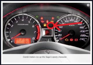

The picture doesn't show the light cause I just googled some image cause the light appear on my car hilang jor hmm.gif
Guys & Girls & Sifu's wanna ask just now I rev my gaga very rpm then emergency brake ( twice ) to test the braking distance, but that light came out, my car barely able to move, rev the car and it move abit only, decided to shut all off restart car, and its back to normal again what's the problem arh? icon_question.gif

ini kah?
itu ialah CVT warning light. car barely able to move with the light on means your car is in safe mode. CVT wanna protect itself.

Your emergency braking could've cause belt slip or clutch slip (basically the TCU could not react fast enough to sudden speed change), I think shouldn't be any problem. If worried, just send to Proton SC to check the fault code.

I'm not a CVTfag, but I have some experience in causing belt slip and got some idea on how that happen. You can replicate this by having the car going downhill, whilst maintaining throttle input to match certain speed, say 110kph at MEX hi-way. A sudden traffic condition change, may be a slowpoke suddenly cut out, you're not anyway too near to crash, you release your gas pedal to lower down your travelling speed, now your driven pulley(attached to drive shaft) will have more torque input from the road feedback feeding to the driver pulley(attached to clutch and engine). This will normally cause the warning lite up. Usually is from fast speed sudden release gas pedal for a very long distance, especially long downhill. CVT detected unusual torque input, hence it managed it as belt slip.
I can replicate the above symptoms repeatedly on MEX heading down south direction before Sri Kembangan R&R. Other than that, Plus NS hiway at Gua Tempurong stretch is also another good place to make it lite up. If does the above also couldn't make the lite up, I'll whack a little more violently, then suddenly release gas pedal and let the gravity roll the car even faster, and usually the warning will pop up already.
Basically, it's an indicator of belt slip and or unusual torque input from the driven pulley(too much feedback from the road). If the indicator goes away without appearing too often, it should be fine. To be safe, send to SC immediately for the diagnostic. The fault code will only store in the system for very short time. Reason being, if it's truly a faulty in your car, you wouldn't able to drive it for 2 days straight before send to SC.

Trying to find PS fluid for my gaga.. See so many specs also blur liao.. Some more have ATF Dexron II - D

QUOTE(iskazulka @ Mar 12 2014, 11:03 AM)
brake pump & drum brake sama ka? i confuse ady, don't blame me.
ini ialah brake pump. It is part of the car's rear drum brakes component.
ini ialah master brake pump, for all our car's braking powah
kalau rosak #1, then normal and common problem. Kalau rosak #2, then you are really unlucky.
slave brake pump in the drumbrake, also known as wheel cylinder or brake cylinder (ignore tha label at the bottom, that is the brake shoe not wheel cylinder)
This is common problem in drumbrakes as it can be jammed by accumulated brake dust.
Master pump / master cylinder is the one shown by V12k, open your bonnet and you can see it on your firewall.
QUOTE(V12Kompressor @ Mar 12 2014, 11:06 AM)
Last time you say mau upgrade master pump, dah?

QUOTE(r3apers @ Mar 12 2014, 11:21 AM)
can, but not easy job. need specific tools... so not all workshop can do.
I selling it now. if no buyer then oni install la. lol
somemore that day after do brake bleeding edi, now all sorts of braking noise coming out. lol dunno issit rosak or issit better bite edi. laugh.gif
QUOTE(dares @ Mar 12 2014, 11:24 AM)
From what car?
Nissan skyline GT-R V-Spec II NuR

QUOTE(V12Kompressor @ Mar 12 2014, 12:06 PM)
for #2 if wan upgrade from other car, those from chop chop shop. is there any that is plug and play ?
