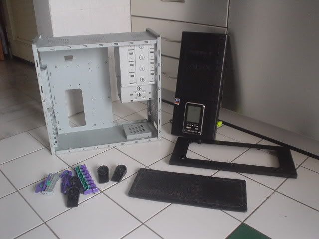

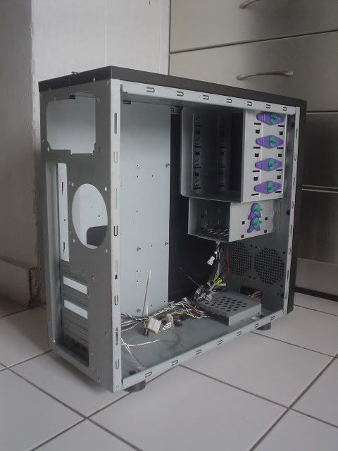

I got this as a stock standard Atrix looking like this.

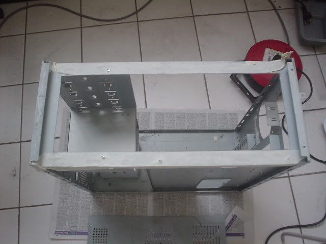

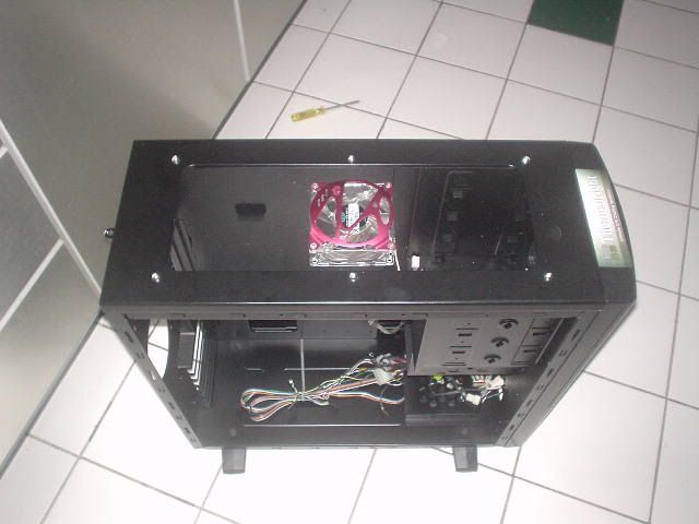

Here's the 1st thing I did today. removed everything so I can work on the top window n respray the chassis in matt black.

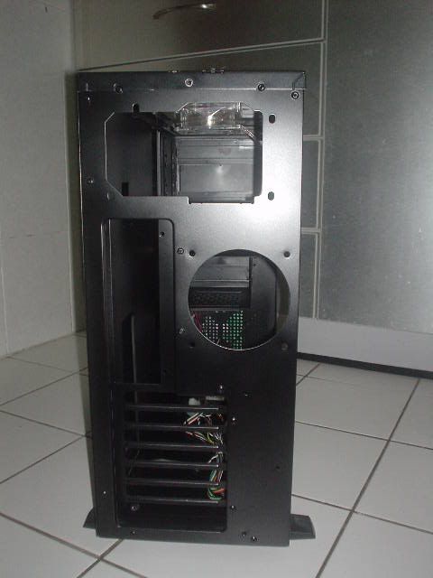

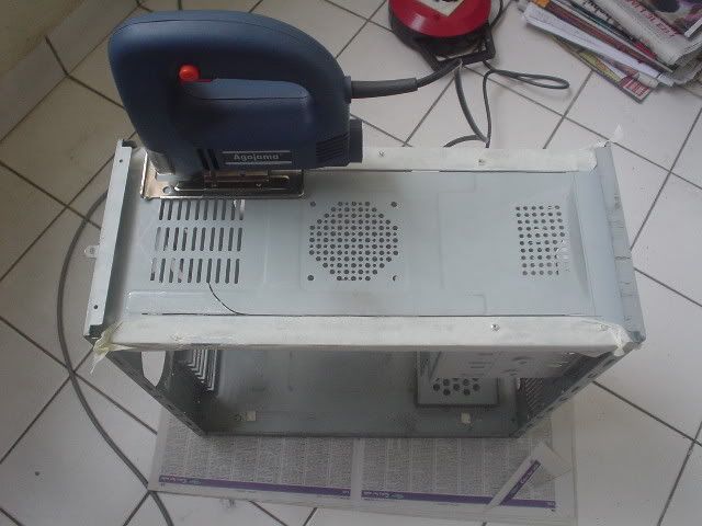

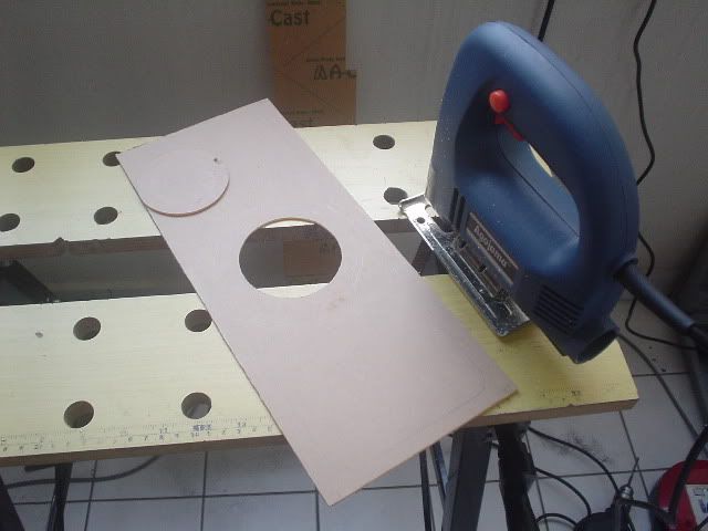

Next thing to do is to mark out the top panel n cut out the hole for the window on top. N awaaaaaaaaaayyyyyyyyy we go with the cutting.
Cutting done, now u hafta file down the edges nicely

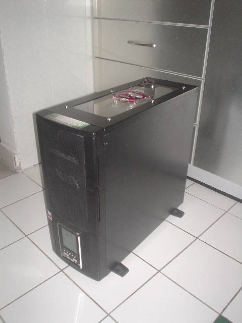

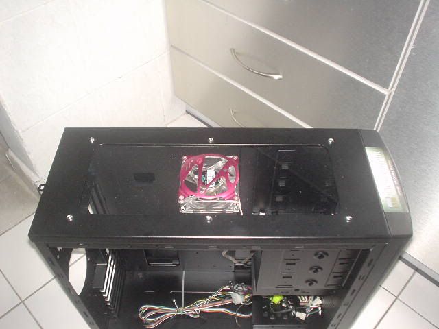

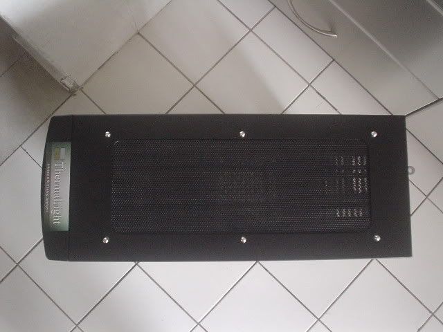

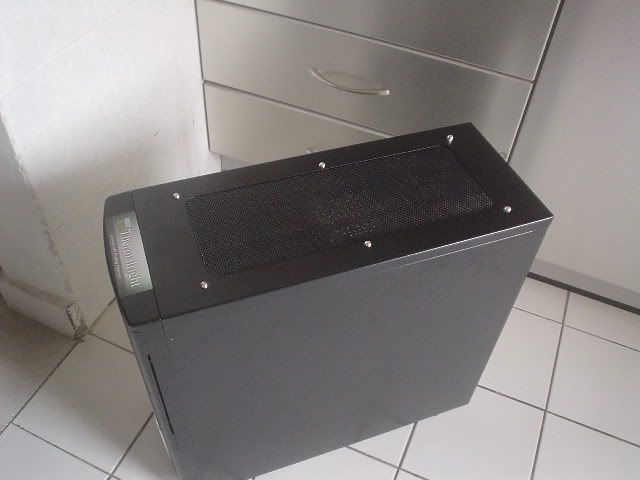

Next thing to do is the acrylic for the top. measure the exact size u need, mark it out n start cutting. Also cut the fanhole at the same time so u dont hafta go back to cutting the hole after installing the window.
For this window I used hot glue to mount instead of the usual double sided tape coz of the 6 screws. I had to drill out a big hole for the screws to let them tru the acrylic n then hot glue the bottom of the 6 screws to keep it in place. Forgot to take pix of this step. But here's how it looks after everything is done.

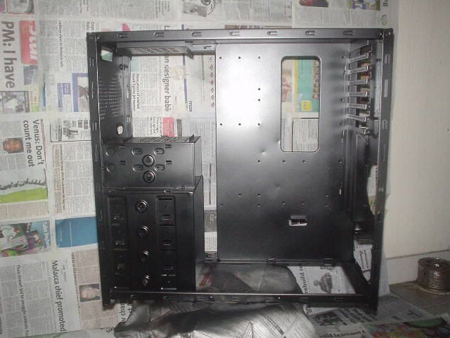

Painting the chassis matt black is next. Doesn't sound like much of a mod eh? But wait till u c the end result n u'll b amazed at how much better the Atrix looks with a matt black chassis.

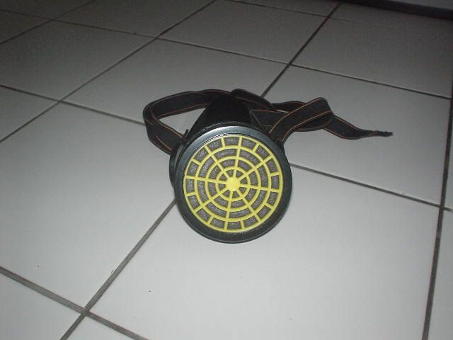

Remember to wear a gas mask while painting ya. If not u'll b breathing in all those nasty paint fumes. Lemme just show u guys how nasty the paint fumes r. This is a pix of my gas mask's filter.
Gas mask pic.

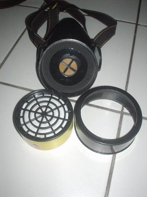

This is the filter after painting. It's actually black in real life but sumhow in the pix with flash it looks just grey.

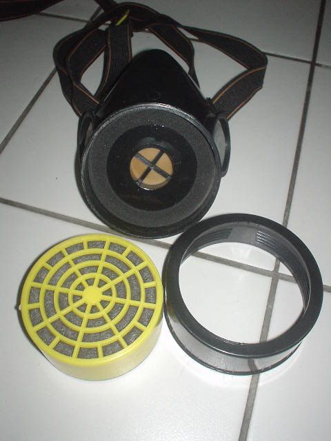

Now take a look at the other side of the filter. This is the clean side that u breath from. Shocking isn't it? Look how nice n white it is.

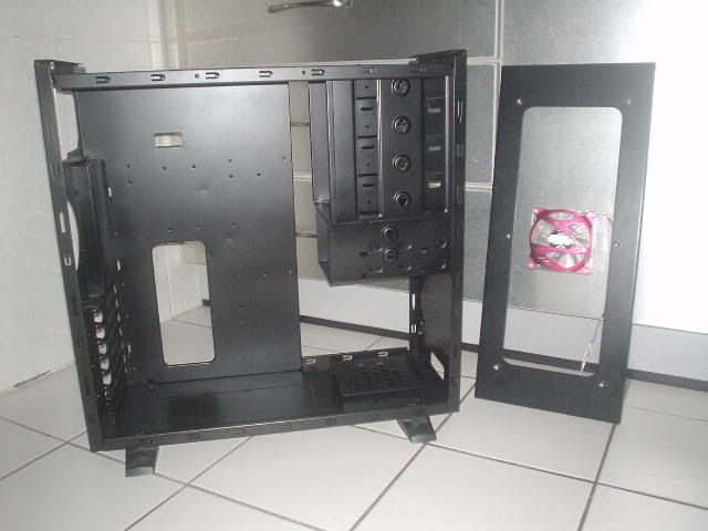

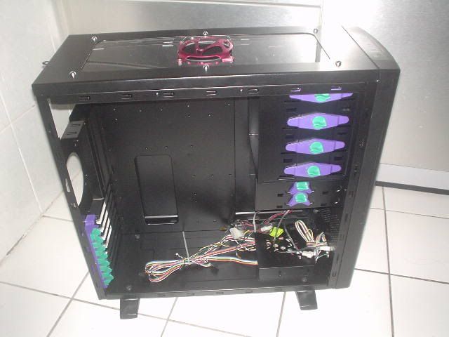

Chassis painting n top window done. Time to assemble everything now.
Complete pix.

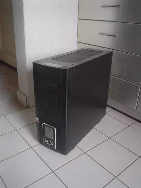

Now take a look back at how this simple 1 day mod has transformed the Atrix. It doesnt even look like the same case anymore.
Stock chassis.
After the simple 1 day mod. The matt black also highlights the purple tool less mounts as well. Very striking contrast.
Looks totally different now doesn't it. thumbup.gif thumbup.gif thumbup.gif thumbup.gif
