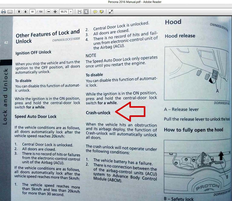

Bukan bomba/jpj. Its ECE regulations.
You can put autolock feature IF you have BCM impact sensing auto door unlock.
And Proton do have this in their Preve. Preve was built to comply global safety standard in mind.
http://www.unece.org/fileadmin/DAM/trans/d...SP-51-07r1e.pdf

Not malaysia dey, it global standard.
So those new car has to comply ECE standard, since they lacking BCM to sense impact to unlock the door.

QUOTE(tonitoni @ Jul 25 2013, 04:07 PM)
Any proton model that have Body Control Module (BCM) such as exora and preve

SUSlijor the great
post Apr 16 2021, 10:57 PM
356 posts
Joined: Nov 2020
QUOTE(soules83 @ Aug 10 2018, 10:12 AM)
manual car lock will auto unlock during accident? Got such feature? How come auto lock cannot unlock during accident? I don't get the point?

QUOTE(croydon @ Apr 16 2021, 11:01 PM)
Proton safety first

QUOTE(Quazacolt @ Apr 16 2021, 11:03 PM)
Proton safety first
Jepunis brands know they can sell rubbish in Malaysia because Malaysians love sucking their dick.
