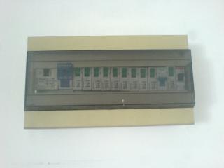

TSblasto
post Dec 17 2013, 08:09 AM
1,139 posts
Joined: Aug 2008
my observation this meter is running very slow, my master meter TNB which is digital is running 3-5 times faster...
