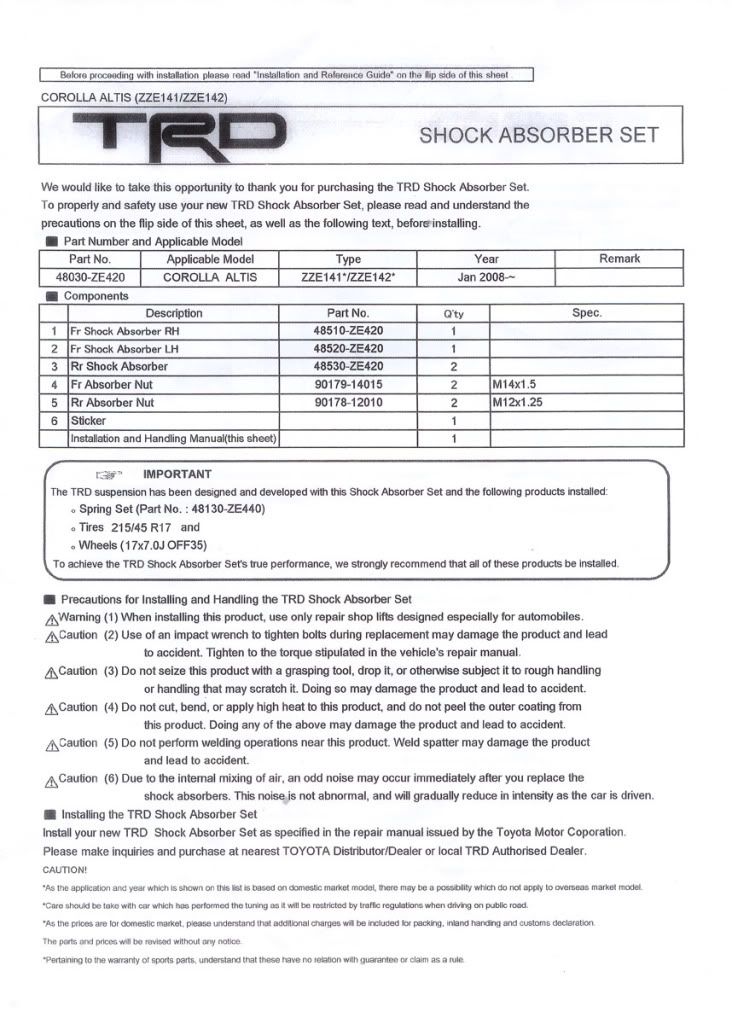

215/45/17 is the recommended spec from TRD.
This post has been edited by eddychstu: Mar 12 2012, 02:24 AM

QUOTE(eddychstu @ Mar 12 2012, 02:16 AM)
hmm...will it b the recommended tyre spec works best if install all other setups as specified in the sheet?coz definitely i won't touch the suspension and other things tat will void warranty...
