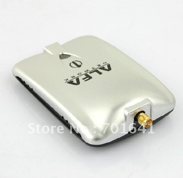

xcharlie
post Dec 27 2012, 05:36 PM
9 posts
Joined: Jul 2008
QUOTE(coolstore @ Dec 25 2012, 02:22 PM)
stock updates:
Metteor-Link 14dbi panel directional antenna: for wimax Malaysia & wifi usage = last 6 sets available.
Can it connect to ALFA AWUS036H?
I'm also planning to use it with YES Zoom, once I buy one... LOL!

TScoolstore
post Dec 30 2012, 11:28 AM
1,524 posts
Joined: Apr 2008
QUOTE(xcharlie @ Dec 27 2012, 05:36 PM)
both also can.
for wifi, just plug & play.
