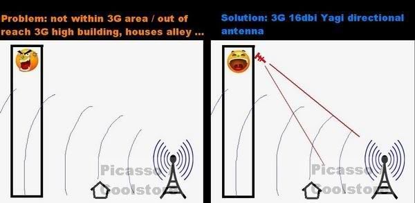

~ Why need external 3G antenna? How does 3G external antennna help? What problems being solved?
~ Directional antenna VS Omni-directional antenna, whats are their ideal applications?
~ Matters of our 3G runs at 2100MHz or 900MHz band? pros and cons.
~ 3G dedicated 2100MHz antenna VS generic wide band antenna (range within xxxMHz to xxxxMHz).
~ How characteristics of Yagi, Panel and Parabolic directional antenna affect users setup experience.

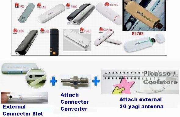

3G gadgets that work with Metteor-Link 3G antenna:
a) USB 3G modem that with external antenna connector - connect via a converter cable
E.g.
(Huawei) E122, E156, E156G, E160, E160E, E160G, E1612, E161, E169, E176, E176, E1762, E196G, E1820, E1823, E182e, EC321, E353, E367, E372, EC881E, E600, E612, E618, E620, E621, E630, E660A, E660, K3520, K4505, UMG 181, UMG 1691, UMG1691, UMG181, UMG1831, E3131, E398, E392, E3276
(Sierra) 597, 885, 888, 889, 305, 306, 307, 308, 309, 598, 313u, 320u, 330u
(ZTE) MF633+, MF633BP+, MF645, MF668, MF668, MF680, MF821
(Vodafone) K5005, K5006

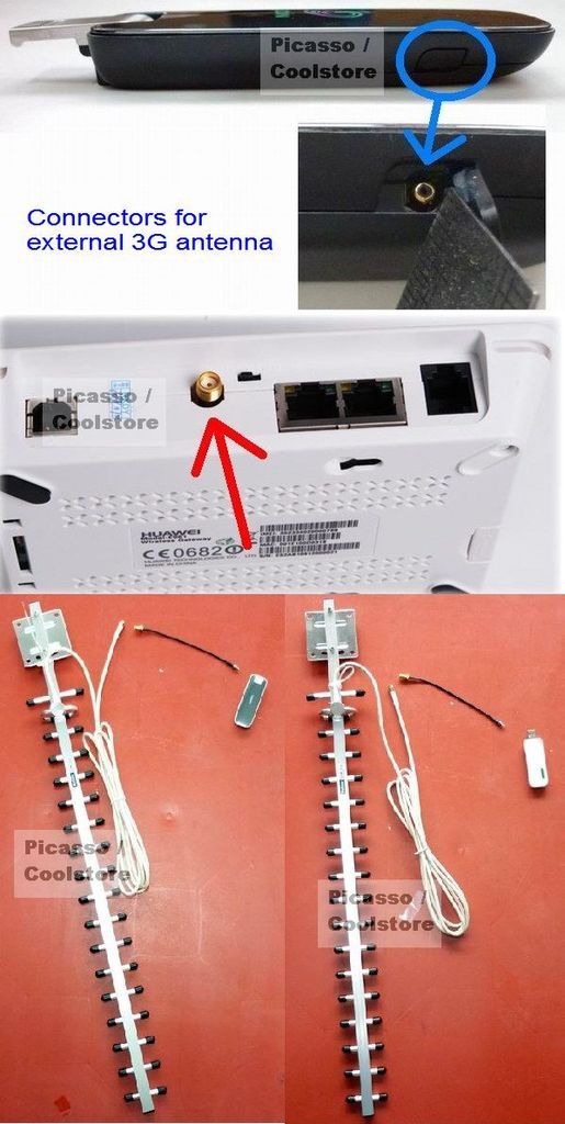

b) USB 3G modem that without external antenna connector - connect by either soldering a pigtail cable into the internal board or using a specific converter cable.
E.g. Huawei E1550; E1552; E173, E303, ZTE MF190 etc.

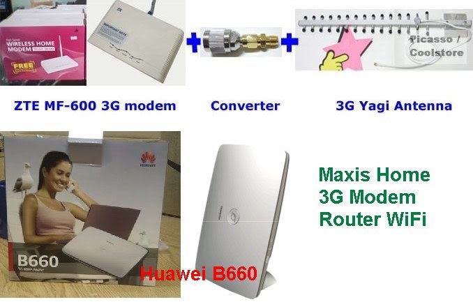

c) Battery powered portable 3G MIFI with external antenna connector - connect via a converter cable
E.g. ZTE MF60, MF61, Huawei E5332, E5372, E5776, E589 etc.
d) Battery powered portable 3G MIFI without external antenna connector - connect by either soldering a pigtail cable into the internal board or using a specific converter cable.
e) Desktop CPE/ gateway (all in one 3g modem + router + wifi) with external antenna connector - connect via a converter.
E.g. Huawei B220, B660, B681, B683, B932, B961, B968, B970, ZTE MF600 etc.
f) 3G Repeater/Booster with antenna connector.

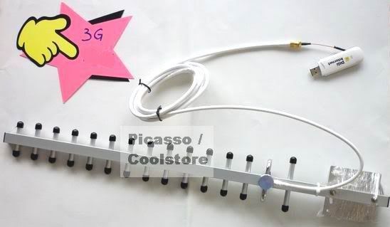

Metteor-Link 3G Yagi Specifications:
Brand: Metteor-Link
Model No.: ML3G-DY-18
Frequency: 1920MHz~2170MHz (band 1)
Gain: 18dbi
Horizontal Beamwidth: 26 degree
Vertical Beamwidth: 26 degree
Connector: RP-SMA
Cable: 50-3 2 meter
Features: Adjustable up/down mounting kit! *** (adjustable tilt direction, so that you can point upwards/downwards easily)

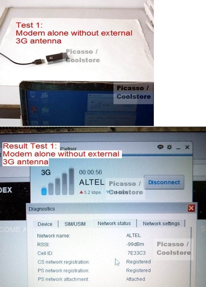

This reviews starts with:
Testing (1) - Modem alone (with internal antenna)
Conditions:
Wheather: sunny, no rain.
Location: indoor, in a room.
Results of Testing (1):
Signal Level: RSSI: -99dBm
Bar chart: 1 bar
Tips for U: RSSI number is signal level, it is accurate signal level measurement against bar chart indicator. RSSI with lower number means higher signal level, RSSI with higher number means lower signal level. User should always refers to this information when available.
Conclusion of Testing (1):
Weak signal reception level at this spot with modem alone.

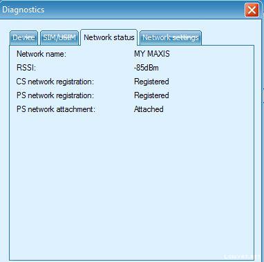

Testing (3) - Modem with tradisional directional 3G yagi antenna Metteor-Link
Antenna tested: Metteor-Link 3G yagi directional antenna 18dbi
Antenna is positioned in similar slope way as seen in picture.
Results of Testing (3)
Signal Level: RSSI: -85dBm
Bar chart: 5 bar
Conclusion of Testing (3)
Now you can see true capability of tradisional 3G yagi antenna by Metteor-Link, improving from -99dbm to -85dbm! A true 18dbi yagi works far better than those good looking fake 25dbi, 35dbi, 48dbi...antenna in market.

just show it here again for others to read.
the antenna connector of E1762 just sit besides the sd card slot, open the SD card slot, can view the connector already.
the name for that connector is crc9. with a converter crc9>rpsma, you can in future add in any rp-sma connector 3g antenna for your huawei modem, no need buy specific huawei 3g antenna.
so open the slot + plug in one side of the connector converter + and connect the 3G yagi antenna to the another side of converter.

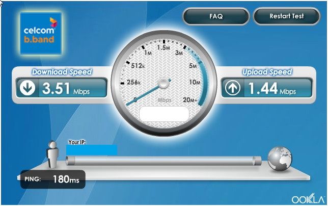

hi bro
received the item..tested with E1762 +Yagi 3G 16dbi = full 3.5G
marvelous....!!!
thx bro..
