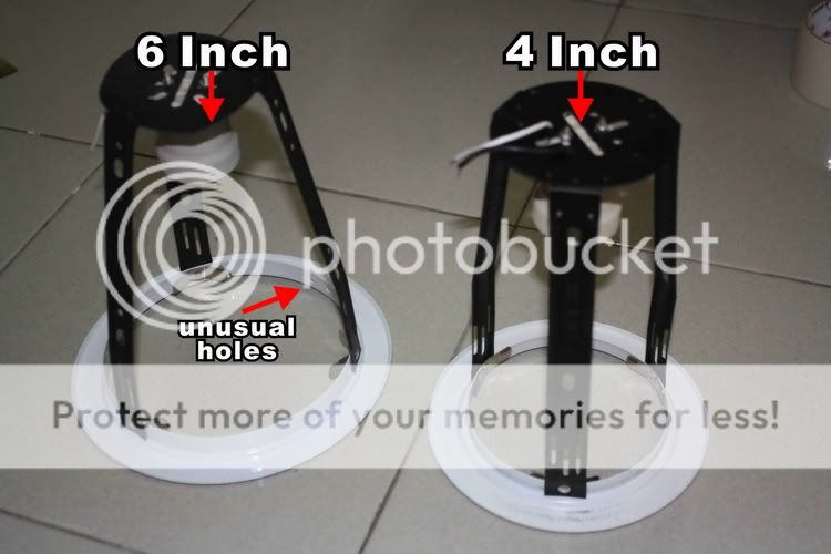

You all may quite familiar with this design of simple downlight smile.gif I took 2 samples which are size 4 inch and 6 inch.
Before we install the downlight together with reflector, we should see something as above which are the downlight casing(the white ring) + supports(the black frame). When I have a close up inspection on the quality suddenly found out that the 6 inch one quite abnormal

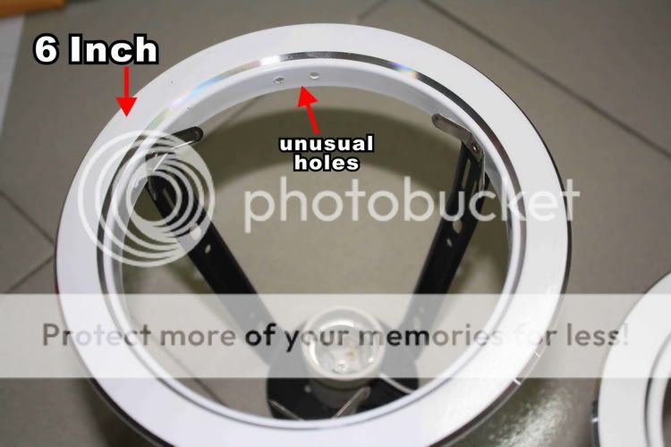

there are additional unusual holes on the casing as in the photo above.
another close up on the unusual holes. This might not be a big deal as when you fix the reflector, everything are covered up. But I am just curious is this suppose to be on the 6 inch downlight?

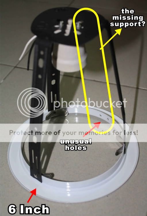

seem like there is a missing support as the additional holes are actually used to fix the 4 supports instead of just 3? as below

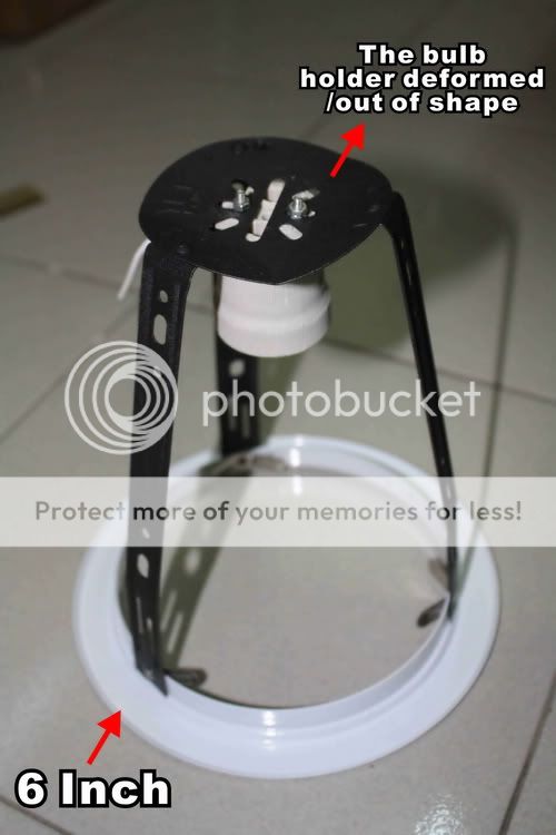

Other than that, I felt like the supports are forced to be fixed on the 6 inch frame until they are deformed to be out of shape as below

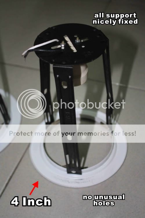

I took another close up inspection on the 4 inch one, everything nicely done without additional holes or out of shape

will you feel that, if that 6in downlight having that additional support, will it look uneven? the 3 support are very close to each other, but another 1 is a bit far.. So for this reason, i believe that 3 support may be consider as normal.

Is more on build quality, most china made is like this. And the bulb holding depend on the bulb you need to use the shop will fix it for you.
For the more quality build down light, even the reflector are made of thicker and harder material. But it cost 3 to 5x more. Just do the math, if you keen I think there is one shop in ss2 import the Europe made down light.

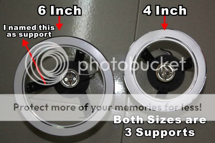

Herm hmm.gif It sounds correct also regarding the uneven look if 4 supports. But just felt weird why there are additional holes in which we are not going to use. Further more the deformed/out of shape bulb holder really looks weird, this will affect the light bulb position level and hence affect the light directivity.
I just did a comparison between 6inch and 4inch, the supports for both of them are exactly the same, so it seems like they are using 4inch support to fix on the 6inch one and end up forced until out of shape. Like kena paksa one. Is there any difference of height between the 6inch and 4inch downlight? I will pay a visit to the shop when I am available to reconfirm this.

Well, my experiance is, 4" & 6" downlight actually look very similar, only the surface are diff only. and from what i remember, 6" downlight also usually hv 3 support only, that look normal for me, may be there is some kind of standard, but i dont know, since every time i buy, it still look like this way.

The way I see - it's physics. Newton's First Law of Motion. You need only 3 (minimum) to achieve static equilibrium. Why you want to have another one when 3 already serve its purpose? To increase the cost of the product unnecessarily?

off topic though but would to clarify about the Newton's First Law Motion as inappropriate application from your side.
According to Newton's First Law:
The velocity of an object/body will remain constant unless the body is acted upon by an external force
Simply say
The object that is at rest will stay at rest unless an additional force acts upon it.
The object that is in motion will not change its velocity unless an additional force acts upon it.
3 Is not the minimum to achieve static equilibrium, you can use only 1 support & manage to hang the downlight at static equilibrium as assuming no any other directional/additional forces act towards the frame, the only force is the gravitational force produced by earth. whistling.gif
