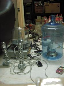

the idea came from building my very own sound sticks 2 (yes i enjoy making things, even stupid things)but i failed to find any suitable 'container' and the closest i can find in the junk yard on sunday is....
what does it looks like?
like this?
so i'm gonna make it look like a tube thingy instead of sound sticks, spray the top with metallic spray on the inside, make down firing sub....

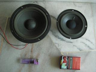

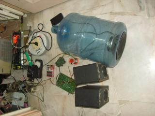

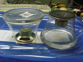

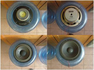

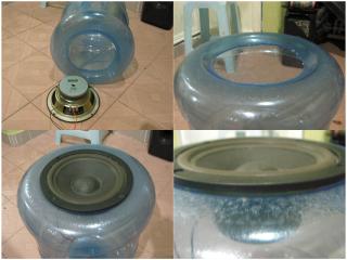

ok first i check the size of my spare woofer salvaged from the ton of altecs i keep for hobby/obsession?
ok this ones fits best.... =)
Attached Image Attached Image

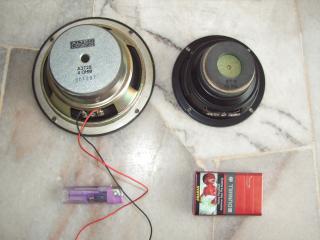

but this one fits into my other spare smaller woofy!!??

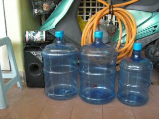

make big or small?
then should i put in 4.1 or 2.1? you want to help me pick later when i start making sats?

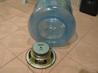

i'm gonna have to measure and cut the bottom of the bottle with a saw blade to fit woofy later
this should be cool, if i arrange the parts inside to looks like the innards of a tubey
ok stay tuned and give me some suggestions, ideas, moral or de-moral support =) because i'm gonna do it anyway since i bought the parts!

Will the bottle be hard enough to hold itself from the pressure of the subwoofer? Unless its like hard, though plastic i dont think its going to work? hmm.gif
Unless you reinforce the bottle and make it heavy.

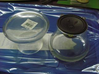

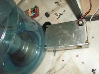

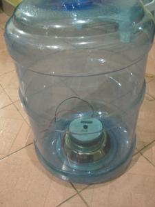

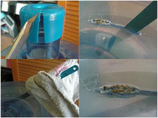

i straight away went to work cutting the bottle and i found out i couldn't cut it open with my small knife.. it was simply too thick
it was a pro because it would mean the bottle is 'strong' enough for bass
but pain in the ass to cut it open
so i went to heat up a nail over the stove and melted a portion of the bottle
the poke hot nail trick works... but it looks like an ugly mess, so i decided to saw it instead
i wrapped the bit with a cloth to keep my hands from self destruction =)
arrgh it was hard work with my puny bit and i wasn't getting round.... i'm going to my cousin's place later to borrow his jigsaw tool

as ghetto as that sounds, you probably would need to dampen the insides to prevent the ugly resonance at higher than usual bass frequencies. Stability is the least concern because objects have very different resonant frequencies and act very differently when subjected to high energy waves (ie: bass frequencies)
You can use metal and it'll still vibrate like crazzzzy.
wink.gif let this be a motivation so you will work on MDFs on your next project. They arent exactly expensive either so it fits the "on budget" diy theme.

you can always go get a dremel (aka mini wheel sander) to round off the uneven parts
make sure you use low speed,you don't want the plastic to melt and cover your sanding bit

Jigsaw might work, just use fine teeth blade. By all means BECAREFUL. You're working with mains operated power tools. Watch the fingers!

dremel might be a little over power for this XD jigsaw is a smart choice tho

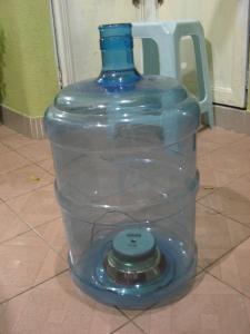

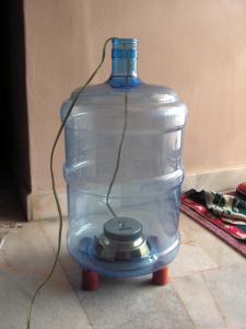

i kinda suck at this kind of thing... my advice is to go slow with the jigsaw, otherwise it will jam and the plastic will melt messy
which...i found out the hard way!
so here is my lousy handy work =)

using soldering iron to cut also helps, then finishing with sand paper on broom stick.

SUSbeggarmaster2000
post Sep 15 2010, 12:54 PM
1,254 posts
Joined: Aug 2009

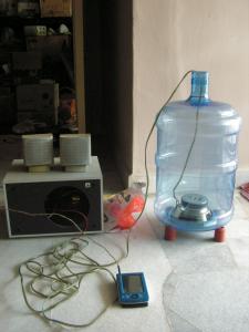

ok ok you guys are getting impatient =)
rush home!!!
lunch time....eating from a box in front of the crap i bought
the hot nail trick again for holes....
ugh imperfections....need to jig saw it down again...
soldered the cable directly into the mothership
on the power and blast.... hmmnn nice! not as bad as you guys described. just a little dance vibrate on MAX volume because the thingy not airtight and not heavy enough
vrooom vroom? no... n...sounds smooth rumble.... should be okay when i reinforce the base and dunk the components and transformer later.
i lazy to comment la i need to eat and go back to work so just look at pictures la!

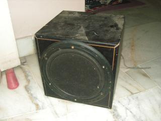

SUSbeggarmaster2000
post Sep 16 2010, 01:26 AM
1,254 posts
Joined: Aug 2009
i am flattered to be an inspiration for your ghetto mods =) and i am also looking forward to see yours as well =)

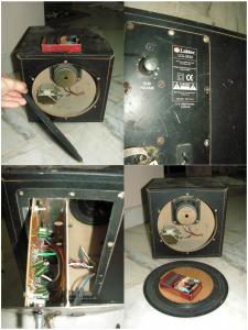

this was unit was from my secondary school experiment....
it had a fake woof lol
i was lousy modder back then, it didn't turn up as good
but i had my favourite tda7375 inside!!
you guys thinking what i'm thinking?

grrr i hate it when the manufacturer decidie to split the amp into a few pieces...now i need to 'simply-fly' the amp
but before all that i need to make sure if its still working.... i am also re-capping all the 'chang' beer caps
SUSbeggarmaster2000
post Sep 18 2010, 12:02 AM
1,254 posts
Joined: Aug 2009
i did not manage to buy aluminium shits to hold the crap together inside today =(
here comes the 'boring' part of banging up the amp
almost done hooking all the connections together,recapping and making it smaller...
need to clean the heat sink with solvents to get rid of the (original)thermal paste all over it and make it shiny again

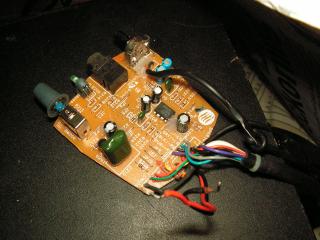

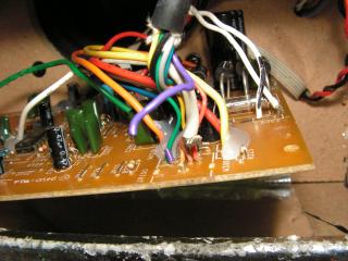

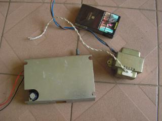

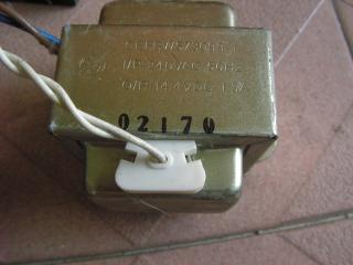

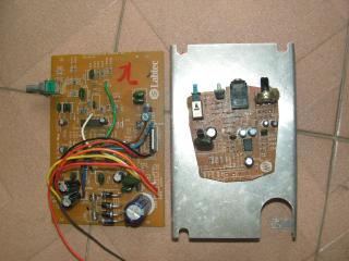

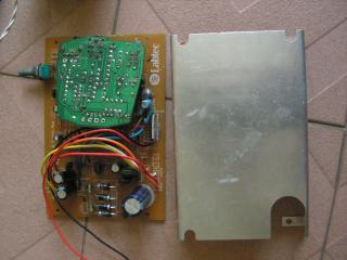

i spent a few hours yesterday trying to rewire something i dismantled years ago....
most of the caps, trace and components has gone bad....even the volume pot is dead
after 3 assemble, check, test later i got it back to good working condition...but it was already late at night. so i couldn't blast test it and my friends over the other end of the world is beckoning me to attend our raya mabook special

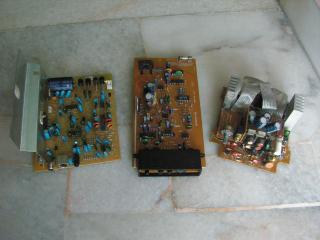

this morninh i woke up with a terrible hangover but i couldn't wait to test blast my labtec amp
i will not wire the thing up properly until i mount the components into the 'tube' later
WOW, the results was surprisingly clear, crispy and soomth. it was so unlike the old labtec set that it came from...
yes, the sub i made still vibrates a little and stuff. barely noticable dancing, just sounds a little off surprisingly for i haven't seal the leaking parts and reinforce the base.
overall performance at current state is like what you guys said... better than low and mid range stuff
hmmnn...next will be the satellites... i need some inspiration for design and material again...

SUSbeggarmaster2000
post Sep 19 2010, 09:34 PM
1,254 posts
Joined: Aug 2009
hehe i was thinking of shopping for sats on monday
QUOTE(rxy @ Sep 19 2010, 04:26 PM)
mixture of edifier and h/k ss..
it is actually a mixture of altec, labtec and i don't know what yet for sats
the one i use in picture is just for 'testing' purposes

ok guys.... i'm back from carefor.... are you ready to look at my new glass sats??
Najmods
post Sep 20 2010, 10:00 PM
*mutter mutter mutter mutter*
5,211 posts
Joined: Feb 2005
From: Konohana
Looks good but... its glass, how you gonna put the wires inside them to the driver? You can't just cut them like plastic

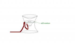

SUSbeggarmaster2000
post Sep 20 2010, 10:06 PM
1,254 posts
Joined: Aug 2009
i plan to do this if i can find the rest of the glass 'parts'
need 2 cave glass lens

if you want to purchase something very special to treat yourself or your loved ones, E1 - AKG has got some good deals for you!
the set i received from E1 - AKG is a little old, well used, well loved and the capacitors in it was dying (the left and right channel is not balanced, sound quality was a little inconsistent) but.........
WOW! its sounds so lively. a little more than i expected!
At the comfort of home, i can really hear what it sounds like because it isn't noisy like in the shopping mall.
this gave me a total new point of view to about building my very own SOUND SICKS hehehe
when it came to sound quality differences, i realized that i was building my sound sicks according to the regular 'computer multimedia' gaming configuration.
this event was a real eye opener and gave me better idea how to continue building my sound sicks
mmmmmm this can be considered my 'childhood toys' that i couldn't afford to buy then lol =)
