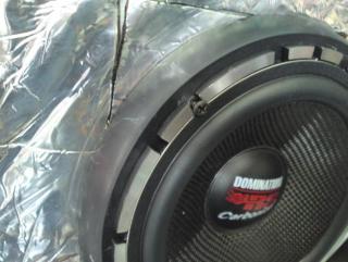

now, focus on the spk mounting area, door frame big size flex part and some soft metal part, we added some extra forced on it, which change the resonance frequency of the whole metal frame
Attached Image Attached Image
Get ready to install the speaker, before install the speaker, make sure waterproof shield had been done properly. Dun waste the money to buy new speaker just because of some small mistake.
Install spk now, the spk should be mount on a solid spacer but not directly on the metal frame. This baffle is to create enough pressure to press on the metal frame and spk and make them solid like 1 piece. a very important note to achieve good sound. In this case, rubber baffle used to enforce the dampening effect in order to reduce the vibration when the spk operating.

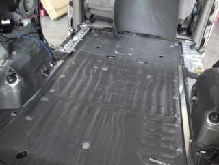

ESTIMA Floor deadening and sound + heat proof in extreme level
Car floor pan and mud guard is the noisiest part for road noise, tire noise and chassis vibration noise. To reduce these noise, we use oem material which provide the best dampening effect that looks original and cost effective.
This is the oem dampening material, the material was spray with body color to make it looks more neat and clean.
Now, we apply another layer on top of the current oem layer and any other parts which are not covered by oem dampening
This is the pic after the first piece had been done, looks original rite? except the color which are not important
In this extreme level deadening, reinforcement had been added to provide a stronger dampening effect by changing the whole floor resonance to multi-frequency type. (if only apply 1 layer on whole floor pan, the whole floor pan will having the same resonance frequency which create a peak in the noise coming thru the floor pan. It is not a good idea because it make your whole car become a big hall with lots of echo with that peak frequency)
the whole rear floor pan with the deadening applied

Add in a new produce called "Eseal", this product are made from very high quality rubber and it's even better quality than your oem rubber. see youtube video below for this product and some sample...
Installing Eseal will make your door slightly tight to close on the first few days, but this is minimal not like the cheapo version which will make your door hard to close before you sell the car away smile.gif
install of Eseal
effect of Eseal
a better pic on how dampening and spk baffle installed
a tweeter pod can hold the tweeter nice and firm...it reduce the chances of tweeter movement while using normal blue tack, resulted in more accurate focus and better staging and imaging
