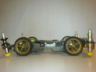

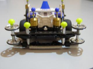

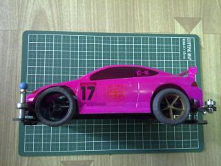

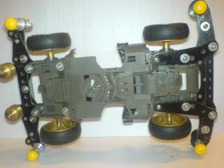

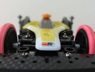

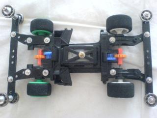

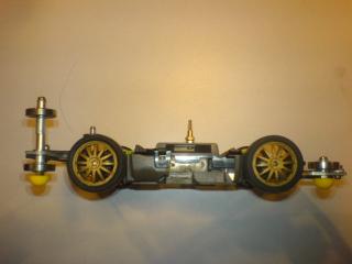

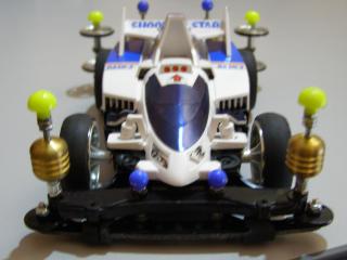

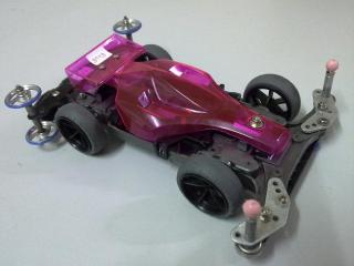

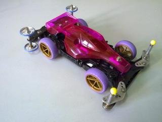

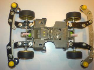

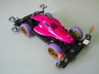

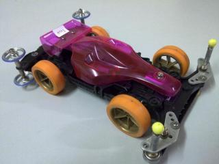

Guys can I ask your opinions, regarding my setup
- Front Rollers : 1 set 19mm Plastic Roller (Taken from Double Aluminum Roller Stay)
- Back Rollers : 2 set 19mm Aluminum Roller
- MS-L + Gold Plated Terminal
- N-03 + HG Carbon Reinforced FRP Wide Front Plate N-03 Unit
- T-03 + HG Carbon Reinforced FRP Wide rear Plate
- 620 Ball Bearing set on both Wheel set
- FW : One Way Large + Arch Tires
- BW : Large Dia + Arch Tires
- HDPro on 3.5 :1 gear set + SB on gears
I got problem with cornering, each time it comes to a corner my car always jump out of the tracks (thanks to it my MS-L smoke is broken cry.gif )
I've been thinking to replace the front rollers with either a Double Aluminum (13-12mm) or take 1 set of 19mm from my back rollers and put it on the front, or should I replace the plastic one with aluminum ?
I got 2 set of 9mm BB, but I planning to use it on my Double Roller Stay, or should I try to use it ?

>El Nath
should you upload some pic for us ??
btw, if you use bumperless... have you set some angle at the front??

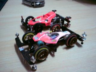

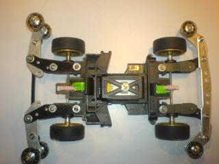

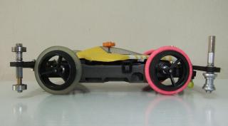

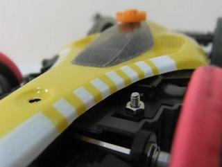

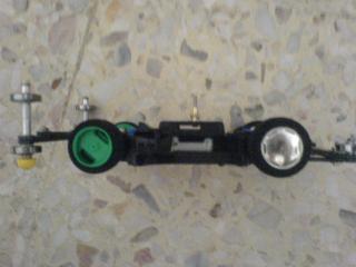

Ahh, I didn't set any angle on my Front Rollers because previously I have no problem with this setting
It just started to happening when I replaced 2 set of my back rollers (from 19mm to 14mm all plastic)
I thought by switching from plastic to Aluminum I can solve it, but it getting worse, and now 2 set of aluminum got deformed just by 3 runs cry.gif

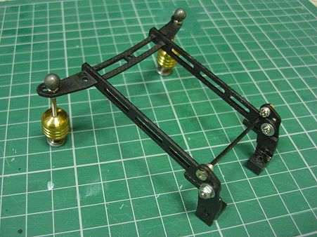

Btw this is my car (sorry for the LQ pics since i don't have a "real" camera with me now)

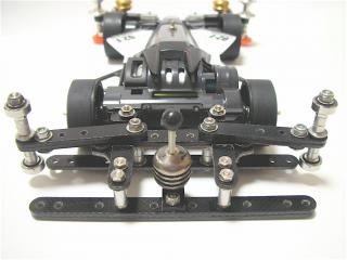

And since you're mentioning about setting some angles, could you tell me how can I make one with a bumperless ?

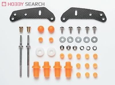

I got this angle setting (actually I ripped it off from my classic collection vol.1 tongue.gif ) should i use this ? or maybe you have some other way making those angles ?

The front part should be modified. If not, it looks just exactly as stock car, I mean the front rollers.

@El Nath: Use the orange gear from other chassis to replace the plastic ball for the front. Should be okay after that...

maybe can use the angle adjuster chip .

Thanks guys, I've made some modifications (using 5 degrees of angles)

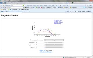

and can someone give me an explanation about the correlations between roller's angles and cornering ?
so i can calculate and decide on how much angles do i need to make in order not to jump out of the tracks

fuh macam profesor pulak nak calculate macam macam
anywayz just test on the track, start from normal angle (normal bumper got angle right...) and just keep adding more angle to the roller IF necessary.
the angle creates down thrust for the car. the angle sorts of pushes down the car on the track, like f1 spoiler lah. most of the time normal angle is good enough.
Ahh so it's something to do with drown thrust, and it's trial and error then when setting up an angle, right ?
because the angle chips I have, has something like 5-10-15 degrees written on it.

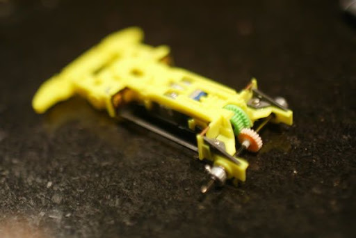

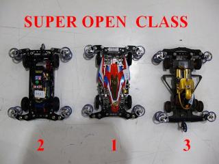

for MS... can refer this:

omg i see a lowered super x...... i just came
for some old times memories sake, the pejuang VS decides to show his secret weapons last time...

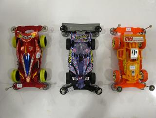

the orange VS chassis look very nice~~!!!!!!

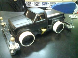

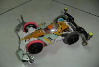

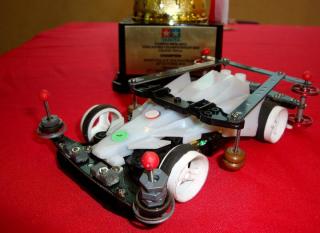

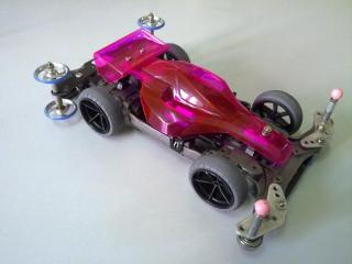

Hi, im relatively new to mini 4wd. Used to love it as a kid and now I'm trying to make a more competitive comeback.
I just went to the HK race the other day and realized how slow I was compared to everyone.
I have two questions though.
How do you reduce friction when going through turns, and
How do I make my motor churn out more power because I was using the same motor as everyone else and my car was at least 5 seconds slower than everyone.
Here is my car:
This post has been edited by jayrlo: Jun 22 2010, 03:06 AM
david tamiya
post Jun 22 2010, 03:10 AM
64 posts
Joined: Jun 2006
From: Hong kong
QUOTE(jayrlo @ Jun 22 2010, 03:05 AM)
Here is my car:
try to clean your bearings
take out that sliding bumper at the rear and you will be faster than before
u can also look for kenjian to ask about car setting by the way he is my friend and a hk racer
will be having ah ma from hkm4a to race here this sat too
jayrlo
post Jun 22 2010, 03:37 AM
Joined: Jun 2010
Thanks so much David! I'm going to try that right now.
I thought using the sliding bumper would help me be faster on turns.
I was also wondering why my cars power didn't seem as fast compared to everyone elses. 5 seconds is a lot of time even thought I'm still relatively new. And I was 10 seconds off from the winner too. Average was about 22 seconds and I had 27.
Would it be the battery?
david tamiya
post Jun 22 2010, 04:39 AM
64 posts
Joined: Jun 2006
From: Hong kong
QUOTE(jayrlo @ Jun 22 2010, 03:37 AM)
try the 2 thing i mention first see what u got then go on from there
szngszng
post Jun 22 2010, 04:46 AM
Joined: Apr 2009
From: uptown, pj
btw, too many extra reinforcement on the car....

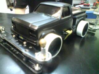

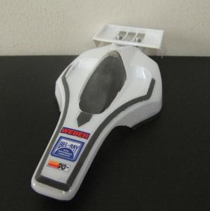

TSsonic_cd
post Jun 23 2010, 11:43 PM
Friendship Is Magic
19,042 posts
From: Soleanna

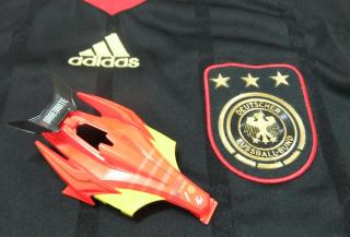

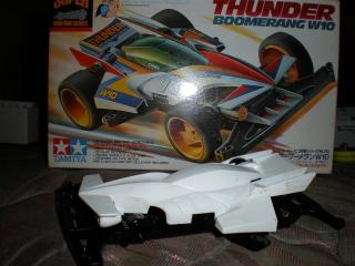

QUOTE(lolhalol @ Jun 23 2010, 11:12 PM)
szngszng
post Jun 23 2010, 11:54 PM
Joined: Apr 2009
From: uptown, pj
good 1... i like this~~~hahaha... only see the cover... pls ... do show out!!!
lolhalol
post Jun 24 2010, 12:39 AM
Showroom Skateboarding
1,823 posts
Joined: Mar 2006
QUOTE(sonic_cd @ Jun 24 2010, 12:43 AM)
hahah.. should have some sort of epic music playing with the picture.. lol..

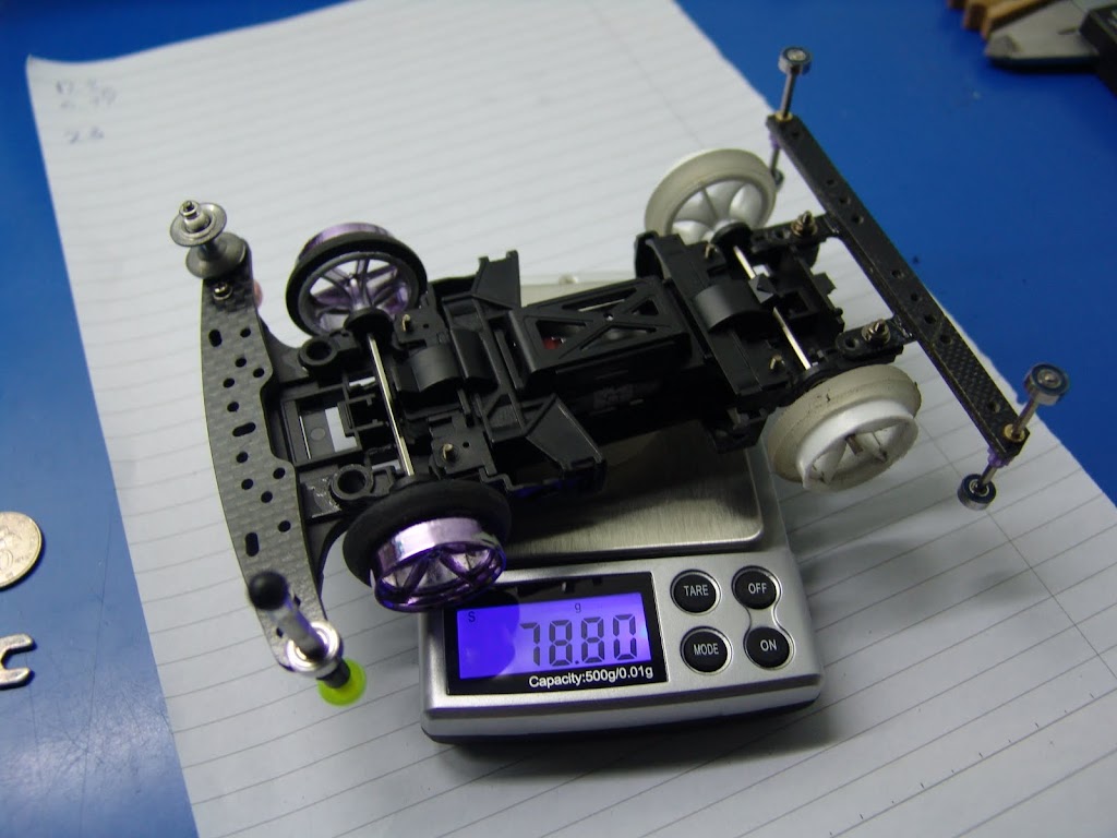

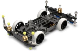

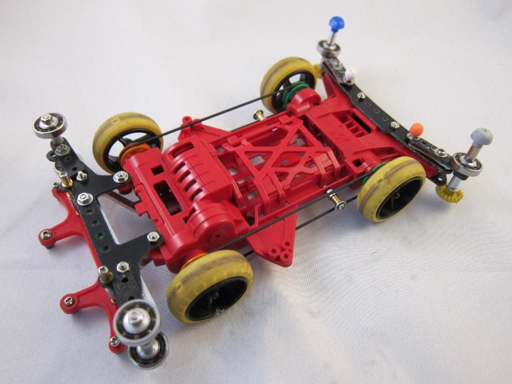

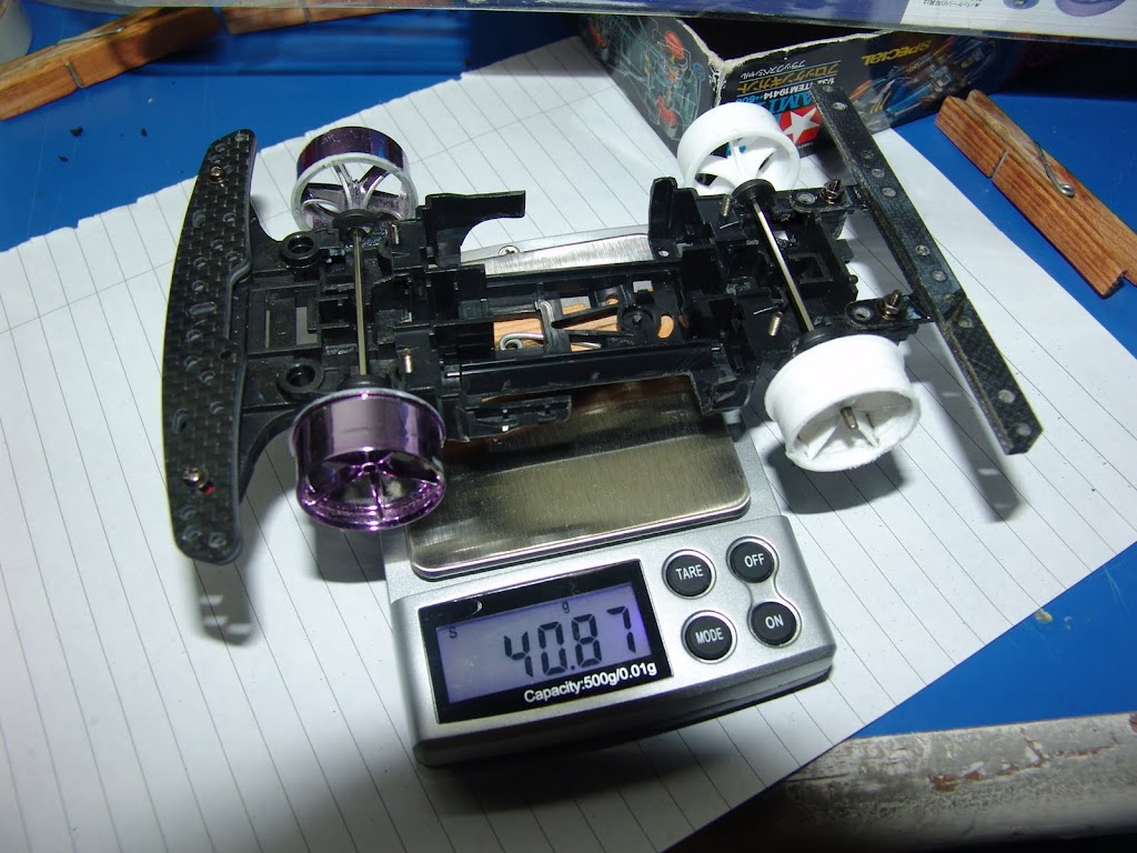

A Newbie Creation.
This is my first MS Pro FRP car attempt.
All comment and suggestion are much appreciated
szngszng
post Jun 24 2010, 02:33 PM
Joined: Apr 2009
From: uptown, pj
if the front and rear reverse... that will be good....
can said the front can't stand in the track...because it too soft...
maybe try to remain the original front bumper....

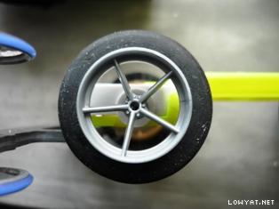

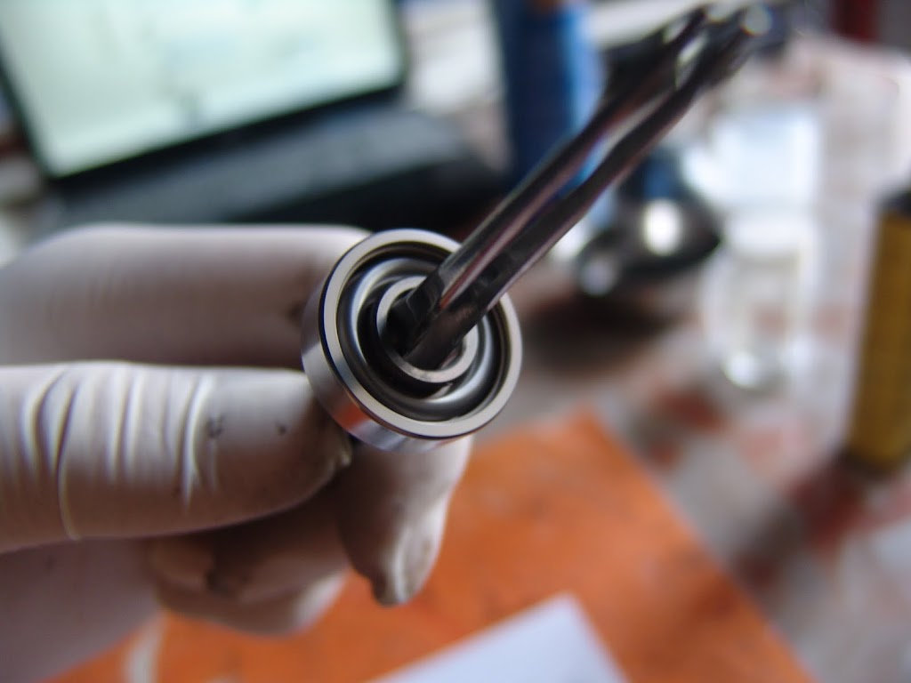

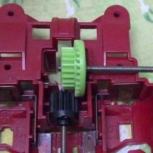

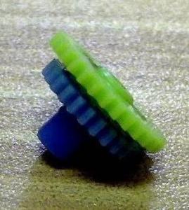

Added on June 24, 2010, 2:47 pmbtw, newly design MS pro gear 950+520+520 ball bearing
addition mirror surface which polished with tag paper...
the end product and some of it's parts....

QUOTE(K2002 @ Jun 24 2010, 01:06 PM)
A Newbie Creation.
your car sure goyang-goyang...the tyre a bit not flat also can goyang-goyang edy sweat.gif

ok la preview to u guys abit abit. Stormtrooper car
what a very slow car......

QUOTE(LanEVOchris @ Jun 25 2010, 07:28 PM)
i is takut , have not finish my car . see

QUOTE(sonic_cd @ Jun 25 2010, 10:28 PM)
i iz more takutz, car havent even put on rollers and motor... tonight no needa sleep lah

using this car , i will

-=conselfa=-
post Jun 26 2010, 12:08 PM
Joined: May 2009
From: 12min to go 1utama..10min to go The Curve
this is mine...huhu
Beans
post Jun 26 2010, 01:49 PM
Joined: Mar 2010
QUOTE(-=conselfa=- @ Jun 26 2010, 12:08 PM)
this is mine...huhu
I think the front rollers are too back...I think the metal extension will hit the track side first while cornering...^0^
This post has been edited by Beans: Jun 26 2010, 01:52 PM
LanEVOchris
post Jun 26 2010, 07:00 PM
861 posts
Joined: Oct 2005
QUOTE(Beans @ Jun 26 2010, 01:49 PM)
You think only, but he won second already. So what everything you think was wrong...
kthxbai
Beans
post Jun 26 2010, 08:38 PM
Joined: Mar 2010
QUOTE(LanEVOchris @ Jun 26 2010, 07:00 PM)
kthxbai
ok lo........mistakenly concluded

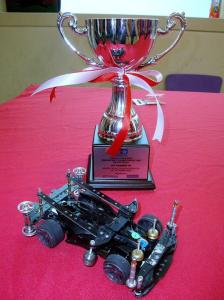

Joined: May 2009

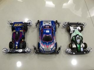

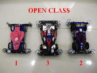

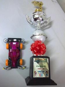

Kudos and thanks to all racers at TU juz now..sorry i gotta back early..balik kampung tonite with bus at 10pm..
really enjoyed myself , even though i'm not really good with VS. still a newbie and need to learn more from others. smile.gif
2nd place is good enuf for me..
later i'll upload other pics..here is my car setup during racing ..

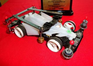

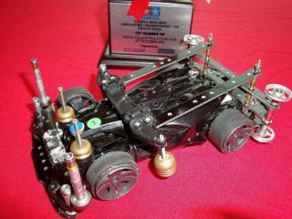

hi guys... greetings from singapore...
i was really looking forward to be in TU yesterday... dah buat plan semua... kereta pon dah setup... abih tu last minute boss suruh pegi meeting saturday morning... hancur harapan nak visit and race kat TU...
anyways... singapore having our own race the next day... today... sunday 27 june... so... aku share lah sikit gambar race kat singapore hari ni...
lane change lepas 8 straight macam bulan lepas tu ada lagik... for open chassis racers... kat singapore ada dua category - ms pro & open (untuk semua chassis except pro) categories...
and sandpaper kat track pun ada...
cheers semua racer dari malaysia... maybe bulan depan kita try gi TU ok...!!!

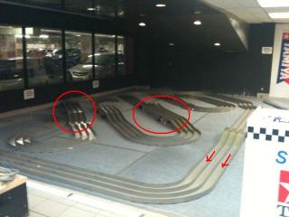

post Jun 28 2010, 01:06 AM
1,823 posts
Joined: Mar 2006
can some one share some info about the sandpaper on track? is it meant to scrape something off or provide un even surface ?

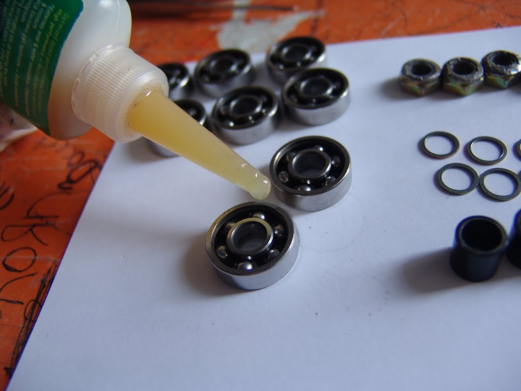

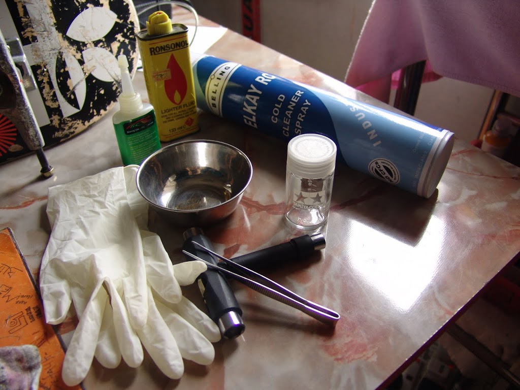

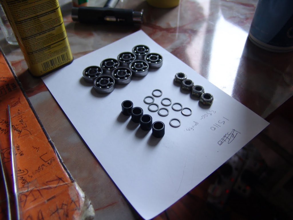

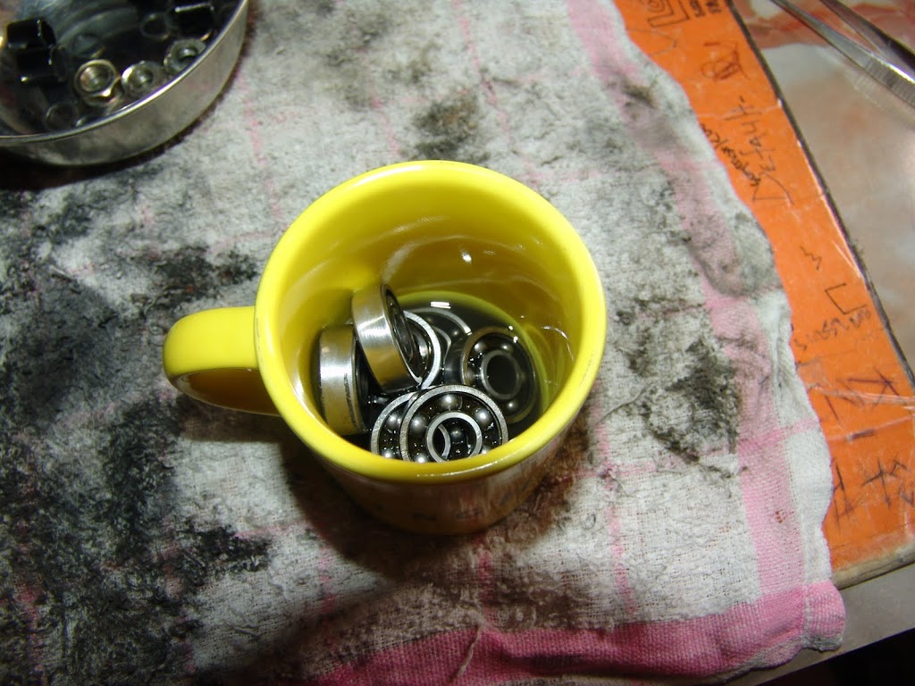

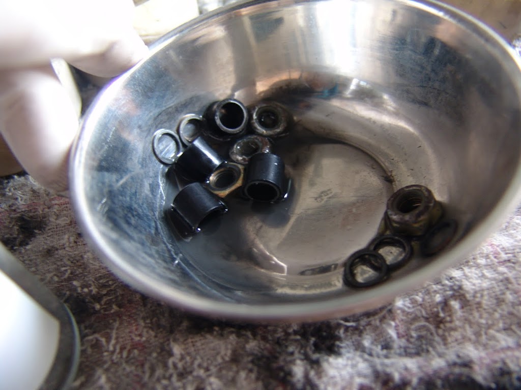

David, thank you so much for your advice last time. And Szng too.
My car went so much faster, it was rather scary to be honest. I cleaned out my bearings and I took out the sliding damper and poof. So much better.
I was wondering. Now that the performance of the parts are better, how do I bring out the best in my motor?

post Jun 28 2010, 01:20 AM
1,823 posts
Joined: Mar 2006
QUOTE(david tamiya @ Jun 28 2010, 02:09 AM)
decoration lol
haha seems soo..last time they put after a hump so landing on it will scrape brakes off .. iirc this time on the straights. haha.. confuse..

QUOTE(jayrlo @ Jun 28 2010, 01:10 AM)
try play around with diff types of bearings first and see what results it made
u can try 830 , 950 . 8-9mm wa ,12-13mm wa 19mm
try playing with roller positioning
and i think those are the basic stuff that you need to master before going to more complicated things as bringing out the potential of the motor
the cover also plays a big part in speed and stability
so there are many things for you to try out and study
try to make notes of the changes that you make to your car and the outcome of doing so
then maybe a problem arise you will know how to solve it by looking at the notes that you have made
trail and error is very important
your skill will grow from there and you can be better

szngszng
post Jun 28 2010, 07:56 AM
Joined: Apr 2009
From: uptown, pj
front, 3 layers of paper tag for decreasing the angle, front brake applied to decrease the speel for up slope and absorb the impact when down slope.
rear, HG front wing to extend roller position more backward + 830 AO bearing. almost most of the screw space use to provide better stability on cornering.
the rear roller actually absorbed most of the force, until the screw getting hardly bended. that's the reason when i am racing with yayah... the screw getting loosed.
a gutter opened to softer the tire wall...this is the steering system i try to apply for mini 4wd since last few cars.
front wheel gutter
rear wheel gutter
2 layers of paper tag inserted into the back of the motor terminal, thus to ensure the conductivity...
previously i tried to use 8-9double roller and 830 roller to decrease the weight, however, 12-13 provide more stability and faster corner for my car, so, end up i use heavier double roller for racing...bigger roller has the advantage that crossing the joints of track...
lateral force theory for tire, also refer:
http://www.dinamoto.it/DINAMOTO/8_on-line_...s_eng/Tires.htm
this is the CG of the car at the front and rear, CG not only exist at up and down, it also exist at front and rear... roller position will decided the CG and it have a lot of cross relationship with tire and force absorbed by the front and rear... that's why you see the car moving forward but the rear screw bending....
might discuss further more in future...anyhow, those are my basic understanding on my mini 4wd, you might have better ideas and knowledge, please share and we grown together~ smile.gif
This post has been edited by szngszng: Jun 28 2010, 07:57 AM

post Jun 28 2010, 09:31 AM
Joined: Aug 2009
QUOTE(lolhalol @ Jun 28 2010, 01:20 AM)
Added on June 28, 2010, 1:21 amanyway .. to those supporting england.. too bad.. hahah .. germany was too good in front of goal.. unlucky for lampard though. refree blind.
the humps before were really challenging... not so easy to clear... especially if they put 2 or 3 of them in a row... i recall there was one race last year that there were 3 hums in a row along a stretch of straights... most cars can clear two humps in one jump but fail at the third... and yes... they wear out the brakes easily...
the sandpaper... they used to put it on top of a jump... up-ramp - straight-with-sandpaper - down-ramp... so it doesnt make any difference since most cars will just jump over the straight...
now they have two straights with sandpaper flat on the ground... it really wears off your tyres... i think i will have to change my set of tyres after yesterday's race...
stargek singapore also have straight sections with artificial grass, ice cream sticks... wont be surprised one day they will use them... rclxub.gif

still have pictures of the top 3 or so cars which was taken apart after the race . tongue.gif

QUOTE(choycp @ Jun 28 2010, 04:58 PM)
aku dah kembali ke jalan yang benar
btw sonic, post up the pics of the top 3
coming right up

QUOTE(choycp @ Jun 28 2010, 05:58 PM)
sexyyyyyy ms pro there man.. hehehe
TSsonic_cd

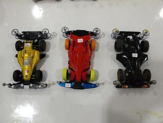

post Jun 28 2010, 09:00 PM

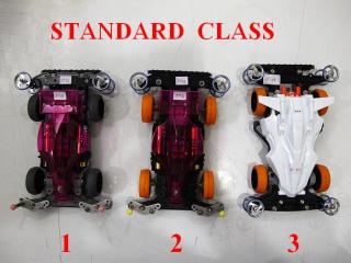

Friendship Is Magic
19,042 posts
From: Soleanna
forgot the other wan ;sweat:
This post has been edited by sonic_cd: Jun 28 2010, 09:12 PM
LanEVOchris
post Jun 28 2010, 09:34 PM
861 posts
Joined: Oct 2005
it all depends on the builder also, not only chassis.
I saw lots of guys with modified gearbox, ex large diameter tires and cut chassis to the max, but didnt make it to qualifying. Mine was 100% stock standard out of box and plastic bag car, but built with care. Will post up a small 'how to prepare race car' tutorial by tonight hopefully to share with newbies...

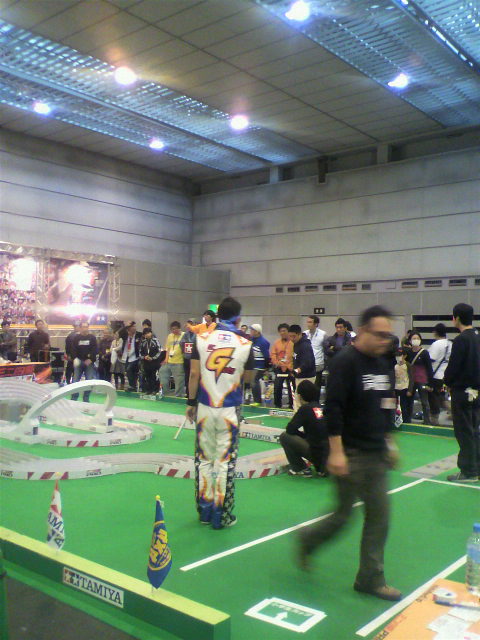

Added on June 29, 2010, 12:53 amas proof. haha see pro racer all wear short and sneekers
Added on June 29, 2010, 12:54 amexcept doty. but he didnt join race so no need. haha

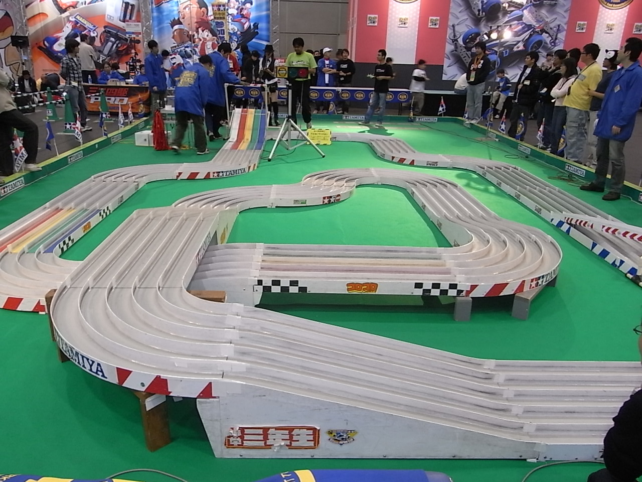

HK racer--- MA has upload race vid and pic... have a look at here: biggrin.gif
http://www.hkm4a.com/forum/viewthread.php?...&extra=page%3D1
http://www.youtube.com/user/hkm4a#p/u/1/xp5ceaL5evg

Added on June 29, 2010, 5:58 pmuser posted image bling bling

QUOTE(lolhalol @ Jun 29 2010, 04:41 PM)

long time didn't join forum. still mod my frame

can anyone post pics of the latest track layout?? thanks!!
** still don't have time to upload vids n pics..i'll try to do it 2nite..

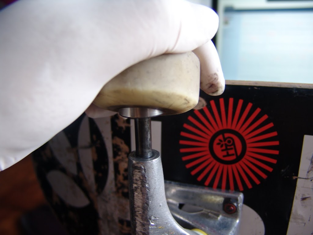

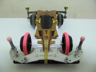

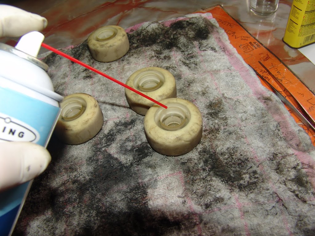

alan85
post Jul 1 2010, 10:47 AM
138 posts
QUOTE(szngszng @ Jul 1 2010, 08:01 AM)

hehe nice pic ng.. i see something very interesting in the way he mount his front and rear bumper.

shacz
post Jul 1 2010, 08:07 PM
44 posts
Joined: Feb 2010

Welcome shacz!
is that your current setup or 8 years back? bcoz we are played FULL TAMIYA mini4wd cars and spare parts here.
non-tamiya parts can be identified there based on your pics.

this is my old setup.. it is ori tamiya..bought at toyrus long time ago...planning to get new tamiya chassis n start playing tamiya again... =)

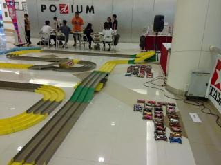

some pics taken during Speed race 28th June 2010 can be viewed here..
http://www.facebook.com/photo.php?pid=1282...120365394675540
p/s: most of the racers here at TU are focusing on MS PRO.. we did use old chassis like VS, super X, FM, super 1 but kadang2 lah.... (depend on track layout)
ToMatoK_eju

Japan Grandprix is back it's having a same type of track layout like us do this month
Mini4 GrandPrix - 4th heat in Kawasaki - Result:
1st place:
2nd place:
3rd place:
TA best result: 26.74sec
it's about 8.28m/sec by using rechargeable batts+automic tuned motor... what a great result~~
btw, more photos and data/if you can't view the pic, may also try below link~~ enjoy~:
http://mini4gp.web.fc2.com/

similar race can be done so how many guys u can get to commit to this project mr ng

well.... i don't know how many persons willing to commit to this project...their tracks amount is double what we use in TU...

track is not a problem
we got abang bunga

hmmm.. all using sotong tires... wonder got a car using normal tire or not . lol
-=conselfa=-
post Jul 4 2010, 09:39 AM
Joined: May 2009
QUOTE(sonic_cd @ Jul 4 2010, 05:01 AM)
sotong tires are defenitely for speed. look at all top 3 winners there.huhu.
it all depends on how good/precise we make dat tires actually matters. hmm.gif
anybody got machine to cut2 tires into super-precise-sotong tire?share-share lah...hehehe

mior, and its 4 rollers set up!. had thinking bout it, but never berani to try.

well to do all the cars you need a lot of trail and errors
same as the tires you keep cutting till you get it right
these setups are not as easy as it seams
hard work
dedication
concentration
never say die
and the most important of all is discipline
so for the guys who is interested in ng project please be prepared
4 rollers setting..argh! those pics are really good indeed..can study a lot!

the first place car is a amazing work of art .. must be dam light also.. i see even the roller poles are hollow shafts..
-=conselfa=-
post Jul 4 2010, 08:26 PM
Joined: May 2009
QUOTE(lolhalol @ Jul 4 2010, 08:11 PM)
yup..but izzit strong enough to handle the impact during hi speed cornering? i bet it can but not so long ar...

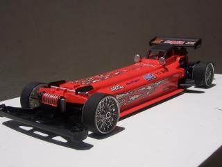

post Jul 6 2010, 12:37 AM
Joined: Apr 2009
From: uptown, pj
my test car... copy from david's ver. some of the parts also dig from david's rubbish dump biggrin.gif

QUOTE(szngszng @ Jul 6 2010, 12:37 AM)
-=conselfa=-
post Jul 6 2010, 12:48 AM
Joined: May 2009
szngszng
post Jul 6 2010, 12:51 AM
Joined: Apr 2009
From: uptown, pj
QUOTE(david tamiya @ Jul 6 2010, 12:40 AM)
tongue.gif tongue.gif sure~~hehehe...still got 1 frp... 1 chassis... 2 9mm double rollers...
QUOTE(-=conselfa=- @ Jul 6 2010, 12:48 AM)
later test 1st, then decide where to place the damper...
Added on July 6, 2010, 2:53 amhuhu... btw, the car not even got a motor... i juz simply plug those parts together that i saw on the box... all my part messed together....tomorrow might take some time to repack all the parts and tools ~~~
This post has been edited by szngszng: Jul 6 2010, 02:53 AM

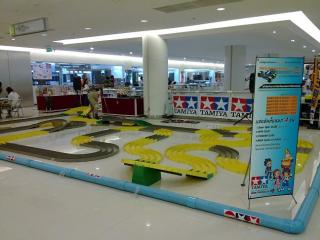

mint~tamiya
post Jul 6 2010, 02:19 PM
Joined: Jul 2010
This is my car. The racing version of the standard.

choycp
post Jul 6 2010, 02:49 PM
7 posts
Joined: Aug 2009
nice japan spec setup bro. looks like a speed track car

post Jul 6 2010, 03:19 PM
Joined: Jul 2010
QUOTE(choycp @ Jul 6 2010, 02:49 PM)
Yes it is.
Most race tracks in Thailand is high speed.

post Jul 6 2010, 04:38 PM
Friendship Is Magic
19,042 posts
From: Soleanna
i see a gap in the track .... looks interesting .
OsamaBinLaden
post Jul 6 2010, 06:00 PM
Joined: Aug 2009
for anyone who may be interested to see... this is my set-up for the singapore race on 27 june 2010... third placing...
david tamiya
post Jul 6 2010, 06:33 PM
64 posts
Joined: Jun 2006
From: Hong kong
not tamiya legal lol
