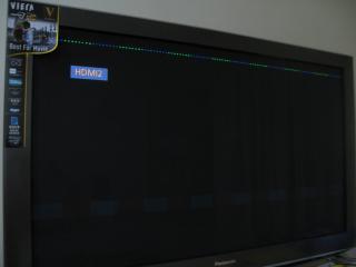

Hope I am posting at the right thread.
Bought Pana Plasma 42' about 6 month ago and it is a "V" series.
It was OK all this while and when we just came back from holidays (5 days) this is what appearing in my TV.
Any advise will be greatly appreciated.

QUOTE(Jenn77 @ Nov 30 2010, 08:42 AM)
Hey this happened to my unit too! The line appeared was below not above! Then after that I on off the TV its gone edi.. yours permanent?  doh.gif  I tot it was my TVIX but kacau..
Lucky you, yours disappeared but mine it is still there.
If you can see my attachment there are two horizontal lines, one at the top (blue and green) and the other one near to bottom (more like a bar) which is in red and black. Will be calling Pana service tomorrow.
Those are the days Panasonic/National gave us long lasting product. My Pana Fridge repaired twice and now the TV...sigh sad.gif

QUOTE(PoorMan @ Nov 30 2010, 08:28 PM)
Are the lines still there after you try changing the AV input?
Changed the cables but problem still exist.
W.ROOK
post Dec 1 2010, 12:56 AM
982 posts
Joined: Apr 2008
QUOTE(neb @ Nov 30 2010, 09:54 PM)
probably lightning strike fry internal electronics, next time unplug everything for the holiday, but don't tell panasonic, just proceed to claim your warranty
Yeah I've unplug all before go on holiday.
Added on December 1, 2010, 12:58 am
QUOTE(terranova @ Nov 30 2010, 10:21 PM)
@ rook - try another hdmi input socket on the tv.
Tried and it did not work.
Added on December 1, 2010, 1:01 am
QUOTE(kevinc66 @ Dec 1 2010, 12:08 AM)
complaint to Panasonic, no guessing. Could be striked by lightning and panel problem.
Added on December 1, 2010, 12:10 amhappened to a couple of LCD before and turned out to be panel problem...Some are vertical and some are horizontal lines..
Will just do that and see what they have to say about it.
This post has been edited by W.ROOK: Dec 1 2010, 01:01 AM

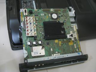

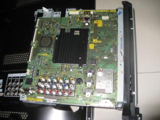

W.ROOK
post Dec 7 2010, 12:25 PM
982 posts
Joined: Apr 2008
QUOTE(Jenn77 @ Dec 4 2010, 11:34 AM)
I bliv so.. its got to do with HDMI cable.. now my unit seems ok. Using the cheapo HDMI cable from Tesco.
It got nothing to do with HDMI cable or even speakers beside the TV but the A board kong already.
The Pana guys came and changed the board.
Noticed that the screen was manufactured in Japan, the unit was assembled in Singapore and the A board came from Vietnam.
Probably I could be the unlucky one to get the defect batch of A board.
According to the service guy I'm not the first one but in fact others had the same issue too. So Plasma owners be .............heheheee
Attached Image Attached Image
