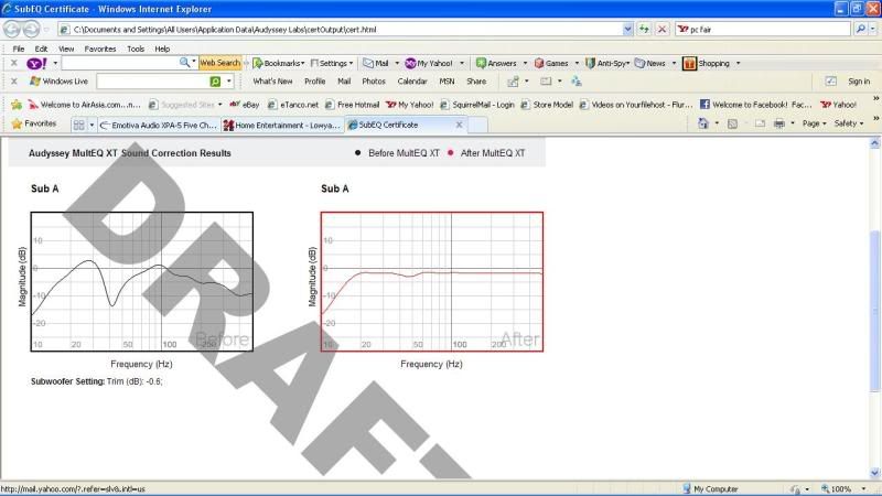

Mine :
Room size : 10' x 20' (bad room size)
Minimal acoustic treatment with absorption panels and book shelf at the back as diffusor. No bass traps.

ar188
post Sep 29 2009, 10:56 AM
9,206 posts
Joined: Jun 2006
what's the red and black line (before /after?)
hsiengloong
post Sep 29 2009, 11:01 AM
~Bass Maniac~
899 posts
Joined: Feb 2005
From: Sumwhere
Bro, how come there's a dip at the 48hz range? I believe svs eq1 can help even this out? Maybe you can post a graph pre and post audyssey MultiEQ (using ur denon) and pre and post SVS eq1.
If its not too time consuming tongue.gif Then it will give us laymen a better idea of the true power of ur beast

TShtkaki
post Sep 29 2009, 11:16 AM
Maxx Audio Visual
14,193 posts
Joined: May 2005
From: Sbn / KL
Here's the AS-EQ1 :
hsiengloong
post Sep 29 2009, 11:19 AM
~Bass Maniac~
899 posts
Joined: Feb 2005
From: Sumwhere
Impressive... is this the graph of your sub??
Also i am wondering if this is just before and after calibrating usign SVS eq1? No other calibration done? If yes, this gadget is working magic..
TShtkaki
post Sep 29 2009, 11:29 AM
Maxx Audio Visual
14,193 posts
Joined: May 2005
From: Sbn / KL
Jz done the AS-EQ1. I have yet to use 4310 to run Audyysey, which is recommended by most of the avs forummers.
Yes, it is indeed impressive. Here's the review :
http://www.audioholics.com/reviews/acousti...s-as-eq1-sub-eq

QUOTE(htkaki @ Sep 29 2009, 11:16 AM)
Here's the AS-EQ1 :
Looking at your graph again, I think the limit of the EQ1's boost is around +10 dB, which is quite good. Some other devices might be limited to +6 dB or less.
Also, can you check with SVS if the EQ1 equalizes below 20 Hz? I notice the portion below 20 Hz looks about the same as the 'before'. Previously I did ask on AVS if MultEQ XT equalizes below 20 Hz but didn't get any definite answer.

QUOTE(jchong @ Sep 29 2009, 03:55 PM)
I suspect it could be the ugly room nodes since my room dimension s**ks (10' x 20'). But, I will also ask Ed abt the questions that you raised to double confirm

The graph is quite good considering that it is being done via Auto EQ and SR6003.
jchong,
I have got the answers :
Q1. The dip at 40Hz (must be room nodes) was being rectified to a certain extent; +10dB.
A1 : Yes, it's a room mode. Please try to move the listening position forward or rearward. This is an axial mode and you should be able to move out of it within 2-3 feet in either direction.
Q2: Is there a limit that the AS-EEQ1 can boost; like around 10 dB. Some other devices are very limited to below 6 dB or less.
A2 : Yes, there is a limit; it's 9 dB.
Q3: Does AS-EQ1 equalizes below 20 Hz? I notice the portion below 20 Hz looks about the same as the 'before'. If yes, then what could be the reason of this graph.
A3: Yes, the AS-EQ1 will equalize to 6 Hz with the current firmware/software. Make sure to set your room gain control to Bypass. Also make sure any THX Ultra II boundary gain compensation is set to off/no, and all your speakers are set to Small with 60 Hz for the mains, and 80 Hz for all others. Something else is causing a premature roll-off from 20-15 Hz. The subwoofer should be flat to 15 Hz before roll-off. Move the listening position and try it again.
On the above, I did wrongly set my speakers doh.gif since the front is being set as full range (Large) and 40Hz for center and 60Hz for surr. Lesson learned blush.gif

QUOTE(htkaki @ Sep 29 2009, 10:13 PM)
jchong,
AS-EQ1 really looks like a class act. I believe more so for people trying to equalize 2 subs..

I will do the calibration againto see how the new FR graph will look like. Hopefully that we can see a FR graph of 2 diff makes & models by Sunday.

gocitygo
post Oct 11 2009, 10:18 PM
397 posts
Joined: Mar 2008
fuyoh drool.gif Audyssey damn powerfullllll
anyone done the full range measurement before/after Audyssey? perhaps can post the graph for us to 'tai hoi gan kai' rclxms.gif rclxms.gif rclxms.gif rclxms.gif

TShtkaki
post Oct 11 2009, 10:58 PM
Maxx Audio Visual
14,193 posts
Joined: May 2005
From: Sbn / KL
Waiting anfieldude to come over in few weeks time. I will disengage EQ1 to get 'before' reading and then engage it to have a look at the near flat curve.

Mine :
This post has been edited by htkaki: Nov 13 2009, 12:37 AM

I am curious to know how does my demo room performs and how well does AS-EQ1 helps.
