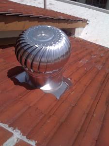

Turbine vents... those are the spinning type...
Or if you have the money you can install a fan driven ventilator...
edit:
As for brands I've come across mostly generic...
Here is a tip pick one with self lubricating bearings because after some time turbine might squeak and drive you nuts on windy nights... tongue.gif
The other thing is to make sure your place is fairly windy, if the air is mostly still then turbines don’t work at peak efficiency…

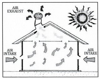

Those ventilations create dust after installing . My house have those type too. It is now sealed completely because a few screws came off and the dust keep falling on to our furnitures.
Better look for other types of ventilations. Luckily I haven't seen any rats falling down from the hole as one of them is just right above my bed. Fuuh!!

Bunnyhoney, your room is directly below the roof tiles? There is no ceiling between the roof tiles and your room? Or is there any ducting?
Other types of ventilation I could think of are:-
1) Normal eletric wall mounted ventilation fan
2) Ventilation tiles

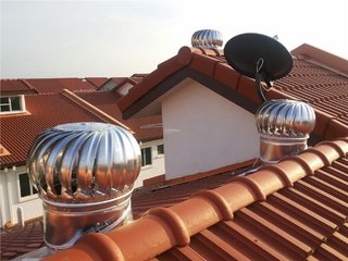

several type exist..
1)residential/commercial/industrial
2) size-12"; 14" 16"
price for 14" residential about 160

160? Are you refer to the Ventilation fan like Kitchen / Toilet type or the Turbine vents type?

But the price is RM160???
I saw on market normally was RM700plus.

maybe 160 for turbine only? 700 come with installation & material?

I just installed it yesterday.. I installed 2 roof ventilators, 16", free floating type. It cost me rm648 each (the sales guy said, it's promotion price after rm200 discount.. but I believe everybody gets around this price).
My 2nd floor, even without the ventilator, it is not hot anyway because my house got airwell.. very high. I installed it so that the bedrooms are not hot during night, and I'm hoping it will be as cold as the outside night temperature.
After install it, I found that, IN THE MORNING, the room is still not as cold the outside. However, I no longer feel the trapped heat in the room like before. At noon, it's like i can work all day long, with all doors and windows open and without turning on the fan.. (bear in mind, even without vent, my 2nd floor is already not that hot due to airwell but I still need to turn on the fan).
Attic temperature : The different is like night and day. I used to go to attic to fix some wiring or check my water tank. Usually, after 5 minutes, I already sweat. But after installing this, it's no longer hot and it's bright in there as the sunlight can go in through the vent. However, this is not important. What important is the bedrooms' temperature below it.
Please note, each vent can cover 500 square feet area. I installed 2, so, they effectively covers 1000 square feet, and my roof area from my calculation based on the floor plan, is just 630 square feet. So, the vents are already optimum.
Overall, I'd say I feel the different. Maybe because the heat trapped on the ceiling has a way to go out. but it won't make the room cold.. as cold as the fan or aircond.
My suggestion, if you got money to renovate, first thing before putting ventilators or roof insulations.. make sure you build the airwell first. I rented a 2 story house before and got no airwell. I can't go up to the 2nd floor during the day at all..
Airwell (for those who don't know what is airwell) as seen from inside the house. Usually located above stairs or family room.
This post has been edited by zeese: Aug 4 2011, 09:26 AM
JinXXX
post Aug 4 2011, 09:11 AM
2,516 posts
Joined: Feb 2007
From: Uarla Umpur
QUOTE(zeese @ Aug 4 2011, 09:06 AM)
i think you just nailed the point.. the turbine ventilator is to remove the heat from the attic/roof thus reducing the radiant heat that can radiate down into the bedroom and etc smile.gif
Jo_da48
post Aug 6 2011, 11:41 PM
1,529 posts
Joined: Feb 2011
From: PJ
Done in place two unit of ventilation this morning, and take them less than 1 hour included removed off the roof alumimum foil and zink.
Unfortunated cant take picture as not visiable from front or backend as it blocked by my extention block...
Only picture taken are from inside to roof top
JinXXX
post Aug 7 2011, 11:32 AM
2,516 posts
Joined: Feb 2007
From: Uarla Umpur
QUOTE(Jo_da48 @ Aug 6 2011, 11:41 PM)
thanks for sharing, your roof is using metal sheets and not those cement/clay roof tiles ?

Jo_da48
post Aug 27 2011, 06:00 PM
1,529 posts
Joined: Feb 2011
From: PJ
Finally up to the roof to checked my roof leaking issues as the Indo contractor only free / available after Raya.
Hence able to take photo of my ventilator...
JinXXX
post Aug 27 2011, 06:13 PM
2,516 posts
Joined: Feb 2007
From: Uarla Umpur
QUOTE(Jo_da48 @ Aug 27 2011, 06:00 PM)
thats nice/good of you to share thanks alot..
what you mean check for leaking issues.. meaning its leaking ? or just saja check see ?
they installed it properly ? got any leak so far ?
Jo_da48

I have ceiling ventilator fans in all the rooms and living hall on the 1st floor without a wind turbine. The purpose is to prevent heat built up from non air circulation.
Is better if there are wind turbines to extract the hot air. If depending on the gaps of side roof tiles, the heat exchange is slower.
Better to have preset timer to switch on the ventilator instead of waiting for the heat to built up.
Zack Styler
post Sep 9 2021, 02:53 PM
Things Happen for a Reason...
1,282 posts
Joined: Feb 2006
From: ¯\(º_o)/¯ ¯\(º_o)/¯
QUOTE(mini orchard @ Sep 9 2021, 11:57 AM)
thanks for the reply, so far does your 1st floor rooms feels less heaty?
for my current place it does not have any small living room, just a walkway from the stairs to the room on the upper floor, so everyday morning that area feels stuffy and heaty since all other rooms doors are closed so wanted to get rid of this issue..
empire
post Sep 9 2021, 02:59 PM
2,549 posts
Joined: Apr 2008
dont waste money with these silly roof turbine fan. not only will there be leaking during thunderstorms after some time... the suction is so weak during day time...you cant feel any difference.
The best is to install a CEILING Ventilation FAN on the CEILING on the first floor. If your house has only ground floor then install on the ground floor ceiling.
this way HOT air can escape upwards and cool the whole house
mini orchard
post Sep 9 2021, 03:03 PM
10k Club
14,511 posts
Joined: Sep 2017
QUOTE(Zack Styler @ Sep 9 2021, 02:53 PM)
Is better than b4 installation. I have a timer for all the fans which will switch on at certain preset time on rotation to prevent heat building up.
Zack Styler
post Sep 10 2021, 03:19 AM
1,282 posts
Joined: Feb 2006
QUOTE(empire @ Sep 9 2021, 02:59 PM)
points noted but if no opening on the roof can the hot air escape via the roof tiles in time? or it may ended up as stale air in between the roof and the ceiling instead..
