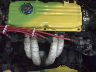

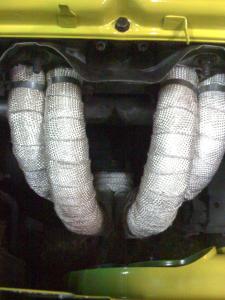

1.Place one end of your thermal wrap perpendicular to the piping you want and hold it
2.Wrap around it and make a 30degree turning
4.Let every wrapping overlap it by half of the thermalwrap's width. The 2nd Pic show you a wrong example without overlapping it.Yes it will save u some of the stuff but the finish product won't last long and it doesn't function cos there's a leak for heat dissipation.
Added on May 31, 2009, 2:10 am
5.Put your clips in...pull n Fully Tighten it (moderately pulling force cos the edge of the clip is kinda sharp)
6.Now take out ur long nose plier and really make sure ur clips is FULLY tighten!
7.Cut the the extra left over material,fold it back and fold again so that u can insert it back to the clips holder itself....after folded u may wanna hammer it abit to reassure that it's secure properly
Basically i've oredi briefly the necessary skill for this DIY...the rest of the wrapping just apply the similiar technic.Oh ya...you wanna ask me how many clips to use huh?yaya....i'll tell you more clips = more secure.But fren...agak agak lah biggrin.gif
Added on May 31, 2009, 2:28 am
Finally!
Attached Image Attached Image
I post this DIY doesn't mean i'm a pro in it...any question or doubt just post here,let's discuss!Enjoy The fun of Builiding ur own machine!
