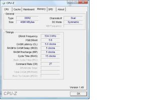

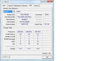

TSHou_JaI
post Jan 17 2009, 11:14 AM
1,129 posts
anyway i have set it to 2.2V tongue.gif, ehm but in the cpu-z it shows like memory.jpg
Just curious in SPD, why there isn't any timing at 5-5-5-15 2.2 V? did i got con ?!?!?!....
more over it show max bandwidth is 6400 but what i got is a pc2 8500 ... please advise
In memory its 534.4 X 2 = 1068.8 hmmm so which is correct ?!?!? ...
btw, the ratio is 5:8, understand from google that ratio 1:1 is the best, any idea how to set it to that ratio?
This post has been edited by Hou_JaI: Jan 17 2009, 11:24 AM

iBenQ
post Jan 17 2009, 11:36 AM
1,550 posts
Joined: Aug 2008
spd will refer to jedec standard la @@...
ur actual frequency and timing will be under memory section...
if u wan put 1:1, make sure the multiplier for ram is 2... lets say ur bus speed 400, then ur ram must be ddr2-800 biggrin.gif
