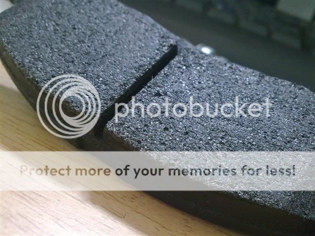

There is a possibility that you have fakes. Where is your central groove? There is suppose to be a groove in the middle of the pad. Don't think you've worn them off.
Look at the pic below. Did yours come with the groove?

that's a fake. my ferodo zeros have a central grove AS WELL as pads that do not look reddish after 10k. ferodo zeros are known for their initial bite. does yours have great braking feel when your first depress the pedal?

funny, his 1 doesn't nhave center grooves

Looks like fake pad.
Even caplang pad also wont break up like a biscuit, it only wears off.

don't know bout that, mine does XD

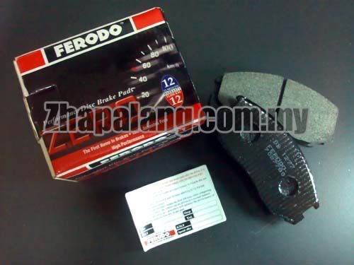

bro.. i think u puchased the fake one.. in market alot fake one.... when u puchase.. did it come wit a sticker??? window sticker lik those engine oil changed sticker...
