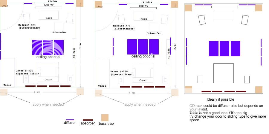

djdyks
post Nov 4 2008, 09:35 PM
404 posts
Joined: Jul 2005
Sorry bro, borrow your thread ...
or
How to place diffuser or bass trap ?
Which placement better ?
This post has been edited by djdyks: Nov 4 2008, 09:58 PM
junwei
post Nov 4 2008, 10:56 PM
252 posts
Joined: Apr 2007
wah ~ 3D plan somemore. what tool are u using?
bro djdyks, i will edit the picture and send back to u okay?
coz i'm using my laptop ...jz formatted so dun have graphic tool to update.
djdyks
post Nov 4 2008, 11:04 PM
404 posts
Joined: Jul 2005
No la, its juz jpeg.
I'm using 3rd. party software to create the 3D diagram
junwei
post Nov 4 2008, 11:11 PM
252 posts
Joined: Apr 2007
from the plan, i would assume it's a bedroom layout with 3 solid walls + 1 wall with windows and the wooden door.
I would suggest that if possible, try to shift the table away coz from the plan, i think the table is quite big.
cd racks can function as diffusor too but it will not balance out if u r combining it with real acoustic material as the density and compound of the material are different.
This post has been edited by junwei: Nov 5 2008, 12:52 AM
djdyks
post Nov 5 2008, 03:42 PM
404 posts
Joined: Jul 2005
Thank you very much for the detail explanations and proposals.
Can you PM me individual price of the diffuser, absorber and bass trap?
I'm thinking to modify the door to open outwards instead of current inwards (unless my wife boom me for blocking her way)
TQ !
One more question, how bout distance of speakers from wall ? Bookshelf and Floorstanders ?
This post has been edited by djdyks: Nov 5 2008, 03:44 PM
junwei
post Nov 6 2008, 08:05 AM
252 posts
Joined: Apr 2007
Different speakers have different characteristic in different room settings.
I would suggest you try out the positions starting from closest to the wall and slowly move it away. Also do some toe-ing in n out will fine tune the sound stage.
my question is why you leave the subwoofer so far away from the corner? I forgot to draw the subwoofer in the diagram. I would put it on the far right corner...again closest to the wall n slowly move it away.
will PM u the auralex price.
