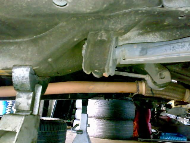

the_catacombs
post Sep 21 2008, 01:14 PM
8 stars wooo....
10,975 posts
From: disini disana

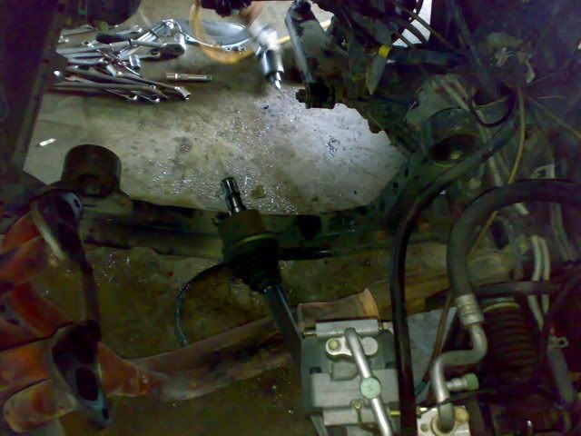

QUOTE(p0ser @ Sep 21 2008, 11:20 AM)
lower arm mounted to the chassis....

p0ser
post Sep 21 2008, 10:27 PM
Travelling around the silver state
605 posts
From: Ipoh
LOL, thats only 1 side of the lower arm.

the_catacombs
post Sep 22 2008, 02:12 AM
8 stars wooo....
10,975 posts
From: disini disana
QUOTE(p0ser @ Sep 21 2008, 10:27 PM)
the other end also connected to the chassis ler... where to torsion beam across left n right for macpherson struts....
rear suspension got lar... like myvi, vios all using torsion beam axle....

if not, i have... pics of the lower arm bolted to the chassis... and not ur so-called crossmember...
how come i dont see any part of the lower arm connected to ur so-called crossmember??.. hmm.gif hmm.gif

take note the crossmember in between the driveshaft and steering tie rod.
notice the lower arm mounted to the suspension crossmember front?
the_catacombs
post Sep 24 2008, 01:16 PM
8 stars wooo....
10,975 posts
From: disini disana
QUOTE(p0ser @ Sep 24 2008, 09:32 AM)
anyone got proper direct picture can clarify this arr??... i not vr expert in seeing angled photos... doh.gif
