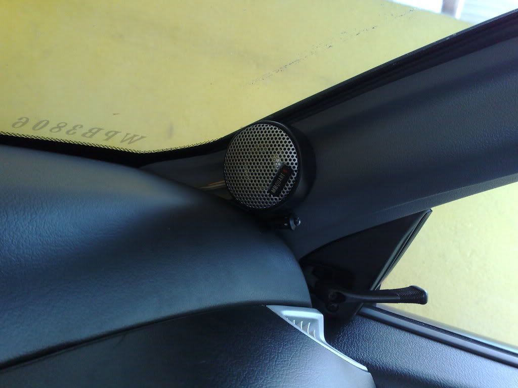

Im still thinking how u get the right angle for ur tweeter positioning..? some say need to do a crossed angle, some say need directly make the tweeters to directly hit ur ears.. rclxub.gif ..
so any suggestion?

Because high frequencies are very directional, you can try facing the tweeters towards the roof at an angle so that sound reflects off it back to the cabin.. this also takes some of the harshness away...

cross angle means to direct the tweeter to face the center...usually to face the tweeters to the rear-view mirror or center of the car for sound staging purposes...

yea.. thats wut im planning to say.. im surrent;y facing my tweeters to the cnter tof the car for sound staging.. can start to get my bass coming out from the windscreen oredy and not from the back of my car.. icon_rolleyes.gif but still im in passive setup.. going to active setup soon..

just a tips here..
if your tweeter cut off freq is low..let say 3khz or 3.5khx..u can place it quite far from the mid bass and still get good soung
if it is high like 5khz..u need to be sure it was not too far from the mid bass..if not it will sound very separate and weird
2 common tweeter placement are on axis and off axis..
i place mind shooting the center of the roof..
some people place it high on A pillar to get good staging

metal dome tweeters: i place them high up on the a-pillar somewhere till my ear level while the left tweeter faced my left ear and the right side faced the passenger's right ear... result was good... harshness was minimized while the staging was high enough...
then i change to soft dome: using the same angle... i found that my staging is too close to me... even how i cut the freq, adjust the gain... still they are too close... then i place then deep into the dashboard on the a-pillar faced where still the angled like before towards the ear thing and upwards to the rear view mirror... results well staging not so high... but its very deep...
