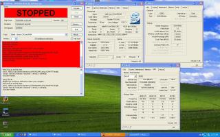

Added on July 28, 2008, 12:56 amok.. ady tested 1 by 1, but still cannot boot, then i plug in 2 stick again, it able to boot at 1066, but when i try to orthos, few sec it failed.. and also error from application come out. rclxub.gif

Ok, I would return the RAM. Go back to the shop and ask for 1:1 exchange if it's been only a few days. If not, RMA..
