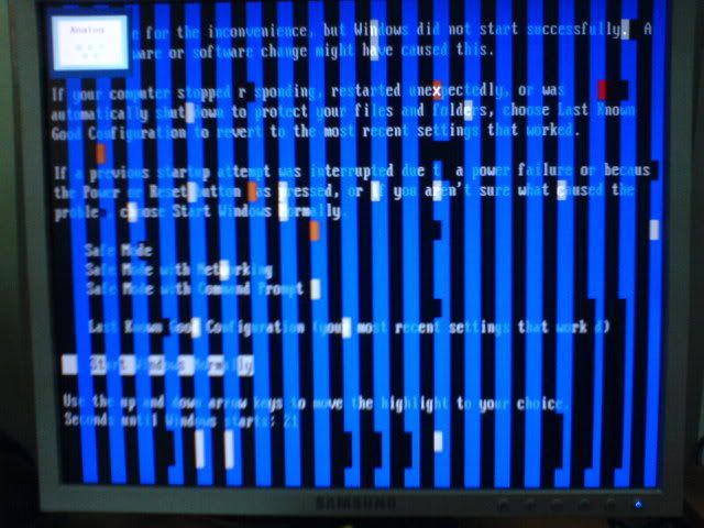

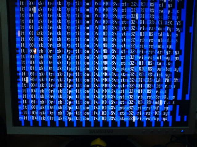

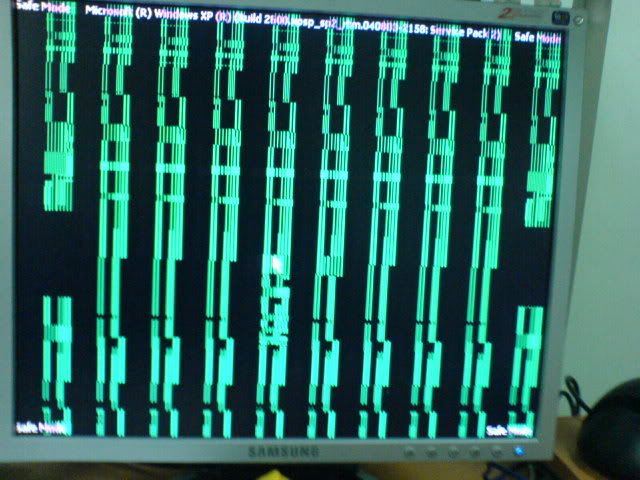

Guys, see these screenshots.
My GC lately have been giving me this problem. Play a game or video will become like this. I thought that it overheated, but the temperature reading is roughly 63. I have checked the connections as well, they are all fine. I have tested both DVI and VGA output, still same. reinstalled drivers, helped a bit, but I really cannot guarantee.

Would like to send u a condolence....ur gc jz died smile.gif most probably is the ram on ur gc tat causes that to happen. if still under warranty send to warranty smile.gif

To make sure that GC.. u can borrow ur fren's GC la..juz wanna confirm that occur cause GC

hmmm..try ur friends gc...if its ok,it means ur gc jam...huhuh...but if ur freinds turned out to be like urs..probably the cable or the lcd..

i guess it only happen when ur gc is on 100% load.
maybe its too hot than the artifact show up.

Are you overclocking your gc? if yes, set back to default clock speed and test it again.
Check the gc fan function or not also.....
Another method to confirm ur gc condition is put it into another computer and test it. if problem exist again, either send to warranty or throw it.....

have u try to benchmark by using software 3Dmark. maybe it can show any failure if ur GC is spoil

i had the same problem also..after i do this it's back to normal...take out your gc and clean it all...especially the connector..

mostly i think also the graphic card problem.used a rubber to clean the pci-e[ connector area] if cannot i think you need to send it to rma aready

The GC is at stock speeds. The fan is working. There is no more warranty as it has been more than 2 years. (7300GS)
