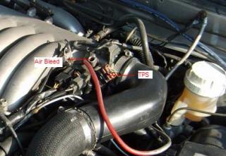

QUOTE(779364 @ Jun 26 2008, 02:14 PM)
Hi,my Waja 1.6 4G18 is also giving me this erratic idling problem.Like what you said,everytime I switch on the air-cond the idling needle will go up and then drop and this also happens when I turn the steering wheel when not moving.
Does your guide applies to my Waja.Mine is a manual.I am not very good in car repair so hopefully you could provide pictures where the adjustment screw will be in order for me to set it up my own.By the way,would there be any effect if I screw up with the setting.Thanks bro
Here you go.

779364
post Jun 28 2008, 07:16 PM
Starry Starry Night
1,696 posts
Joined: Dec 2006
From: Genting Casino Bank Vault
QUOTE(solai @ Jun 27 2008, 03:35 PM)
Here you go.
The pic is a little small and I can;'t really see the air bleed screw properly.Is there a bigger pic focused on the air bleed screw.Sorry TS hehe

I just open up the bonnet and I saw the throttle body sensor with the wires coming out of it.But I can;t see the air bleed screw.
