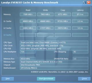

After reading bryanyeo's article, I messed around and got these 3 results (I did a few other FSBs, but let's settle on 3).
The usual speed running at 12:8 ratio -
Highest FSB so far (1:1), too bad crashes instantly on Orthos....
And the current 1:1 24/7 setup
1.344v vcore, DIMMS @ 2.00v, rest on stock.
fesick

Just a small update, got it running 430x7 @ 1:1 now. RAMs at 4-4-4-12 @ 2.1V. Vcore @ 1.360v. Vtt and vNb at stock.
Crashes at ~ 5mins mark in Orthos blend. But hasn't crashed yet in 3dmark06, World In Conflict, UT3 or Crysis. smile.gif

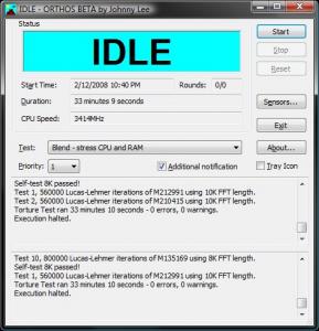

Alas, 430x7 was shorlived, it BSOD on me while playing WiC last night, funny (or not). doh.gif
So it's back to 380x8 for now. Screens as attached.
And Orthos past the 30min mark
