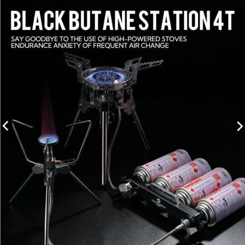

QUOTE(KuzumiTaiga @ Dec 6 2025, 05:33 PM)
It's a Weber gas grill. Model Q2200N
for small grill like this I think you can get away with just combined regular butane.
Its a slow firing grill, so 230x4 total capacity would go a long way. Just need to get lindal valve to horsetail coupling and reducing brass.
Even cheap pure butane would work fine without freezing since the gas is dawn slowly in parallel.
It doesn't offer best economy compared to DIY LPG refill, but its cheap enough for occasional use and readily available.

https://www.lotuss.com.my/en/product/mag-po...mg-306-73739561
https://www.decathlon.my/p/gas-stove-with-l...az-8582112.html
go Shopee search for Camping Gas Stove.
