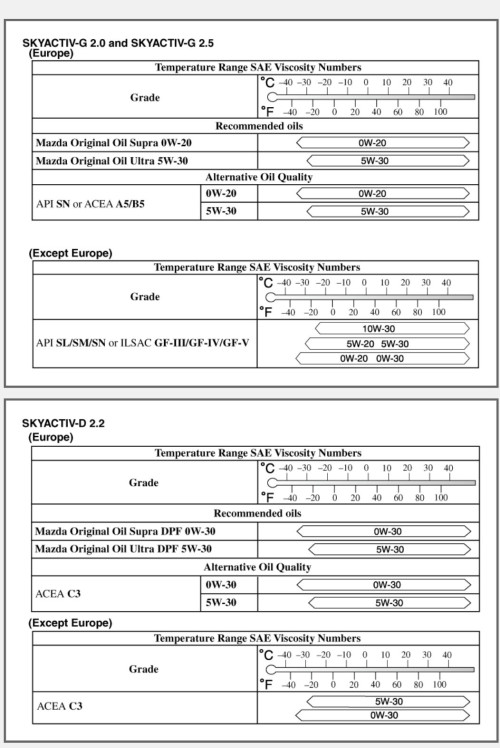

This is Mazda cx5 recommended EO.
For our tropical country, will go for 5W-30.
0W-20 just to meet specific country emission regulations.
