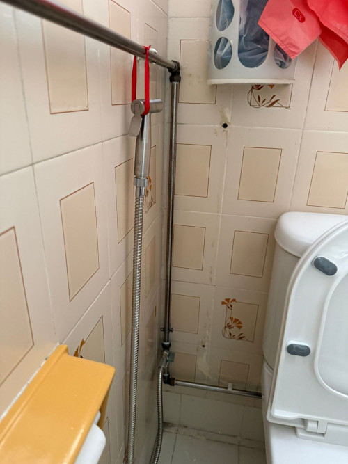

Hi all. My 8-9 years old house already have leak at the toilet. It's affecting the opposite side of the wall.
The contractor gave us 2 suggestion.
1. Just do external piping. Easy. - wife don't want
2. Hack the tiles to try to find the leak. Problem is i contacted the tiles supplier they don't produce those tiles anymore. So it will be weird if I use a different tiles on some spot.
You guys face this situation before?
Are there any smarter way to do it? Or maybe different tiles design solution?
Thanks.

External pipe use copper or chrine
TSbengang15
post Oct 21 2025, 01:04 PM
417 posts
Joined: Feb 2022
QUOTE(lj0000 @ Oct 21 2025, 01:02 PM)
Yeah the easiest is external. If I do that I plan to use stainless steel for lor.
But wife very hesitant.
To me either one will be ugly. Unless we have a creative way on the hacking and using some clever design on the tiles.

i have similar problem; i hack the other side of wall, can see the leak at elbow fitting; now thinking how to solve laugh.gif
water leaks always happens at fittings; elbows, T- joint

if your external facade is painted wall then I don't see a issue with external pipe. just paint it the same color as the wall or do a whole house repainting after the pipe is installed.

external is easy, but cleaning is a pain from what I've seen at my parents.
