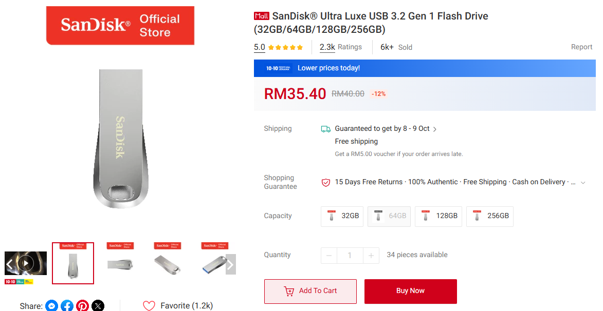

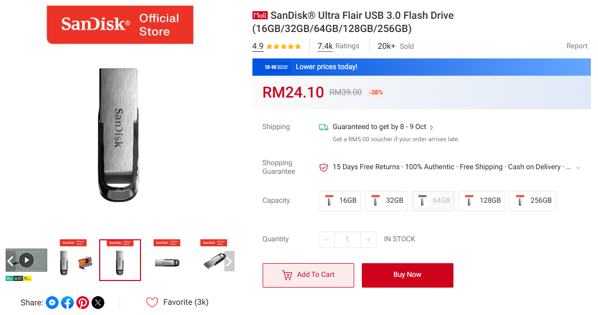

A few sample photos showing the metal flash drives.
