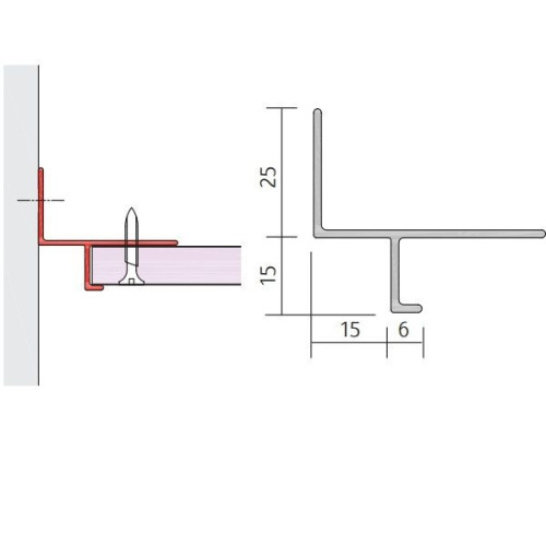

To prevent those corners crack due to the natural of expansion and contraction of material... if you are planning to do plain modern ceiling.. without those cornice/moldings...i would normally advise owner to use shadow gap alum. to all perimeter. Its a clean transition between wall and ceiling surface.
But.. need to find someone /worker who is patient enough to aligned those shadow gap channels properly...make sure your walls are within minimum slanting tolerance ya..not wavy if not will have issues installing the shadow gap.

QUOTE(ArchId @ Sep 10 2025, 09:11 PM)
cheers mate
Izwan
www.archidstudio.com
This design is also used for cove light?
