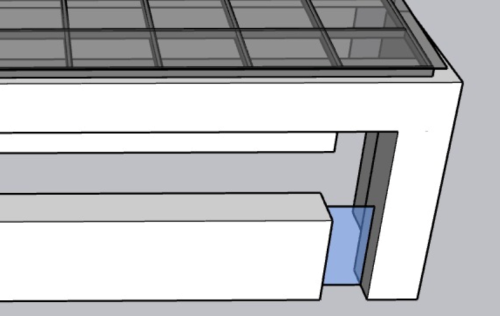

hi sifus,
i am going to install glass awning at my condo balcony, but due to it being strata title, my glass cannot extend beyond the beam edge.
My question is whether my frame will get rusty easily because of the rain water? Any potential solution to this?
or am i worrying too much unnecessarily?
thanks in advance for your input!

Use stainless steel polished or brushed depends on your personal preference, or use aluminium material for the frame, also use stainless steel bolts & nuts.
