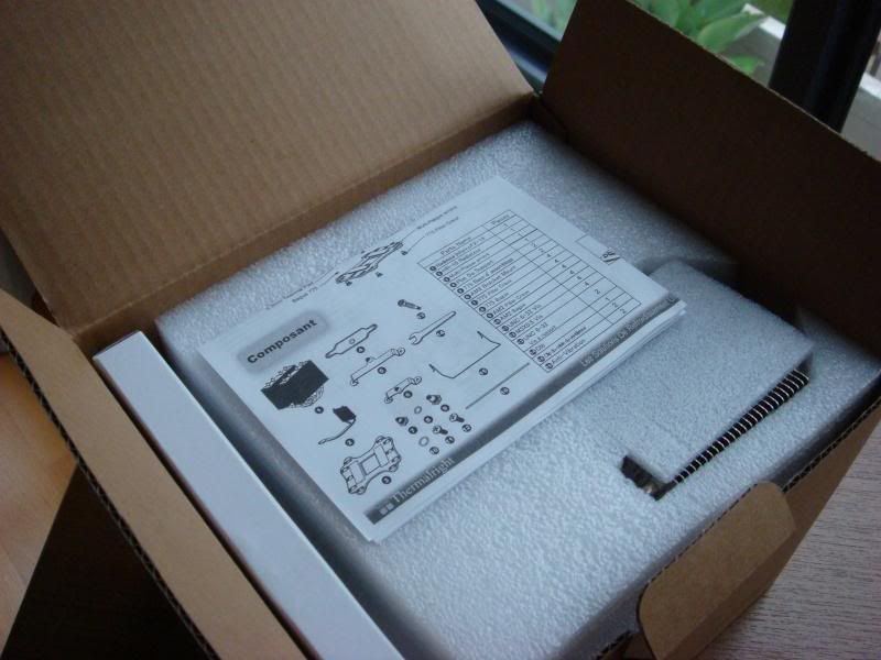

another nice big brown box!
Installation manual

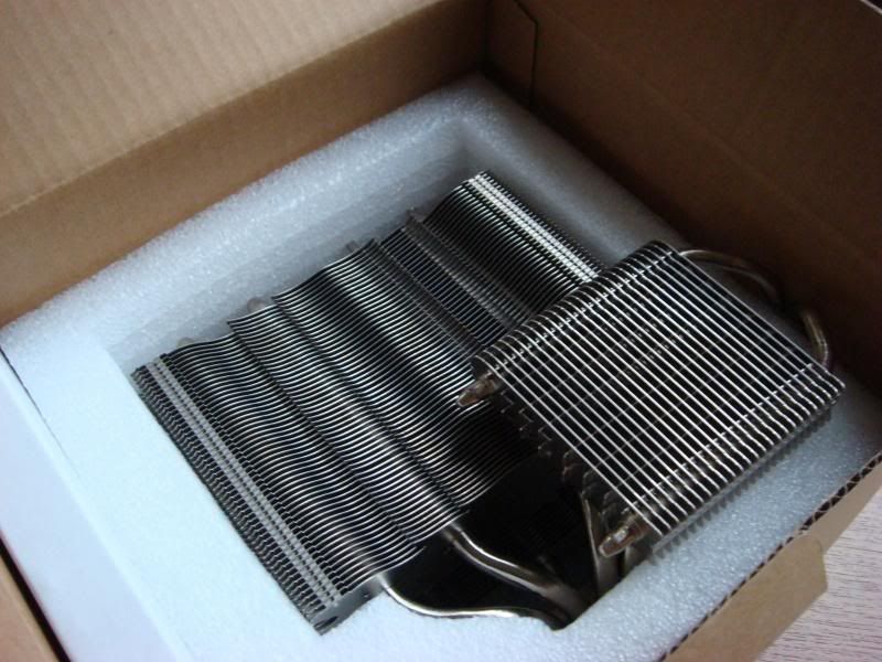

like other Thermalright heatsinks, they are nicely seated in a thick layer of foam to prevent damage.

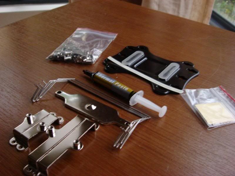

other accessories included

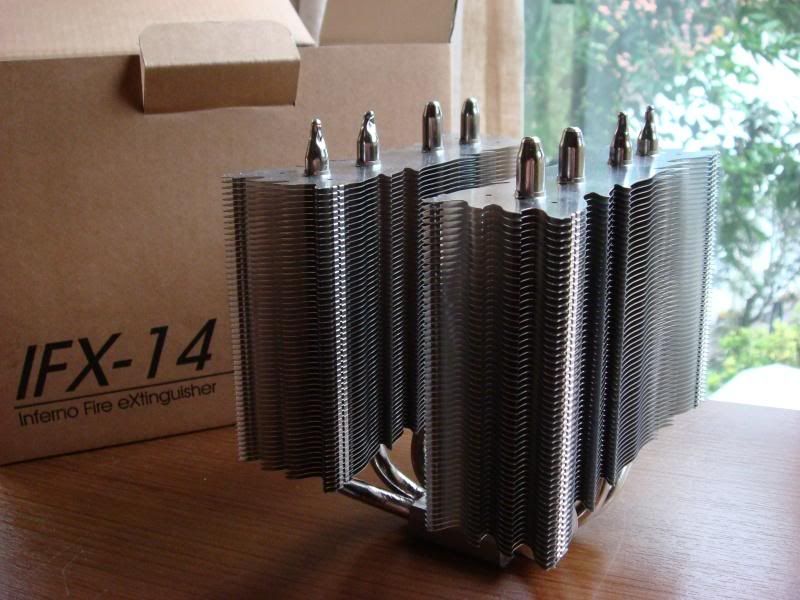

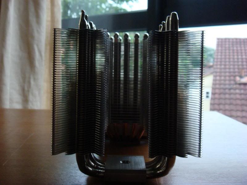

the beast

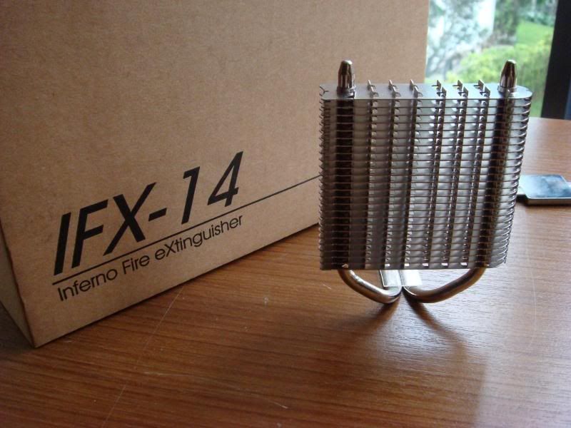

the HR-10!

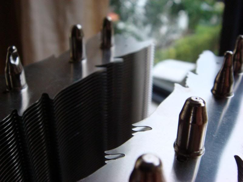

Inferno designed fins

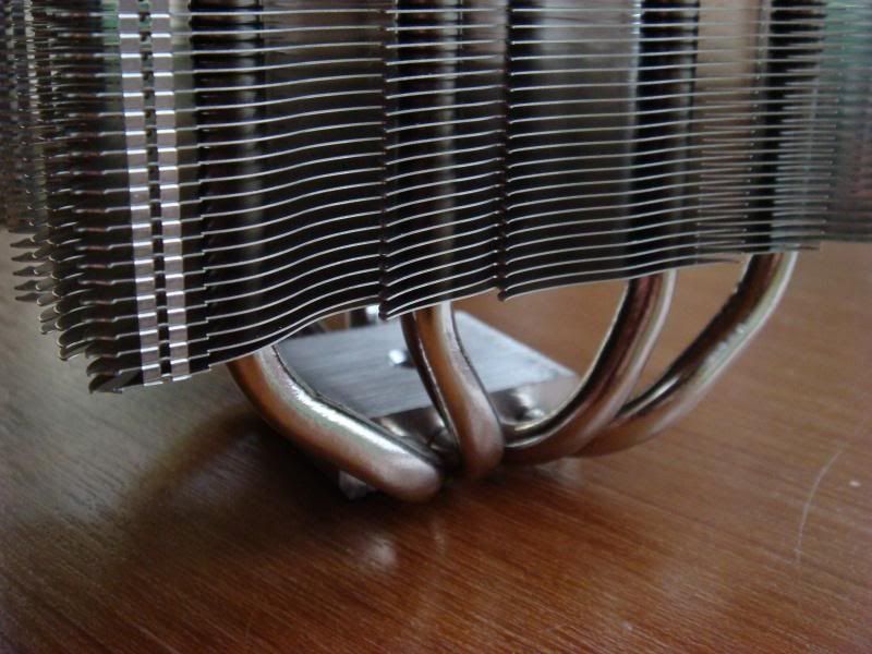

and of course the sexy heatpipes

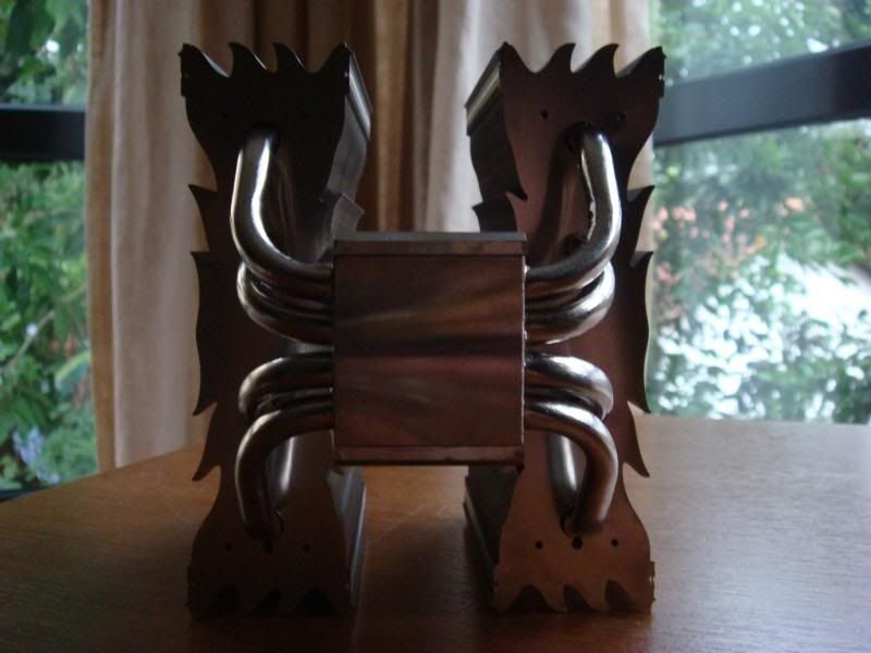

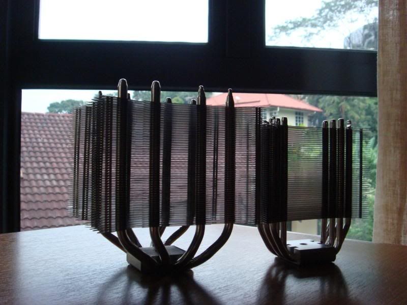

here it is compared to the Ultima 90i. The size difference is massive

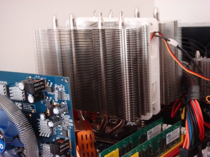

here it is in action!

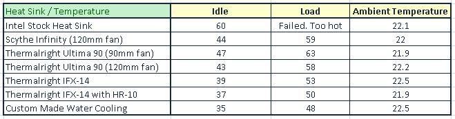

Test Bed:
Processor: Intel C2D E6600 @ 3.2GHz @ 1.35 vcore
Motherboard: Asus Maximus Formula Special Edition
RAM Module: Team Xtreem DDR2 Special OPB Edition (Micron D9GMH)
Graphic Card: Galaxy 7300GT
Power Supply Unit : Silverstone Decathlon 850W
Hard Disk: Western Digital 36Gb Raptor
Operating System : Windows XP Professional Service Pack 2
Testhing Materials Used :
1. Artic Cooling MX-2
2. Silverstone FM 123 (120mm) at 1750 RPM
3. NMB 90mm fan at 2000 RPM
Testing Methods Used :
1. Each Heat Sink is tested twice(cool down is 5 minutes between each test), the average results is taken as the result.
2. The same amount and type of Thermal Paste used is kept constant for all Heat Sinks used
3. All Heat Sinks are tested with the same fans (excluding the Ultima 90i tested with a 90mm fan and the Water Cooling setup)
4. A Thermal Probe is placed at the edge of the CPU to retrieve the temperature. The Thermal Probe ensures accuracy in Temperature reading.
5. Load test were done by running ORTHOS Small FFT test priority 8 for 20 minutes. Ambient temp prior every test was be measured.
Installation :
This was a relatively easy process. It only took me 10 minutes to assemble everything on my motherboard. The fit was very good too smile.gif
The Results :
Conclusion:
The Thermalright IFX14 is an outrageous performer. The temperature readings that were taken when the thermalpaste did not sink in yet as to compared to the custom made watercooling.
Also, it was super easy to install in case anyone is wondering. the HR-10 backplate did make a difference for me, so its not a marketing thing.
Oh yes, the fins were NOT as sharp as the Ultima which made installation a tad bit easier.

i'm surprised at how effective the HR-10 is, good job mate.
so the ifx does fit the Maximus Formula....

nice review~! btw i wonder why at only 1.35vcore, stock intel hsf failed the load test.. i used lots of c2d e6600 before and under hotter ambient temp and higher vcore, they were still manage to complete the load test.. what test did u used? in case i miss it.. unsure.gif

a great heatsink might has on par performance with wc.. but bear in mind that in certain cases, like a very hot day, poor ventilated case, and dusty heatsinks will degrade the performance of the heatsink a lot.. compare to wc where the effect of these cases is not so big..
i think its cause i didnt put the thermalpaste properly
caus ei realized the contact was not good, and everest gave me warnings that it was touching around 70++
so i considered it as it cudnt handle it. =/

haha well i dun think many c2d user here is using stock intel hsf.. but when u stated it as too hot and cant handle it.. somehow it showed that the problem is from the heatsink.. not from the thermal paste or any outside factor.. if that's the reason lah..
for me, i'm pretty sure the stock intel hsf is gud enuff to handle voltage until 1.375vcore... considering the IHS of the processor is not concave.. more than that is ok.. but of coz endangering ur cpu lifespan and limiting the oc..

it is enough to handle the temps, but if we're looking at long term usage, the life span is definitely going down smile.gif
thats why we need these 3rd party stuff
dont worry, im going to redo the testing. im somewhat no convinced that this is the max performance out of this beast.
oh yeah, hey sorry for the misunderstand, i didnt bother explaining why the stock hsf failed. thought everyone's focus was on the 3rd party heatsinks biggrin.gif

haha but thanks. this is good that you ask so that people know why i put failed there biggrin.gif

cant wait for the new results, multiple test results compiled for comparison produces better accuracy especially those that are making decisions based on them smile.gif

the results here are actually multiple tests.
just that i too the average as the diff was only +/-2 degrees smile.gif
but in any case, the next one will be more detailed. you have my word on that

My IFX-14 biggrin.gif....
Inside the box..
The coolers...
Here it is after installing...
Haven get the fans yet.... The idle temp is 44C...

Oh yea... Its a pain in the *** to install it ... rclxub.gif The idle temp is quite high.... Buying a fan tomorrow ... Can fit a normal 12cmx12cm fan in between it rite?.. smile.gif

yes but they only give 2 clips.
id suggest get the Fm123
one of the best fans ive ever used

u never show us one thing,how flat is the base surface.
u'll be shocked to know when u go and check it out.

yeah but one thing.
if im not wrong there is a little conflict here

what ace is trying to say is that the IFX14's base is FLAT
i agreed with him too. it is much flatter than my ultima which actually suprises me
the thing is, the C2D IHS isnt exactly flat, so thats why some manufacturers purposely make sure its not totally flat
thats was what i was told some time back

yeah but not all are that flat
thats why you lapped your TT BT VX didnt you?

It's pretty hard to tell how flat it is from our eyes but yes, some of them aren't flat - like our CPU's biggrin.gif

QUOTE(mADmAN @ Dec 14 2007, 02:00 PM)
take pix of the base pls.
here is it

the uneven base is something thermalright is doing these days. it was sort of a controversy. but they do have somewhat valid reason. something to do with the shape of the cpu IHS as well....read this somewhere....

mADmAN, the Ultra Extreme has a much better and flatter base. Your explanation has some valid points too and I agree the IHS is not flat (corners tend to be thicker). However if you see the IFX-14 and put it on a glass surface, you can move it left/right (very uneven).

yeah i know how uneven the base is..... i did this same exact test oso...with the same exact results...
can read more about it HERE
theres also a review of the lapping results by the same guys HERE
im still considering on whether or not i wanna spend the time to lap the base... the damn thing has managed to scratch my processor IHS...actually the base of my IFX oso scratched liao sweat.gif
Added on December 27, 2007, 4:49 pmi dont see why lapping the ifx would be "heart-pain".....
wats truly painful is the fact that u pay so much for the cooler and the base turns out the way it is wink.gif

Can you explain a little bit more on backside heatsink. Why doesn't fit?

if u use cm 690 u cant use it because the backplate huhu what can i say btw if u psu at top u can use hr-10 btw ifx-14 i dont know

What are talking about? It is clear that IFX-14 can fit in CM690 the issue is whether the extra passive cooling can be installed or not.

sure cannot la bro just hear that >.> why u dont try? hehe
sepulgilo
post Nov 2 2008, 09:31 PM
dead for good
1,626 posts
Joined: Dec 2007
back cooler of ifx 14 bend it slightly sure can fit into ur case
teamloks
post Nov 2 2008, 09:55 PM
1,176 posts
Joined: Aug 2008
sepulgilo
post Nov 2 2008, 10:07 PM
dead for good
1,626 posts
Joined: Dec 2007
bend it smoothly and nicely sure no problem even will looks cool heheheeheee

The extra passive cooling does not fit on the CM690

need to bend it T_T and cant use top fan

I've never used the back passive cooler throughout my ownership of the IFX-14. In actual fact, it's quite hard to get a casing that lets you fit the back part without "modifications" smile.gif

same here.. i never did use d backside cooler. it might fit my casing by bending it slightly.. furthermore, with d tpower mobo layout, d cooler protruding up...
