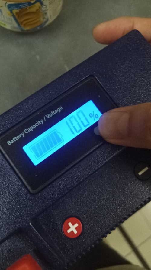

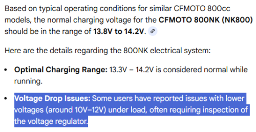

jaycee1
post Jun 9 2025, 09:03 AM
AFK
2,484 posts
Joined: Jul 2008
Good batteries are hard to come by nowadays. Most of the cheaper ones dont seem to last long. Even if they do , you'd be lucky to get 2 years of service from hem.
My dominar is on its 3rd battery (ytx 9) the stocker lasted an astounding 4 years and it was still working when I swapped it out as a precaution to protect the rectifier. The green Tokio battery lasted barely 6 months (80). Now running a yuasa battery (130). Hopefully it does better.

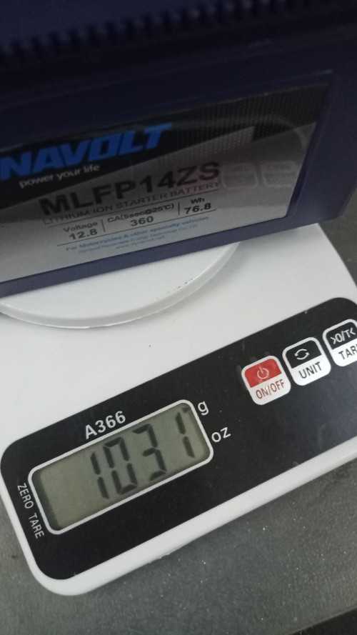

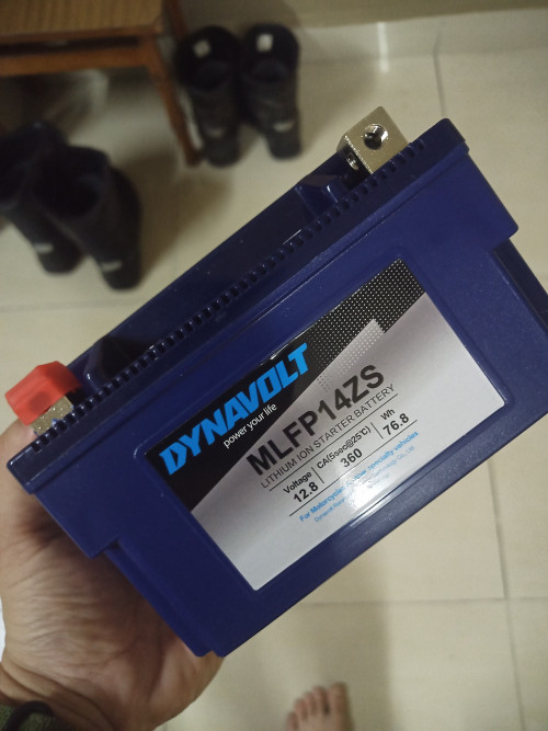

On the NK , I just bought a ytx14zt lithium battery as the stock battery is on its last legs, dropping to 9v on startup if left unused over the weekend. Best to have a standby battery. Got it cheap from 6.6 shopee sale and some coin redemption. Paid 309 for it.
It is comically light though... But I bought it to offset some of the weight from my racks and panniers. My battery is mounted high in the tail so should help with bike balance going with a lighter battery.
If you are considering a lithium battery, bear in mind it does have pros and cons so it may not be suitable for all situations. Glad to explain if you guys want to know why.

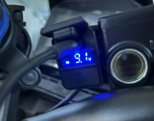

Ironically stock batteries doesn't last long for me.
My bike usually left unused for 1-3 months. Usually I return to find the voltage below 9v and will have it charged up before firing up the bike.
Thought about lithium (LiFePo4 to be specific) but our standard charging system might not output the right voltage to charge it.

Motorcycle Lithium batteries are built with BMS that is specifically designed with a bike charging system. That said, here are the pros and cons.
Pros
Very light weight, often smaller formfactor, doesnt leak, can be mounted every which way, even upsidedown.
BMS will cut off the battery if it falls below minimum voltage, protecting the cells (for L/A and AGM, once the battery discharges, sulfication occurs and damages the battery)
Low self discharge rate
Excellent amp draw
Cons
Equivalent Lithiums typically only have 1/2 the reserve capacity of same "sized" AGM. This is because lithium battery manufacturers follow the CCA of regular AGM to "size" the battery. My new lithium ytx14zt is 76whr, while the factory AGM is at 144whr. So read the specs carefully.
Not good in cold weather (does not apply to us, see below)
Can explode and catch fire spontaneously (hehehehehe.... especially charged when very cold) Lithiums need a short warm up to wake up (by turning on ACC and lights) before operating below freezing temperature.
So depending on your needs, if you got an infrequently used bike with inherent high standby draw (pretty much any new modern bike especially those with keyless, always on gps, security systems), Lithiums may not be suitable, but if you have a very old bike with no electronics, the low self discharge rate of lithium will be better. And all bikes will benefit from the much lighter weight.
If you have an infrequently used bike, in order to protect the L/A AGM battery, you have to invest in a trickle charger anyway. Any full discharge damage may be irreversible....as it may not charge up to full capacity anymore and it would only get worst over time. My cheap tokio Ytx9 has one full discharge and it turned into a paperweight, even using a pulse charger didn't bring it back alive. More expensive AGMs may be more resistant, but chemistry is chemistry.
Im still hoping Lithium battery manufacturers will put in a USB type C charging port so i can just stick a power bank and charge it. Sure they need a more complex dual input BMS...but I can dream.

Please plan a teardown of the Dynavolt once it's done
I thought the same, but... unfortunately, some Lithium packs don't actually have BMS
This isnt a battery issue man...this is a user issue...if u know ur bike is unused for 2 weeks or more u should really remove the terminals from the battery. Any battery u use will drain with that kinda non usage.
There are systems in ur bike that still requires some low amounts of power when the bike is off...like ur clock..internal memory for ur settings, mileage etc..
This is same for any vehicle...starting the bike/car at least once a week for 5-10 mins is more than enough to keep the battery alive. Also helps to keep ur internals lubricated.
Pretty sure something like the dynavolt battery will have a BMS. At least it says in its spec. Plus with the battery display, im sure its driven by the BMS.
Will keep the teardown in mind when its done for...if not just to humour you. Hahahaha

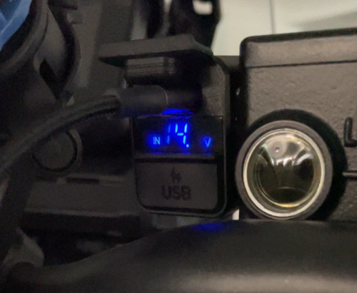

I have installed a 2-way USB charger and it's working like a charm everytime I come back to charge the battery with my power bank.
Yes I am not prepared to open up the battery that's well hidden in my scooter to unplug it, and come home to reconnect it before I can use.

JustForFun
post Jun 20 2025, 06:23 AM
Seeker
1,281 posts
Joined: Sep 2008
QUOTE(jaycee1 @ Jun 9 2025, 09:03 AM)

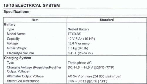

The battery in my Ninja 400 died the other day and not knowing better, I got it swapped with the green Tokiohama, even paid 200 for it because I had someone send and change it without knowing how simple it was to replace myself. Was in the middle of work and didn't have time to check my options. Not sure if it's just a crappy battery or poor installation, but now my bike weirdly has to be in upright position to start normally, otherwise I would have to crank it 3-4 times just to start the bike.
Another astounding bit is that my bike was manufactured in 2019 and registered in 2022, and although it's seen little use, it's miraculous that the battery last 6 years. It's a FTX9-BS made by Furukawa Thailand.
Man...you paid 200 for that green turd. My tokio was 90.
That starting issue is a weird one. Notice if the crank speed is lower than previously? On my ytx9, it cranks slow, then fails to crank at all. Like not pushing enough amps.

you gotta figure out the output voltage that the battery is getting before deciding which battery type to get
if 14.4V then cannot use Gel battery
AGM < 15V
Normal < 14.7V or 13.8V (when full)
Gel < 14.4V or 13.8V (when full) - very sensitive to overcharging
alexei
post Sep 29 2025, 09:43 AM
Biker Mice from Mars
1,878 posts
From: Medan, ID
JustForFun
this is from manual, 14.5~14.9V. you should try to measure it. if this is the case, the bike cannot use Gel battery, the charging system will over-volt it and kill it within weeks

TSWH4CockcooBird
post Oct 5 2025, 10:24 AM
194 posts
Joined: Jul 2022
I installed this 2-way USB charger and use it to charger / tender my battery with a power bank.
Scooter with plenty difficult to remove fairing is pain for DIY therefore gone for this solution.

TSWH4CockcooBird
post Oct 6 2025, 10:25 PM
194 posts
Joined: Jul 2022
QUOTE(JustForFun @ Oct 6 2025, 06:26 PM)
Is this connected directly to the battery (not switched off when the bike is off)?
Yes. Had to connect direct to battery, and the ACC line.
When ACC is off, it will charge the bike's battery.
When ACC is on, it will provide power to your equipment via the USB port.
I found my Android phone charging the bike's battery when I first plug it in with ACC off biggrin.gif

alexei
post Oct 7 2025, 01:11 PM
1,878 posts
From: Medan, ID
QUOTE(WH4CockcooBird @ Oct 6 2025, 10:28 PM)
I bought from Taobao.
thanks
I copied the link to show the wiring diagram, and did not check it was the correct link
there's a module, and uses ACC power to switch between modes, so it protects the battery

Just an update on my Dynavolt LFP battery. Started to see some voltage drop on start up. Still cranks good. Let's see how much longer this lasts. It's been like what? Only 6 months?
The NK seems to eat battery. No one can get batteries to last over 2 years. Too much active always on electronics I think.

Thanks for the input.
Was pondering if LFP can last longer than normal. Seems like same same.

QUOTE(jaycee1 @ Oct 22 2025, 09:44 AM)
that's the lithium ion? dafuq...
