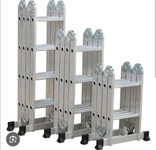

can keep it outdoor under rain? for access to rooftop.

Allu won't rust, but the small parts at joint might not be allu

the hinges and folding mechanism is not aluminum, that will rust over time

Aluminium does not rust like steel. The oxide layer sticks strongly on the surface and forms a protective layer. So if it's no longer shiny don't go and scrub to expose the unoxidized layer underneath.

I have 1 exactly like you put into picture. the horizontal leg is very flimsy. I exerted a bit of force when I'm on the ladder and it bended and I fell. I think I broke fourth toe.

Probably copty of good brand like Everlast. That low quality one will have thinner material not designed to rated weight.

nearly 300 bucks from Giant. dunno what brand.

Yup, exactly this. The "klak...klak...klak...klak.." gear part with the spring inside will rust, and it will eventually stop functioning. Then u can buang the ladder. Worse is when it stop functioning while the ladder is unfolded. U cant fold it coz gear sudah jam, and u cant bring it inside your house coz the ladder too long.

Yes the hinge part is not aluminum but composite metal. That will rust. Even indoor humidity over time will make it hard to move if not sprayed with lubricant.
Why need to put outside in rain? It would be a nice tool for thief to get into the house. If really need to put in rain, then why need foldable type? Get one that can slide and latch like the one used by TM or painter.

Check the rivets, hooks

the joints is not made of alu 100% will rust, heavy, not comfortable to stand and step on for long
buy a proper ladder

Coat joints with slicone spray.
Dont la keep it totally exposed to outdoors, not direct good enough no need completely indoor.

Don't bother with this ladder, it's flimsy and very heavy. Get the usual A Type Aluminium, last very long.
