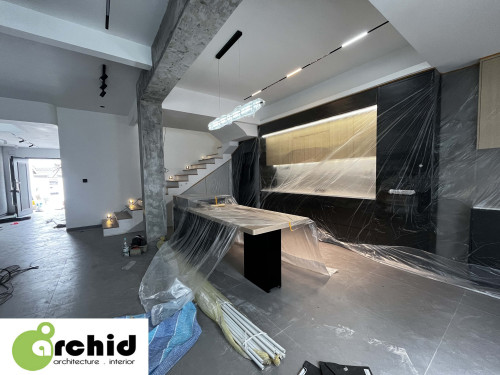

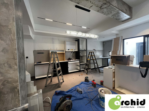

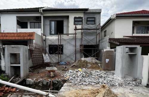

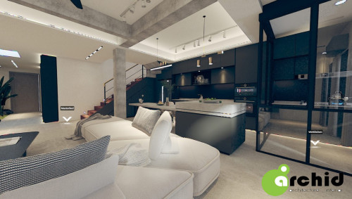

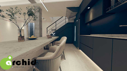

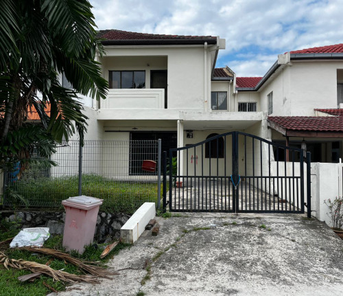

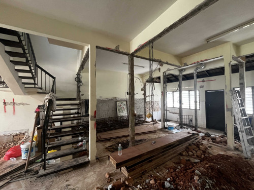

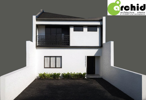

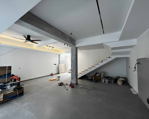

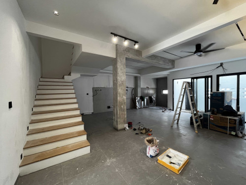

SS21 Intermediate Terrace
Land Size : 23 x 70
Total Built Up area : 2300 Sqft

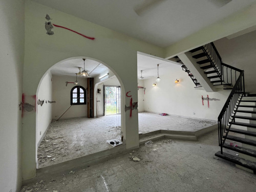

Refurbishment Works
Work Done : 85 % (pending defect + carpentry works) + V.O works

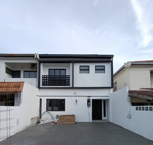

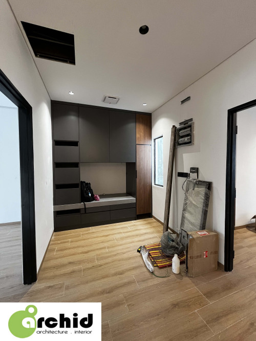

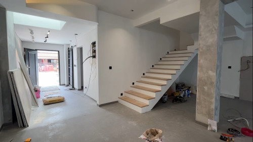

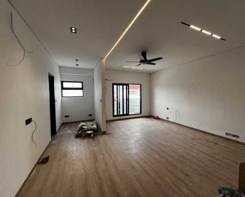

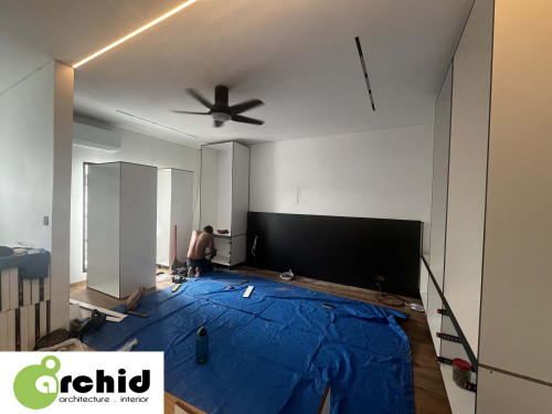

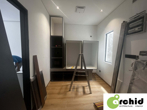

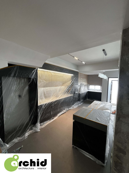

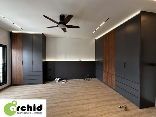

Work Done : 90 % (pending defect + V.O works)

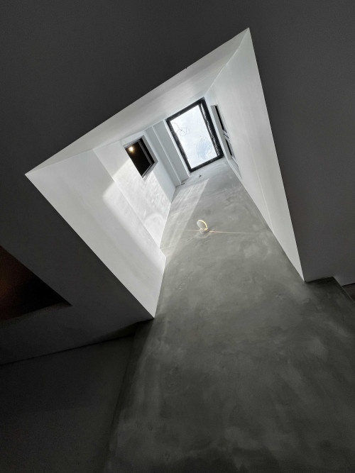

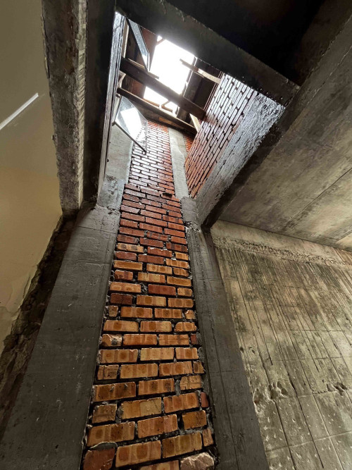

nice, bro. this house is with airwell? though i unable to see how has it been utilized well because too narrow

its for the master bath above.. personaly request to design to see the sky when laying inside the bathtub...
the airwell is fully sensor and remote based... if no raining , the glass skylight will open .. let the hot air out.. if rain start to fall down.. sensor will automatic close down the glass skylight....
will later2 show it function... kinda headache to install this smart skylight sytem.. but interesting to do

835mm x 1190 mm opening
Aluminium framing with Double layer tempered glass with sensor
Rm 3650

Motorized Mechanism?
how about maintenance wise ?

Yeap motorised system .
Maintenance ? Check the sensor once in a while if dust collected blocking the sensor . Use long broom to clear off the perimeter dust if any ..
But so far Now install almost 2 month - raining like cats and dogs and hot sun .. still function smoothly

Oh, 3.6K is include the entire system (motor, sensor, structure, etc?)
how about the motor & sensor maintenance that may requires technician in the long run
