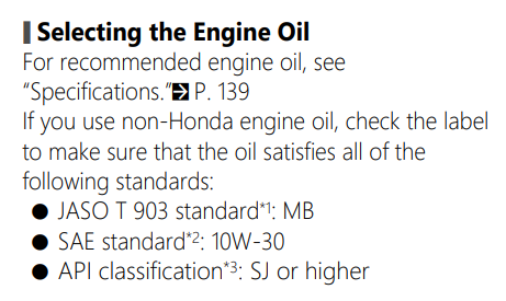

QUOTE(WH4CockcooBird @ Feb 1 2025, 11:23 AM)
I can't find it anywhere on owner's manual.
Some cars do have the word "synthetic" baked into their owners manual, but not for Vario / ADV160 / ADV350.
10W-30 is fully synthetic right?
WH4CockcooBird
post Feb 2 2025, 10:26 AM
194 posts
Joined: Jul 2022
QUOTE(awol @ Feb 2 2025, 10:16 AM)
10W-30 is viscosity rating i.e. how "thick" (in layman term) is the oil.
It's nothing about mineral or synthetic.
This post has been edited by WH4CockcooBird: Feb 2 2025, 10:27 AM

QUOTE(WH4CockcooBird @ Feb 2 2025, 10:26 AM)
from honda bottle of AT 10W-30, it show as fully synthetic.

QUOTE(awol @ Feb 2 2025, 08:06 PM)
im going to impian. but not regularly. not gonna follow the sticker too.
There are both mineral and synthetic version of Honda MB lube 10W-30.

Gear oil no need change so often, but i change it during every oil change. i will buka and clean the CVT and sametime change oil and gear oil one go....
jaycee1
post Jun 24 2025, 12:52 PM
AFK
2,484 posts
Joined: Jul 2008
QUOTE(kamenkid @ Apr 17 2025, 10:45 AM)
I have a question, do I have to wait the next 6000km to service vario or is there like time interval like every 6 months?
it should say in your owners handbook.
Typically it is the mileage or 1 year
