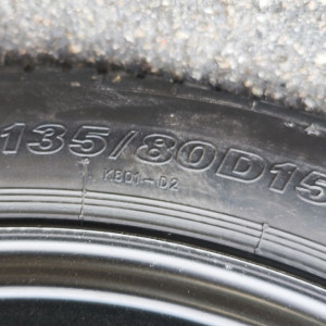

Spare tyre seem smaller.
The ori 15inch tyre can fit but with higher width. My back tray cant laid flat there.

hightechgadgets8
post Jan 5 2025, 09:35 AM
\(^o^)/
6,017 posts
Joined: Sep 2011
QUOTE(Zhik @ Jan 4 2025, 10:52 PM)
Read the size on the sidewall
TSZhik
post Jan 5 2025, 11:32 AM
eeerrrmmmnnn, stupidity has no limit?
1,216 posts
Joined: Nov 2012
QUOTE(hightechgadgets8 @ Jan 5 2025, 09:35 AM)
I saw only this one.
While my car tyre is 15 60 185

hightechgadgets8
post Jan 5 2025, 02:47 PM
\(^o^)/
6,017 posts
Joined: Sep 2011
QUOTE(Zhik @ Jan 5 2025, 11:32 AM)
No same. Can change only 1 Tyre. But very recommended to change a pair
