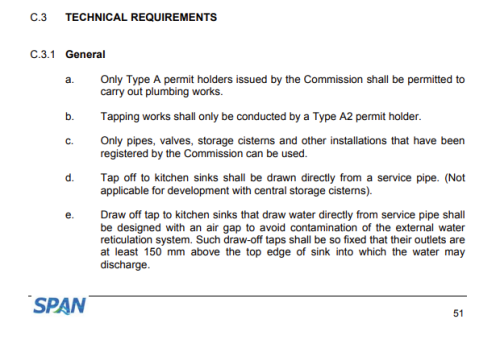

Water from the storage tank is technically non-potable to use in the kitchen, while water from the mains is. This is why the kitchen is fed directly from the mains and included as part of the SPAN technical guidelines.
See page 51, clause C.3.1.d the full SPAN pdf https://www.span.gov.my/document/upload/jd0...9LnyhboNj8V.pdf nabzblitz
Ya, thanks for the information, my contractor did tell me that.

Honestly, water directly from main is techinically non-potable. I have to use a battery-power timer to flush out the dirts accumulated inside my water filter everyday.
Sorry, I think you interpret it wrongly. Water from the mains supply is technically potable, ie can be drunk. It may have sediment, but it should be bacteria free (note I said "should be") Water from a storage tank is not guaranteed bacteria free, hence definitely not potable.
You may choose what you believe and take steps to mitigate the risks you perceive, but please don't change proper definitions.
