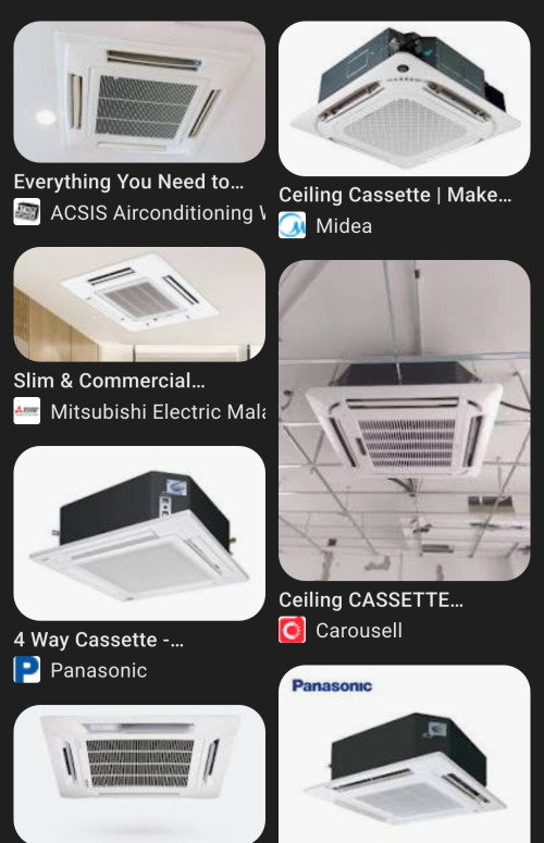

QUOTE(advTech @ Aug 17 2024, 10:33 AM)
Don't have plaster ceiling, just the bare ceiling.
Are you referring to this ceiling type of Aircon? If yes, I think it will be ugly if not concealed by false ceiling.
TSadvTech
post Aug 17 2024, 10:45 AM
198 posts
Joined: May 2014
QUOTE(mushigen @ Aug 17 2024, 10:37 AM)
Yeah that's what I meant. My ceiling is also not very high, I think I'll stick to the wall type la.
