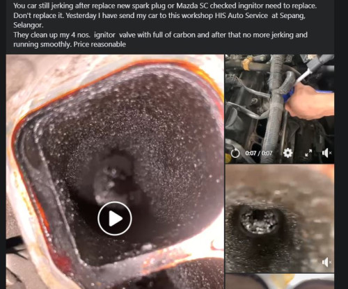

CX5. now already 400k
Nice ride you got there, i guess they done the walnut blasting at 70 000km due to tgdi engine, other engine i dont think we need that especially below 100 000km 🐝

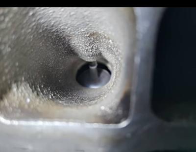

before..after 350k..cannot see anything
after blasting
GamersFamilia
post Oct 22 2025, 09:54 AM
Proud to be Malaysian
17,756 posts
Joined: Dec 2007
From: Bandar Baru Bangi , Malaysia
QUOTE(gogocan @ Oct 22 2025, 08:45 AM)
after blasting
So clean, how much it cost you? Bet feels like new again

QUOTE(gogocan @ Oct 22 2025, 09:45 AM)
after blasting
My mechanic got few CX5 & CX30 customers most after 5 years or 100k start complaining of rough idling and less power during pick up (mostly due to carbon built up in the intake).
With your picture conditions this is really too serious until cake up so many carbon, not sure either your not sensitive during low speed driving or always on highway drive only?
