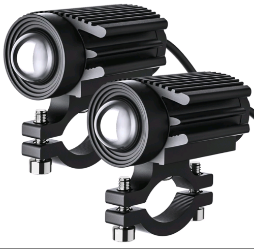

I'm using this on my Dominar past 3 years. Pretty much always on for past 60k km.
I have the single mode white lamp which is hard to find now. I would avoid the 2 colour/flashing ones because they sometimes go off sync from each other which gets annoying. You can find them on Shopee, cheap about 50 to 60 a set shipped. They are decently bright with a good heat sink but small enough to not be conspicuous. The parabolic lens have a good cutoff beam pattern so makes them easy to aim without glaring other people.

https://my.shp.ee/PSm37BL

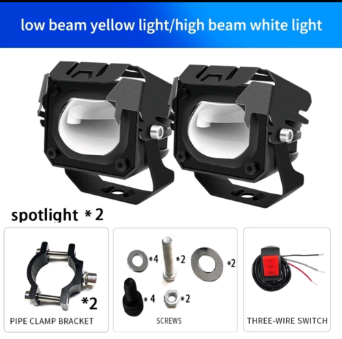

I'm using this on my NK past 2 months. 2 colour mode, no flashing (good) 3 wire design for white or yellow. I just wired both so both white and yellow is on the same time. About 60 a pair shipped. Again, the lens offer good cutoff and they are not overly bright. Fit for what I need it to do.

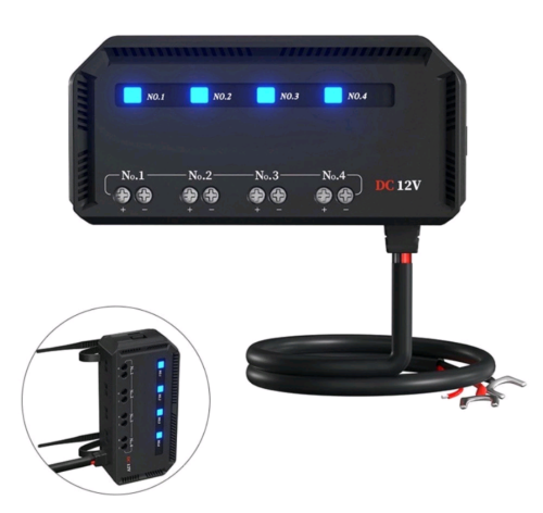

Bear in mind, these don't come with harnesses. But not an issue with me, as I did a custom harness loom (with extra feed) to a relay/fusebox
https://my.shp.ee/Mu5veMT
It's good to have. 20A max. Fuses for 4 accessories. My custom loom is wired for future upgrade like DVR or other lights and accessories.
